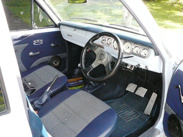

Simon- the gauges are VDO cockpit gauges, should be available from any decent performance shop.

Those door trims are the go! they must be custom.
Where did you get the steering wheel boss kit from?

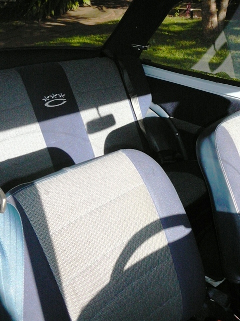

Yeah bro, whole interior is custom upholstery including seats, roof lining, door trims, carpet and boot... was all done by the previous owner(s) of the car.
Not sure where the steering wheel boss kit came from - it was in the car when I bought it. It has a Momo wheel - not sure of exact model name.
