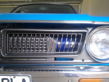

I'm pretty sure the older style grill doesn't fit with the cooler and all that, but your cooler is in a similar place, so maybe it does.
mine is 76mm thick, the fins on the grill have been cut from the grill and mounted forward in a unique method, err zippy ties, haha
you would not notice it if you got down and look at it closely
Ah, cool, good idea, better than having the cooler all in your face. my style grill has more room, but i still had to take 10mm of the back of it with a sander.
here is a pic of mine, you can't really tell unless you get down
