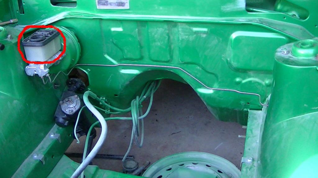

Whats with the ribbing in the firewall. Is that standard? Looks weird

Just a question with regards to your brake master (I think could be a Commodore PBR type) and reservoir is it off the KE3* or KE55. Do they bolt/mate up together as it looks better then the Commodore reservoir when fitted to a Corolla.
Yeh mate it does bolt straight up, but only on the 15/16 commodore one, if you use the 1" the ke55 reservior does not fit. Well thats what my brother found when he was trying to do the same thing.
I think the 15/16 ones are found on the earlier v6 commos (vn ish). They are pretty cheap to buy complete new, probably the best option.
Edited by oh what a nissan feeling!
And fit on the ke55 booster only.
