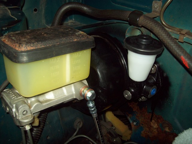

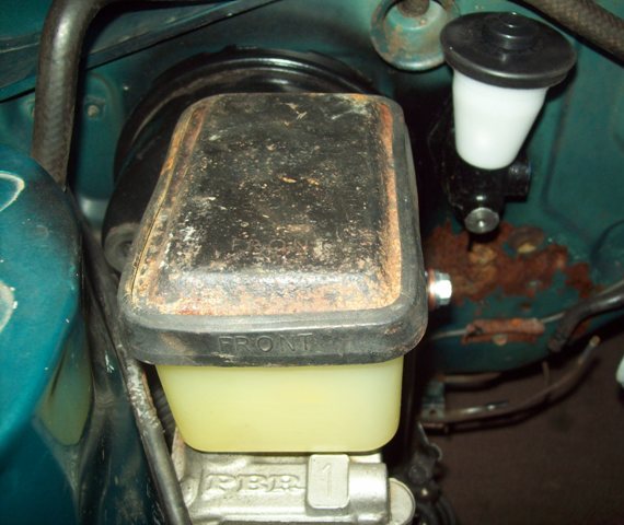

Yeh mate it does bolt straight up, but only on the 15/16 commodore one, if you use the 1" the ke55 reservior does not fit. Well thats what my brother found when he was trying to do the same thing.
And fit on the ke55 booster only.
Had a bit of a play around today with brake masters and brake reservoir’s and I found that the reservoir of my KE35 does fit onto the 1” Commodore master. So I am happy as I did not like the look of the Commodore reservoir (the angle is just wrong).
Ah cool, thats good to know, i think the master my bro was using must have been off a later model commo, maybe a vt one. I gave him a spare reseviour i had here and assured him it would fit, but the holes didnt line up, so he is stuck with the funny looking angle reserviour.
