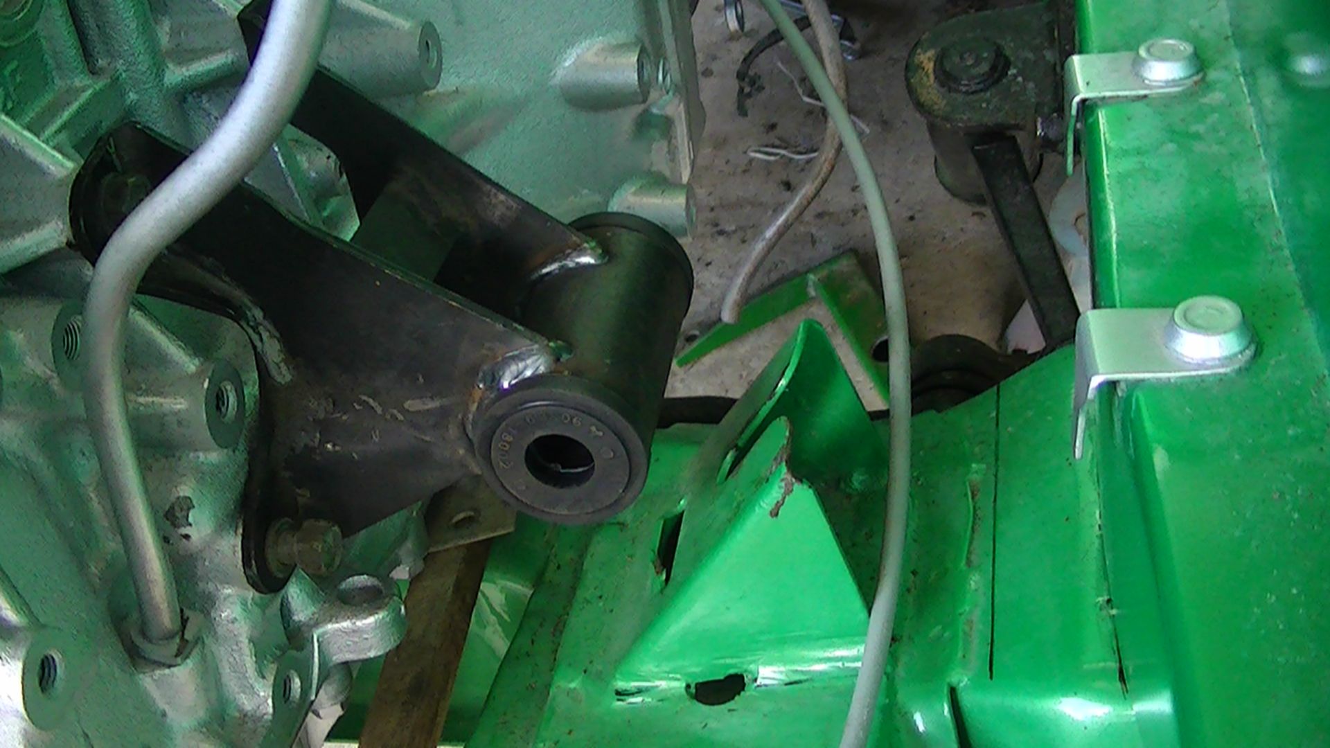

Made gearbox crossmember, Its all tacked together, needs finish weld and a good tidy up.
Also decided to re-make the engine mounts using shackle rubbers as well, the ta22 mounts would not have survived.
Way too late on this one, as i need to drop out the crossmember again, and paint it again.
still have to do the other half of the engine mounts.

With the new engine mounts are you able to reuse the KE brake reservoir?
Thanks mate! Nah still have to use the commo reserviour.
I was going to nudge the engine over 10mm but the rear of the tunnel didnt have the room on that side, so the engine would have sat on a slight angle.
Rear mount is way overkill in the steel thickness, shops werent open that day.
