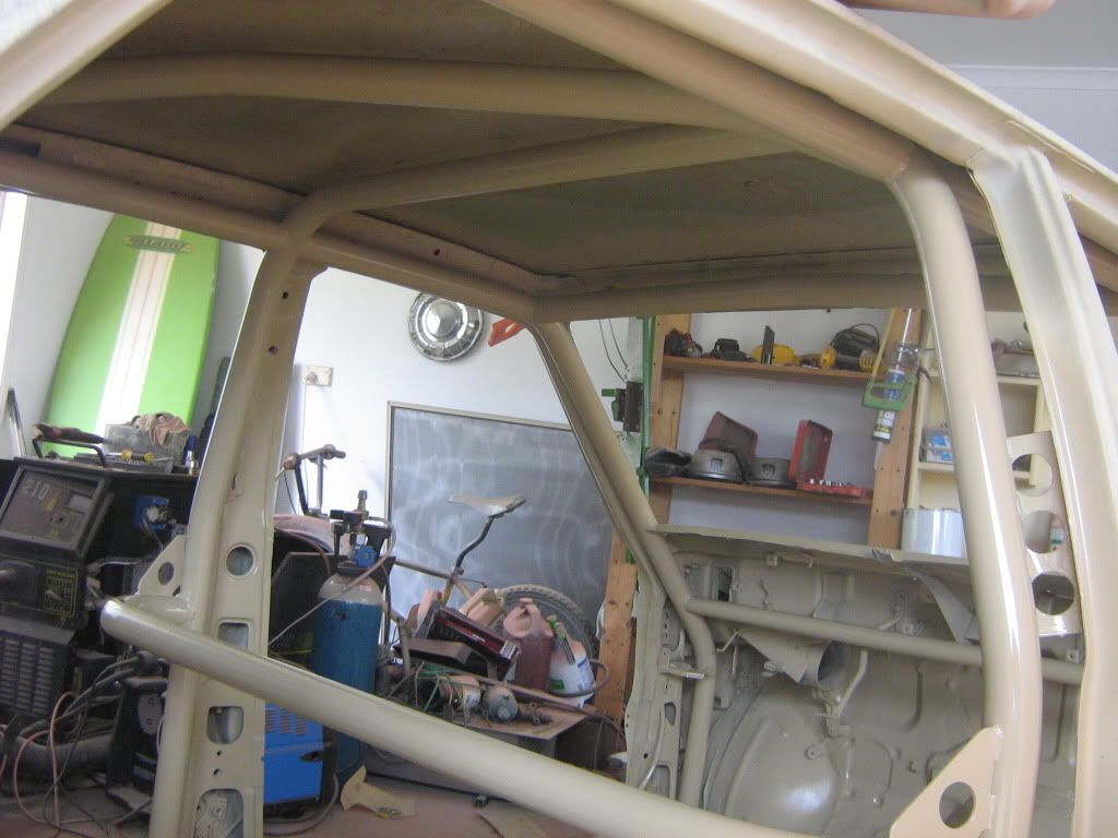

cage painted the new interior colour.

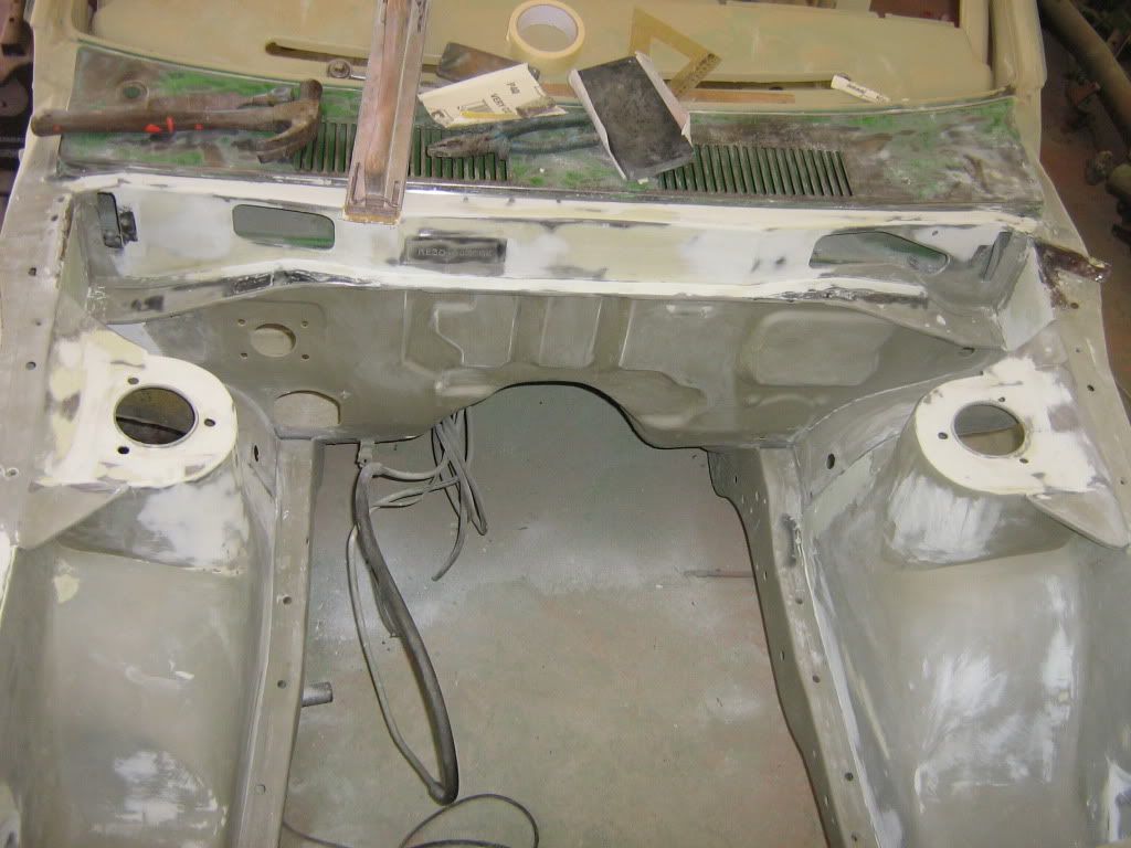

anyways spent 14 hours on the engine bay of the rola over the labour weekend, not much to look at but lets just say its pretty straight and all in etch.
doesnt look like much, but if i had a shot of a factory engine bay the differences are there, and many.

hey can you pm me some details on cage specifiactions etc etc.
Looking awesome dude, gonna be a serious bit of gear when you're done. You going caltracs for the back end? I have a new found respect for leafs and drag racing with what OKE20 has achieved, didn't think 8 second passes were possible on a leaf rear end :blinks:
mmmm paint, i may be a bit optimistic, but i hope to be spraying green within 3 weeks.
No worries man. Would you like the specs of my cage, or a scan of the andra rulebook rollcage section?

the andra book would be good.
also a bit on your cage in specifics. e.g. costs, materials. etc.

Have done a fair bit more to the engine bay, is in undercoat now, will be ready for topcoat soon i hope, not much to look at though.

got some runs on this roll cage bar last time, so repainted it too.
