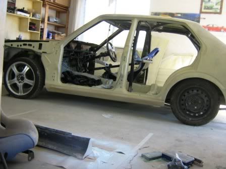

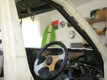

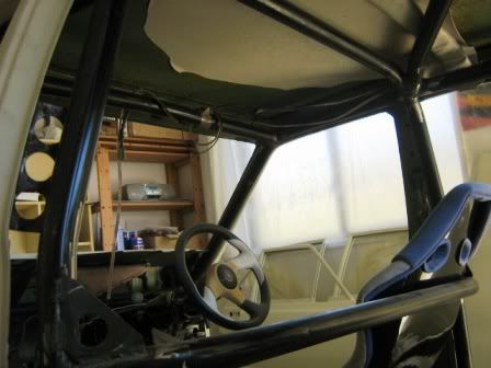

Ok, car is getting the cage built as we speak,
6 point basic andra cage with removable side intrusion bar. + i added 2 extra bars.
It is all mild steel, as chro-moly is not street legal :y:
I think i need more power to tow the damn cage!!!
Organizing my log book and andra licence now so i can get approvals.

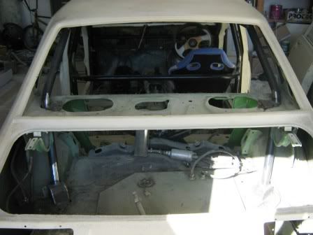

:wink: got my cage approved by andra inspector,
just need my seat belt mounts done, and tailshaft loop to get it signed off.
a few pics:

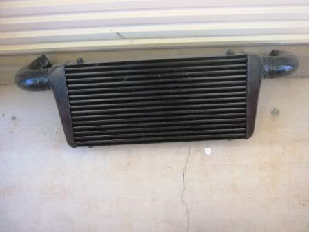

and painted the cooler so it hides behind the grill a bit better.

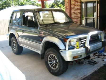

been a bit busy getting the shorty pejero i just bought going.
I bought it with bhg and have got the heads fully redone and have reassembled it.
It failed rwc on the cv boots, so i am doing those today.

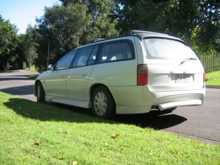

I have also been getting the commo ready to sell, painting and fitting a bodykit i got for free.

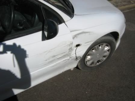

Only problem is someone crashed into me on monday!

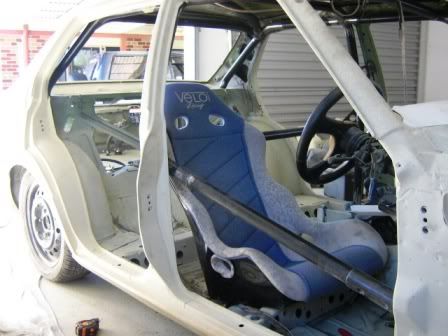

Next task for the rolla is fitting the front seats, and the battery cut off on the rear of the car :yes:

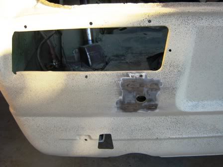

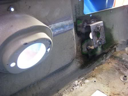

i drilled the battery cut off switch into the rear of my car, and created and welded a bracket in.
Also drilled a hole for a boot lock into the rear, it has already been deleted on the bootlid,
but ANDRA rules says i have to put one in. So i put it in the ke25 position instead.

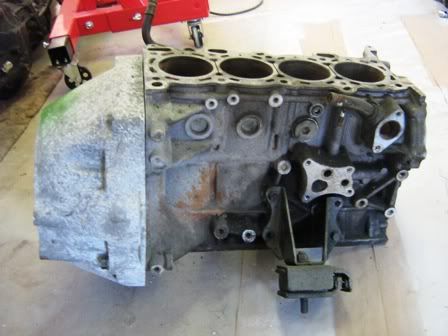

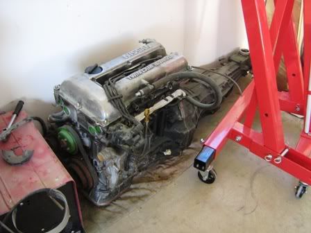

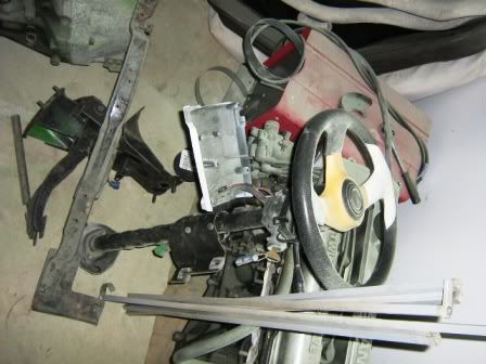

Pulled the engine out to start on the engine bay, this one will not be going back in as i plan to have the new one built in time.

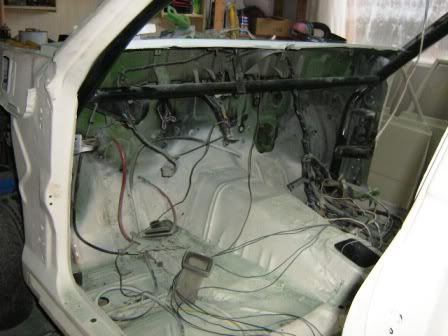

Removed the manual pedal box, column, and any other junk in my way.

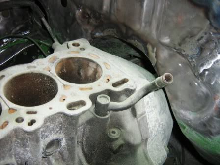

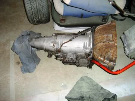

The sr20 auto bellhousing requires a heap more clearance than the manual one, so i had to dummy it up to see what neeeds to move out of the way, i grabbed an old block and mounted it up.
There will be changes made to the front of the tunnel.
The C4 i will be using is a very small box, so only the nissan bellhousing has clearance issues.

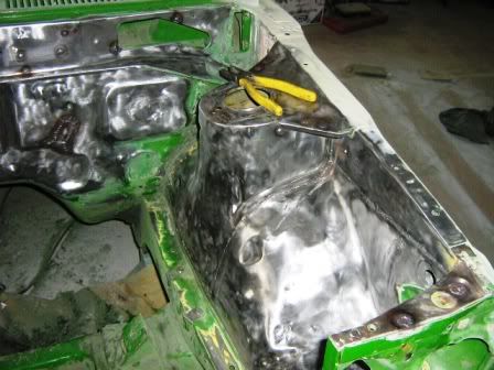

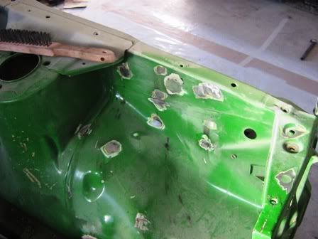

Started welding up some of the holes i don't need,
Then started to really get into it, i am thinking about straightening the sheetmetal over the wheels on either side to make it really smooth.

looks like a 6cyl c4 if so don't throw out the standard bellhousing put it on ebay i just sold one for $54 plus $33 freight they are starting to get hard to get for the ford boys, because most of them are in my shed haha.
Thanks heaps for the comments guys, I'm trying to keep the detail up there mick, not doing underneath,
but trying to be real fussy with the rest. I just hope my patience continues.
corty man, Yep youre right about the bellhousing it is for a 6, i might have to chuck it on ebay then i recon.

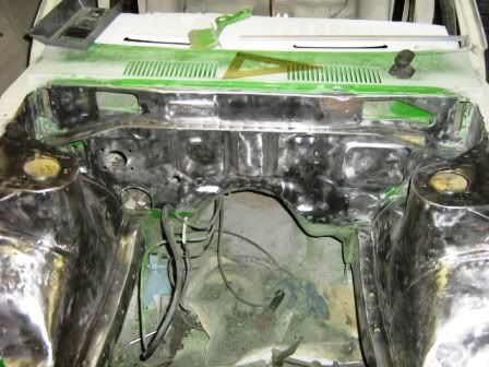

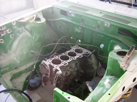

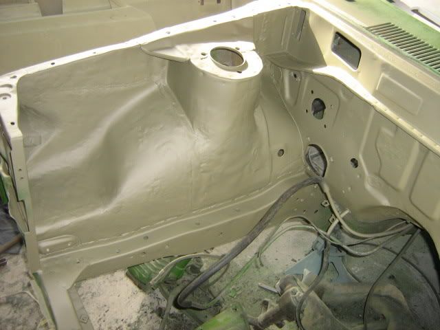

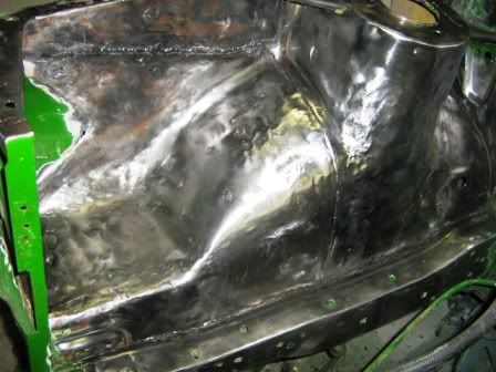

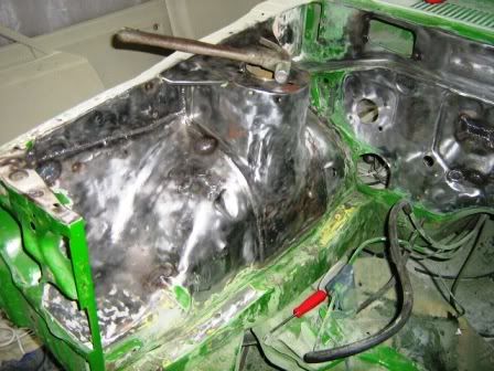

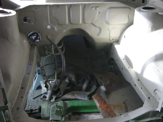

Engine bay has had lots of attention, lots smoother, many many man hours.
a bit of surface rust starting..

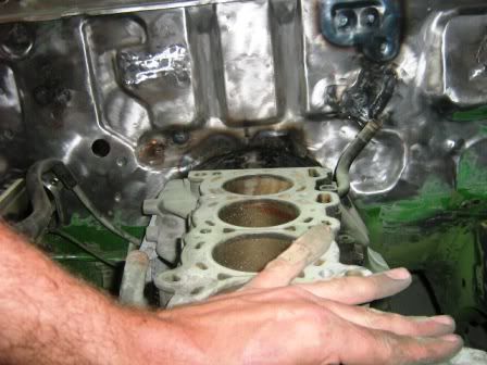

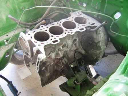

New tunnel clearance for the auto bellhousing, bolted the crossmember back up, put dummy block in,
real happy!

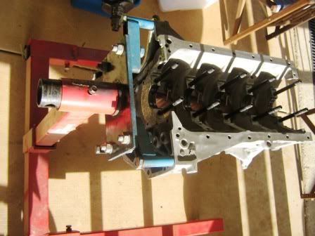

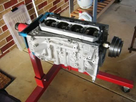

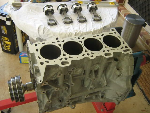

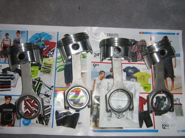

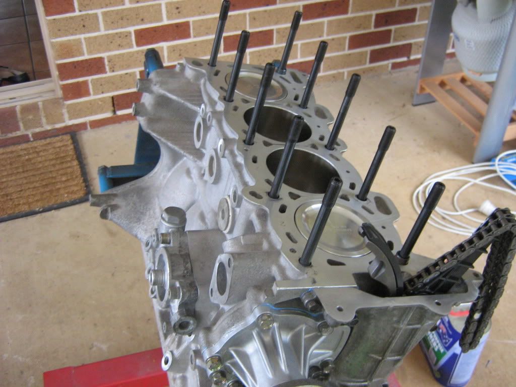

Started to build the new engine, waiting for a few parts atm, forgot to order big end bearings dammit.

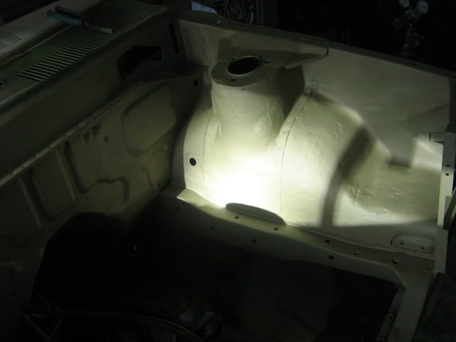

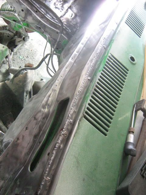

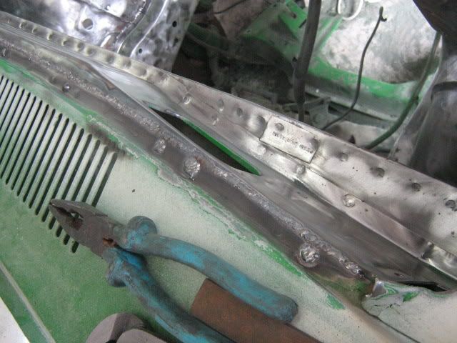

Been on holidays and stuff, pretty unmotivated atm. Have been working at getting the engine bay really really tidy looking.

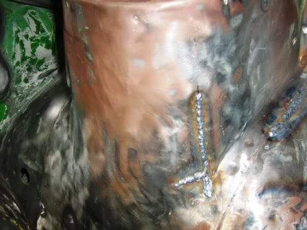

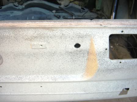

welded up seam along top of firewall.
Etch primer
