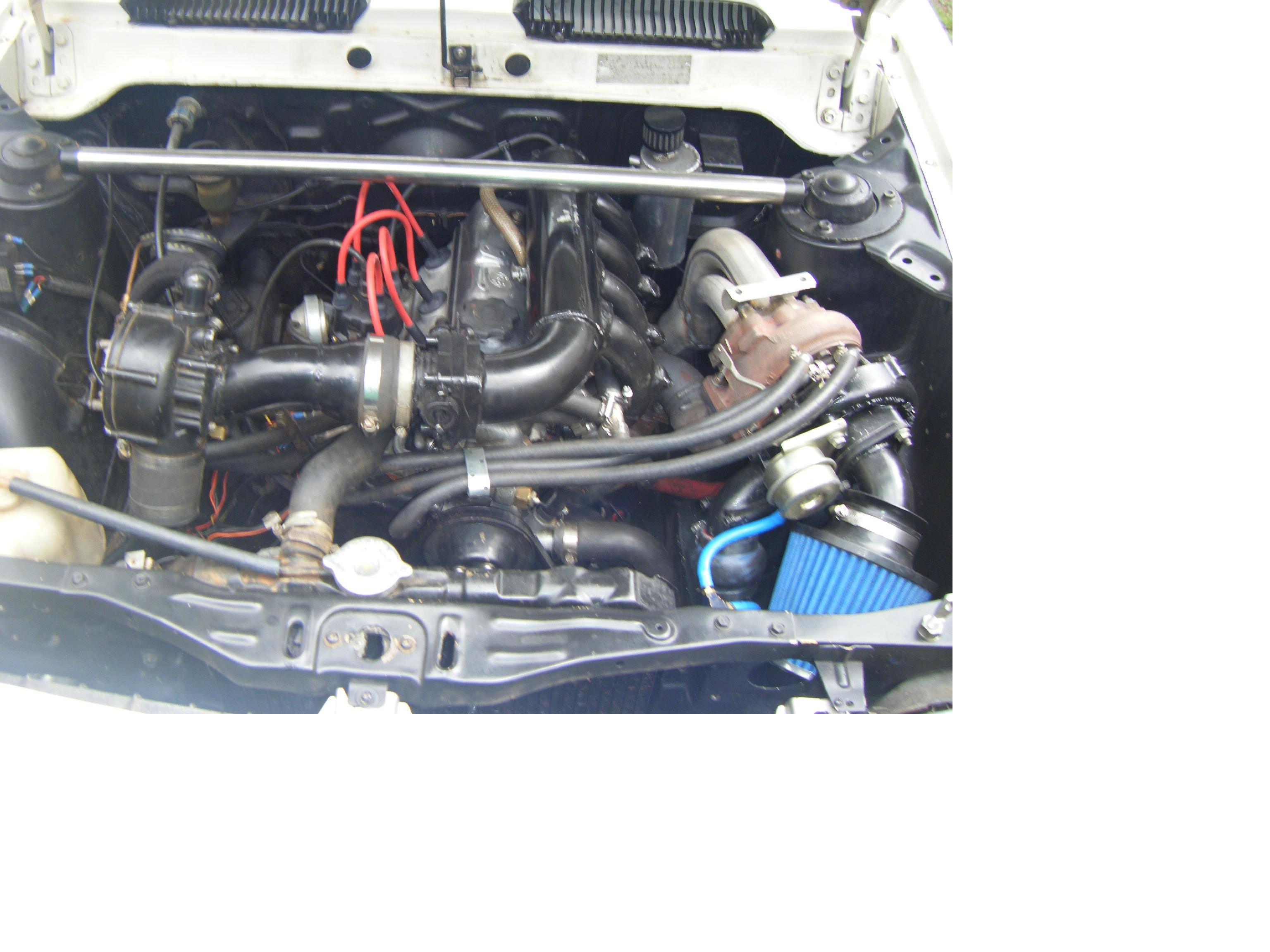

The time has finally come, my lil rolla now has a snail hangin off the side and is running straight gas (because I'm a tight arse) and goes pretty damn well but not without its fair share of problems. i have pics if someone is willing to host them cheers.
email them to me and I'll host them, send me a PM for email address.
OR do you know you can upload pics here?
Just use the attachments box at the bottom when making a reply. :yes:
