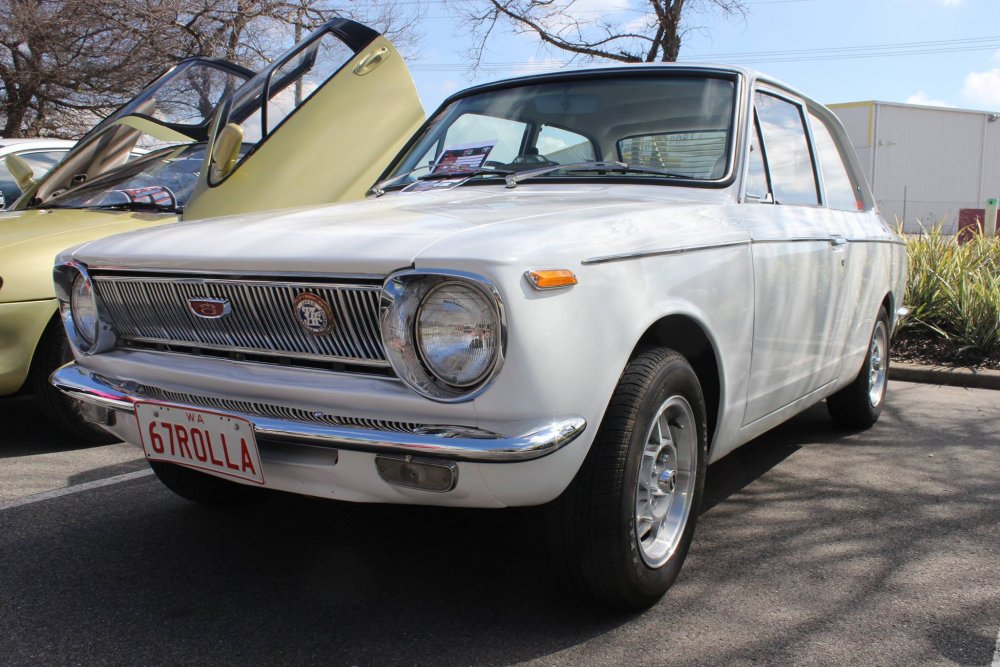

I took her out to Toyota WA's show and shine on the weekend... and managed to take best in show!!
It's not a journey that ever ends but it's getting there :)
