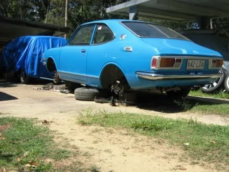

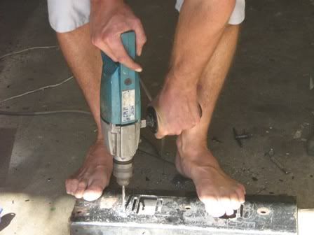

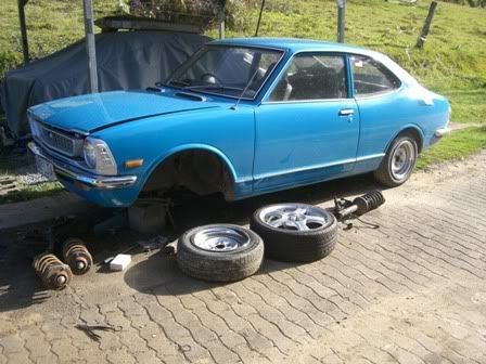

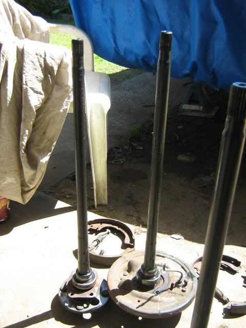

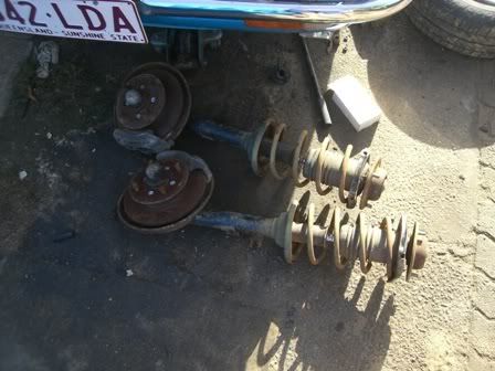

Heres some of the pics from my stud pattern change to 114, so both my cars can share wheels.
Thanks heaps for your help, redwarf rob, matt, and duggy. :y:

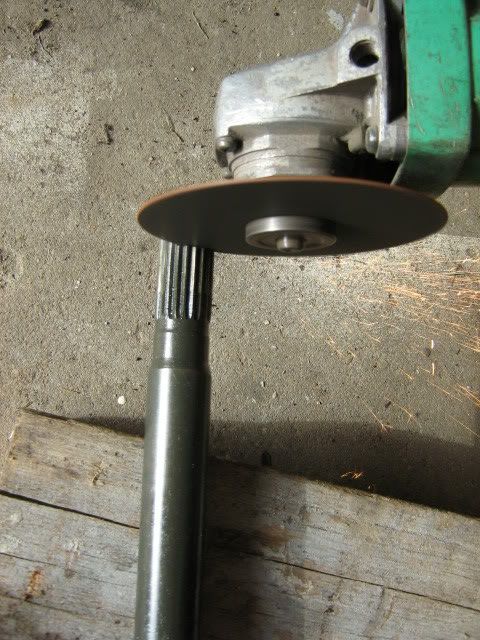

ke25 and ke30 axels
chop a bit off
Its all finished now but the camera is flat, just have to bleed the brakes. :hmm:

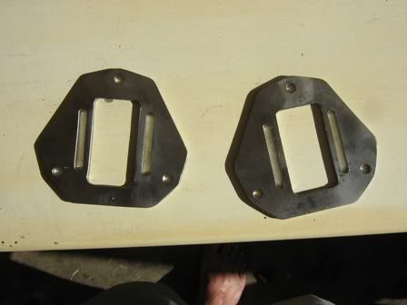

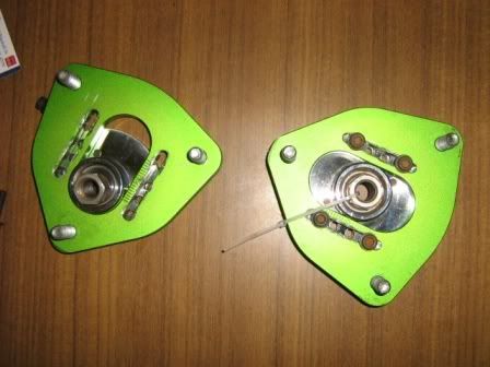

I also corrected the front end camber problem last weekend.

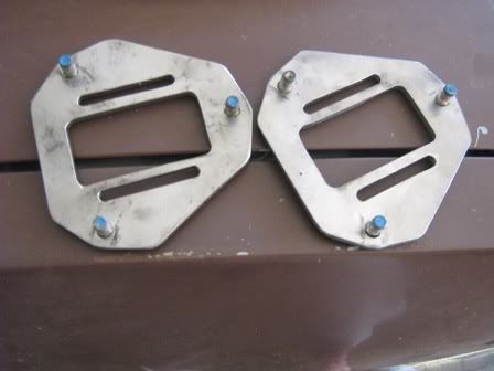

I got these off here, s13 strut tops.
As expected, there is a fair bit of slotting involved to fit them,

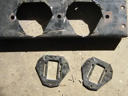

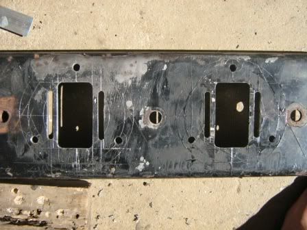

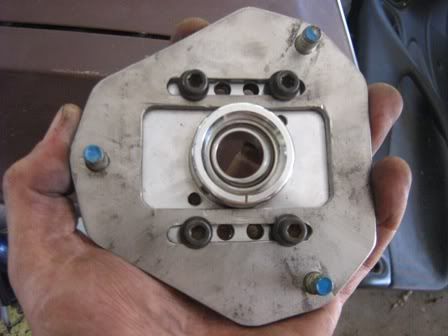

so instead i opted to make some new top plates for them, so they fit the car perfectly.
I used 6mm steel, out of an old chassis rail i found out the back.
All done, i painted them blue, and they are now in the car and work a treat :hmm:

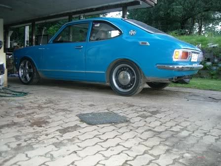

Yep, fully licenced and driving like an angel :)
Great to meet all the rollaclub crew today, my memory sucks, but good to see you all! :)
The wheels i had on my car today are simply too wide to lower it,
so i will have to decide on some for the future, the sigma wheels are going on for now.

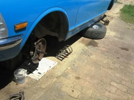

:P time for updates,
well, not good.
On friday on my way home from work at noosa,
i pulled onto the highway and tried to accelerate and the old girl wouldnt do it,
in fact, it slowed down instead, so i pulled over and she stalled,
opening the bonnet it was pretty clear what was wrong! i cooked it :P (i now recommend working temp gauges)
so she now suffers from a bhg, with compression escaping into the water. :(
So after hiring a trailer to get it home, i sit there remembering how many issues this car has had over the past few months,
in fact I'm pretty sure i work on it every arvo!!!
