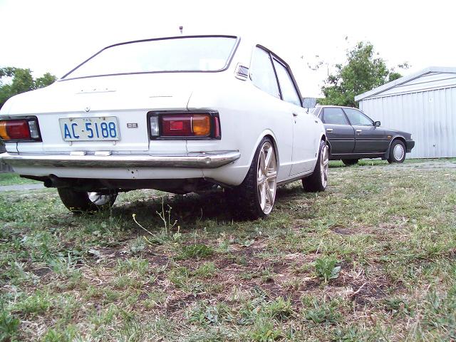

hey guys.. i have a 1973 ke20 i am just about to do a 4-age conversion. i wanted to paint the car the blue that is the colour of the wrx.. it is white at the moment..what do you guys think paint blue or leave white? my dad is trying to talk me out of changing color as i am a 1st year apprentice and a bit of work is needed and also i will be getting rid of the 17's and putting skyline chasers on it as i will be using corona struts and brakes. tell me what yous think cheers
white ke20s with chasers look mad. i'd leave painting it until you have it running and engineered at least.

Depending on what the condition of the body and paint is, i would leave it white. Judging on what i can see in the photo's it looks like a pretty clean ke20. Stripping it down to a shell and respaying is a lot of work and takes a long time. Also depends if your planning a close door respray or full strip down...i reckon go with the original look...

thanks guys.. the body work is pretty straight.. it will still need a fresh coat of white but still that is a lot easier that stripping the whole car to paint blue..i willl be using the car as a daily driver for now.. thanks guys
