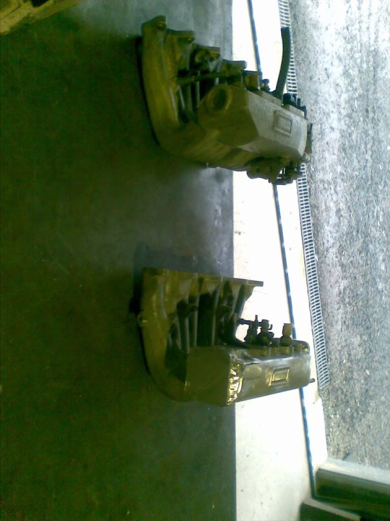

Did this today for Mr AE71 AKA Justin.
"cut and shut bigport manifold"
Now I did not "cut" the manifold I instead plated it, I find this a much nicer way than welding shitty 26yr oldish cast aluminium to more shitty 26yr old cut off cast aluminium,
It makes for a much better weld and less distortion/crap.
Designed for the normal bigport throttle.
Anyway pics:
What i started off with, one rwd manifold and one fwd manifold:
And what I ended up with, two rwd manifolds:
Opinions?
Cheers
Travis
Edited by trav_555
Thanks man, much appreciated, 5 hours, lots of gas, lots of filler wire and patience, and material.
I think it all payed off in the end.
