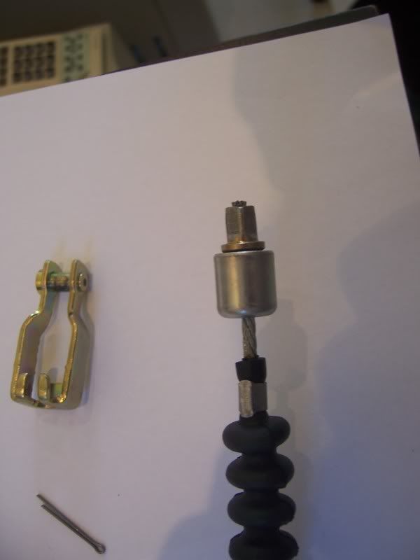

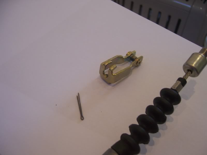

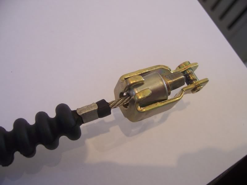

anastasios Posted November 25, 2009 Author Report Posted November 25, 2009 (edited) Ok the sump plug issue is sorted, it turns out i have a Spacia sump with a 12mm sump plug, I picked up the clevis for the clutch cable but I'm not sure how the split pin holds it to the cable? Anyone with a KE70 done this before? Edited November 25, 2009 by anastasios Quote
Taz_Rx Posted November 25, 2009 Report Posted November 25, 2009 No idea where the split pin is supposed to go. I honestly don't think its needed anyway, the tension on the clutch cable will hold the clip on so just assemble it as per pic 2 (once cable is through the bellhousing) and hook it on the fork. Quote
