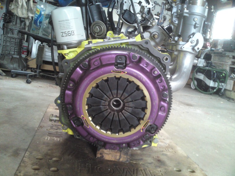

October 6, 201016 yr Author comment_473806 I picked up the motor this arvo. I want to upgrade the cooling system as it was always a bit marginal, especially on warmer days. Still deciding on either PWR or A.R.E for a radiator. Probably PWR and a 3000CFM 16" SPAL Fan for ease of ordering and you never hear anything bad about them. Looks like the strut brace is going into storage too as I think it will foul on the IDA. I'm in the middle of house hunting, so that has priority of my time at the moment. As long as its running before Summer, i'm happy. Edited October 6, 201016 yr by kangaroosa Report

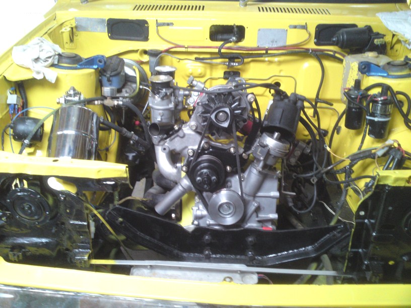

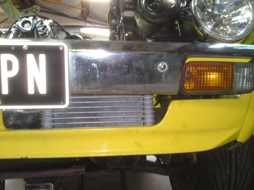

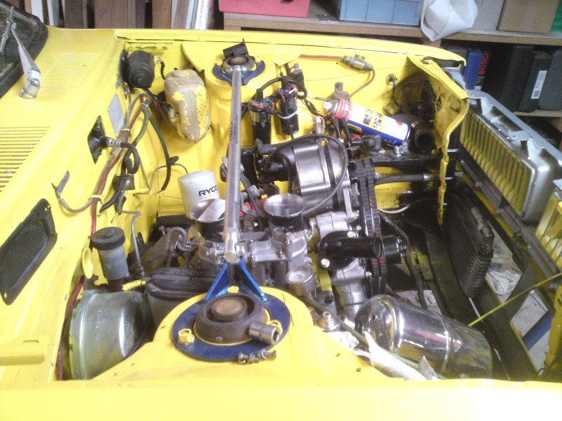

October 16, 201016 yr Author comment_476021 I found some motivation today and fitted the new motor. I also relocated the PWR oil cooler. I have a PWR 55mm Core Radiator on order, so the engine wont be started until that arrives. I am waiting for the new batch of Short shifters and gear knobs to be machined up. I'll throw one of those in when they are ready. I also wouldnt mind ordering some new carpet for the front as i have a hole where the old shifter location was. Anyone know if you can still buy genuine heater tap pipes for a KE30. Mines a little leaky, and I have had the heater bypassed. Last time I drove in the rain the car fogged up in minutes and was a real pain in the butt. Tommorrows work includes: - Fit Tailshaft and fill up gearbox - Fit bonnet and grill - Wire up the engine - Bolt in the Oil Cooler Anyway heres some pics from today. Report

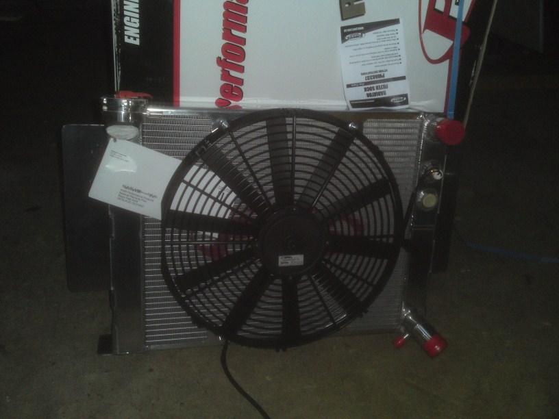

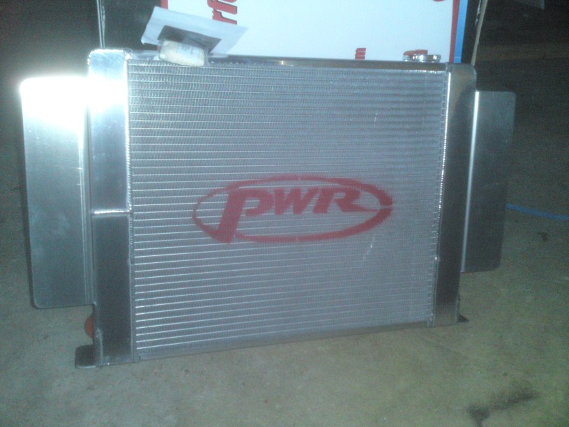

October 29, 201016 yr Author comment_479017 nah i wouldnt sell it mate, Good to hear. Yay for a 4 day weekend!!! My new Radiator turned up during the week....picking up my new K&N Air filter tommmorrow. I ran out of time trying to pick one up cheap so i went to repco this arvo after work. They quoted me $230...i said "nah don't worry about it, i can get it for $165", so then he spent an eternity bashing keys on the keyboard and finally sold it to me for $160.....really makes it clear it pays to shop around....or atleast bullshit a bit :P Still have to work out the sensor in the radiator thats supposed to turn on the fan. Then I have to grab some angle and weld up a new accelerator cable bracket. After i help the younger bro move that is. Anyway heres the latest pics. Report
October 30, 201016 yr comment_479098 If its just a 2 pin plug in the rad then its probably just a pass-through style temp switch. Relayed power on one side, power to rad off the other. :wink: Oh and what K&N did you get 3.5" or 4.5"? I got a 4.5 for the mazda and couldn't close the bloody bonnet! :lolcry: Report
