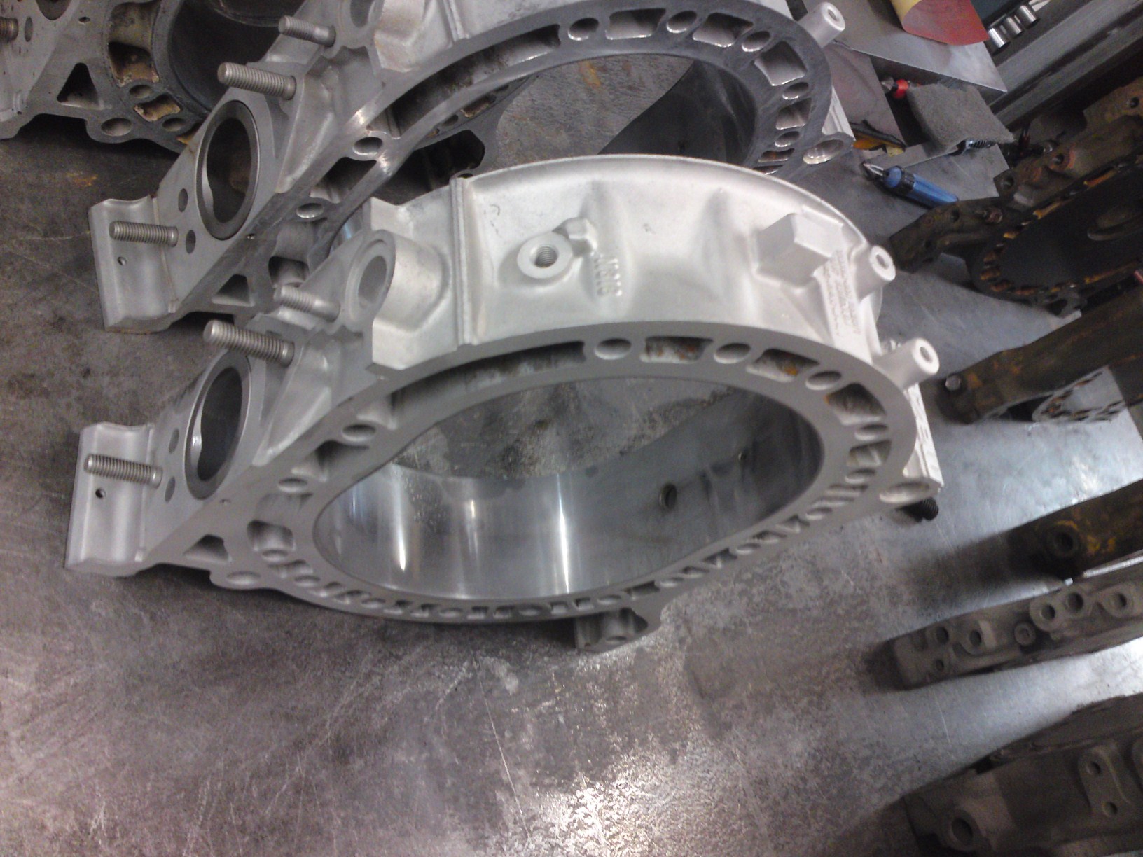

Machined down 13b housings

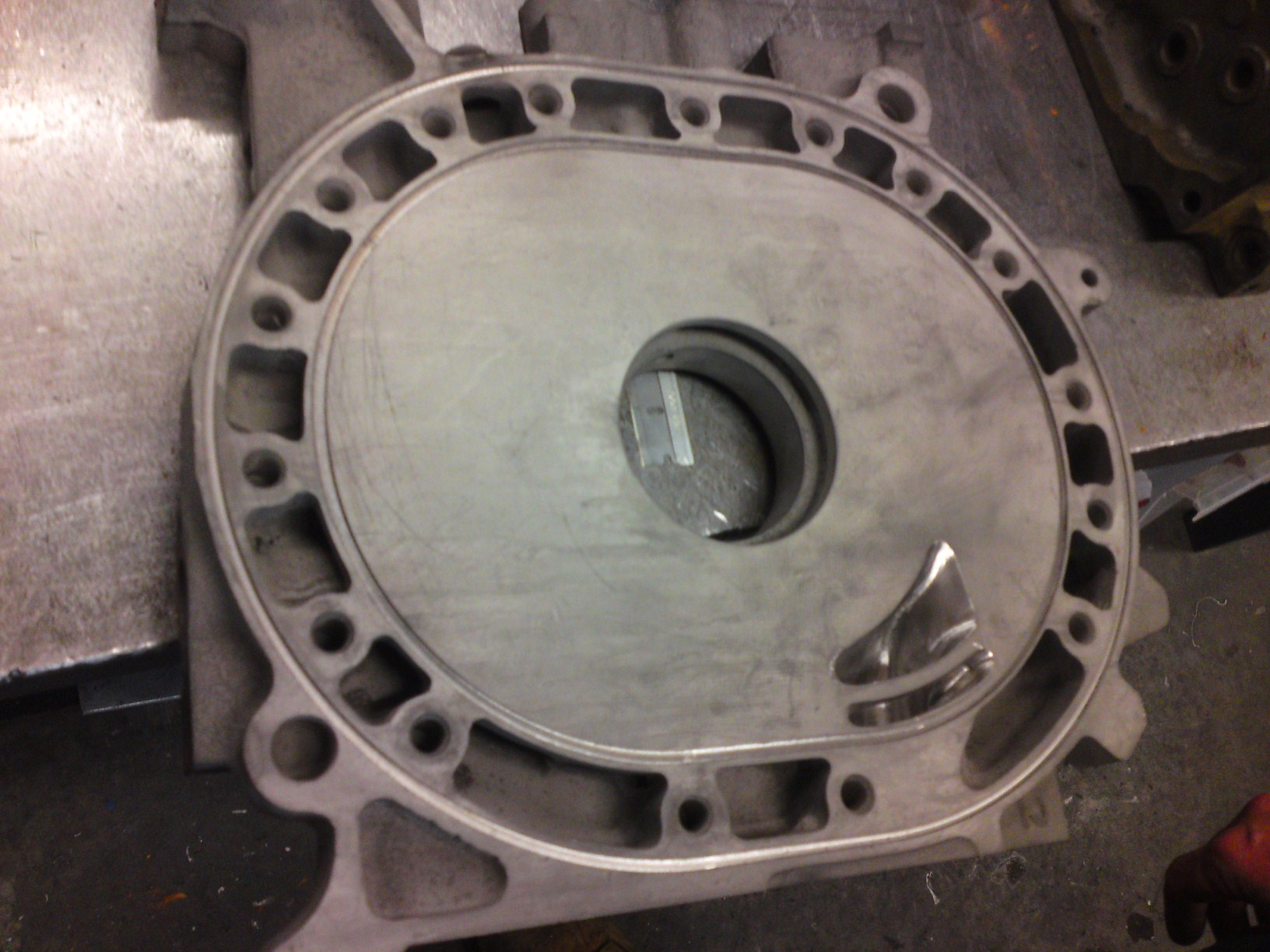

S3 End plates - Bridgeported - They came back from being heat treated earlier in the week.

Machined down 13B Housings - They have an oil coating on them so thats why its a bit patchy and dull.
Bridge Ported Plates - Yet to be lapped.
