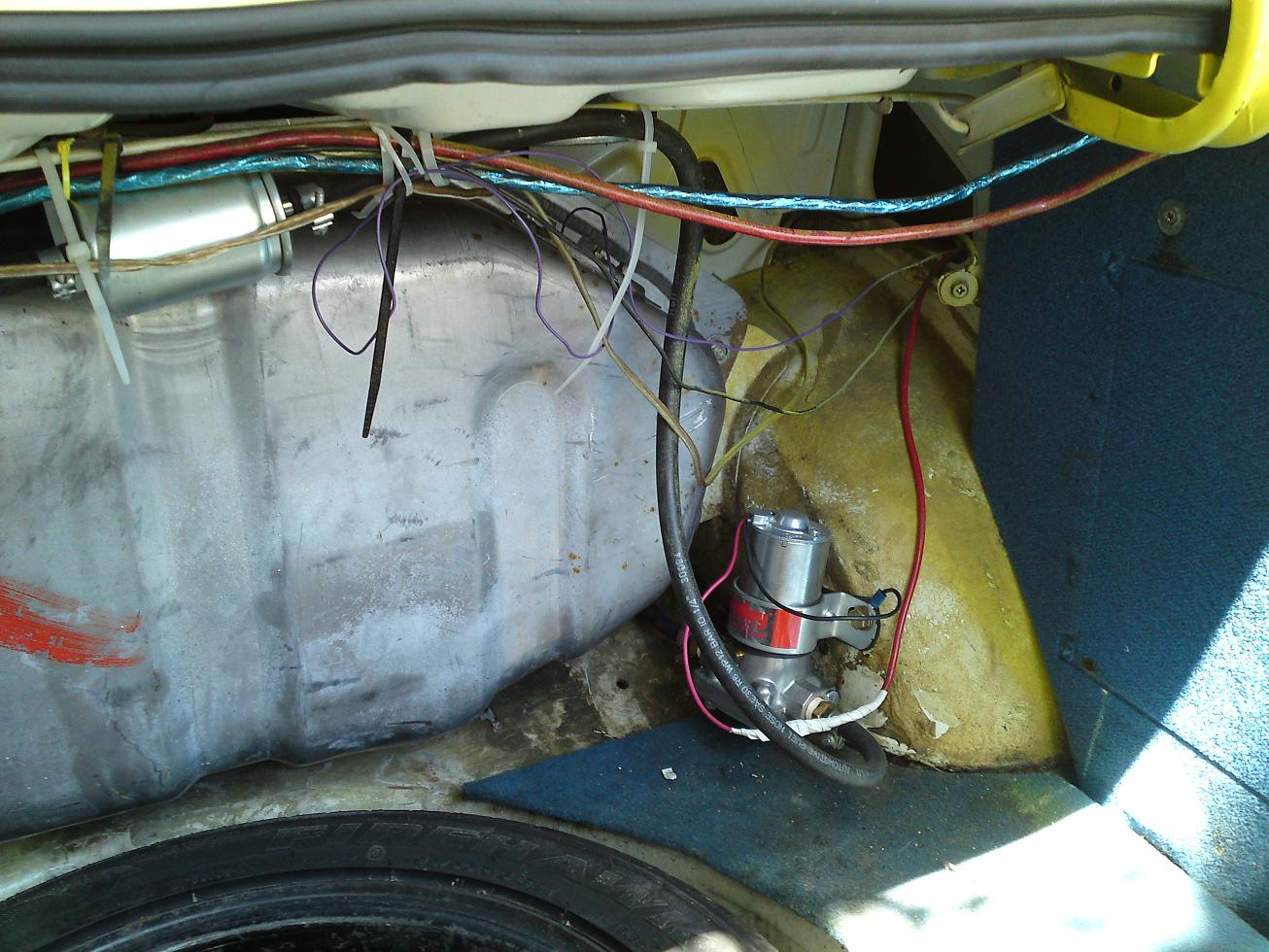

can i please see some picks of how you mounted and were the fuel pump champ
  • Replies 227
  • Views 189.4k
Its just bolted to the wheel well with the supplied soft mount. Earth straight to the mounting. The Ign Wire come from the pump relay in the engine bay.
The fuel line plugs straight onto the top of the fuel tank where the existing line was. From there it goes into an efi fuel filter and then into the pump Then the outlet off the pump goes behind the tank and through the floor where the existing line goes. Its then just hose clamped on the metal line that runs under the car.

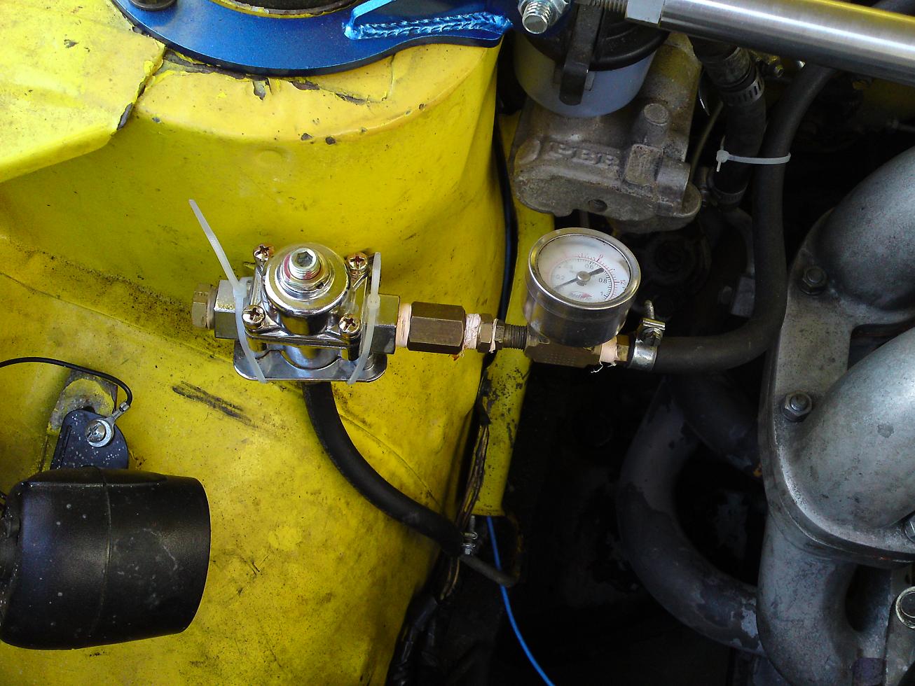

In the engine bay, I have a Holley Red regulator and inline pressure gauge.

*EDIT* Pics just uploaded

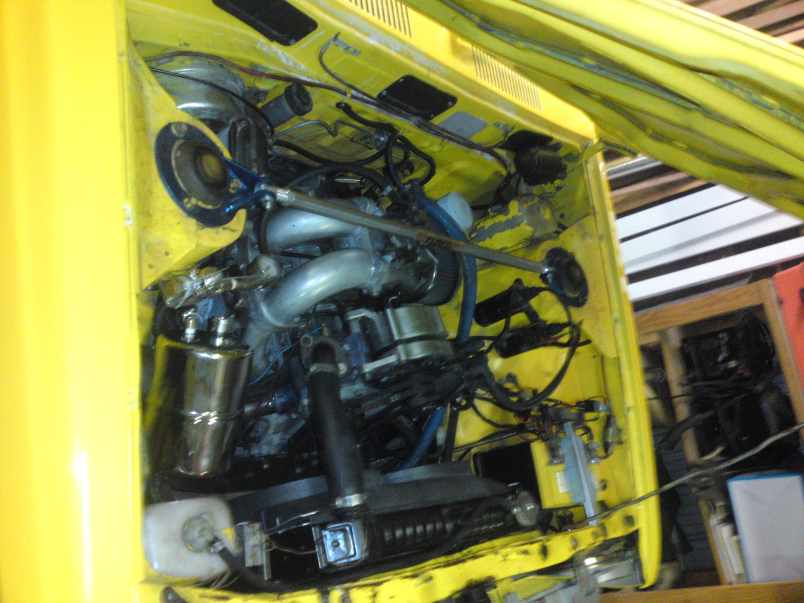

Dfunkt and I were lucky enough to be able to drop in on Roosa today and go for a spin round the block, car looks great, sounds great, pulls up pretty nicely (although not how it used to were told :jamie: ) and considering it's basically a stock 12A it screams along really well!
Really great job mate, especially when it was done at home! Brilliant!

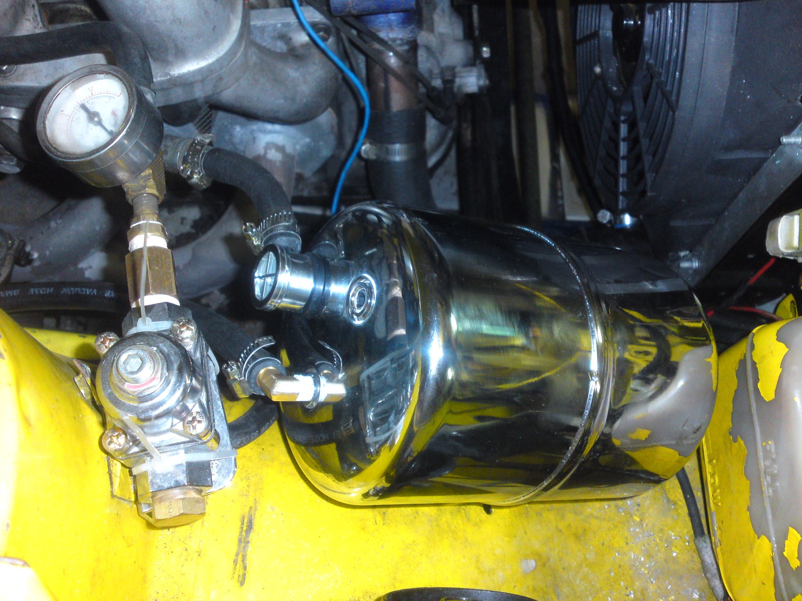

he said that the rota should be fine for brake vacuum
do you have pics of were u have your brake hose i would like to see incase you may need to put it in a different place
You can see it in the pic above of the regulator. Its bolted to the intake manifold....same place as standard.
I grabbed a vacuum canister on friday, but am yet to plumb it up. I have to move the alarm siren and i've got a severe case of the coombies.

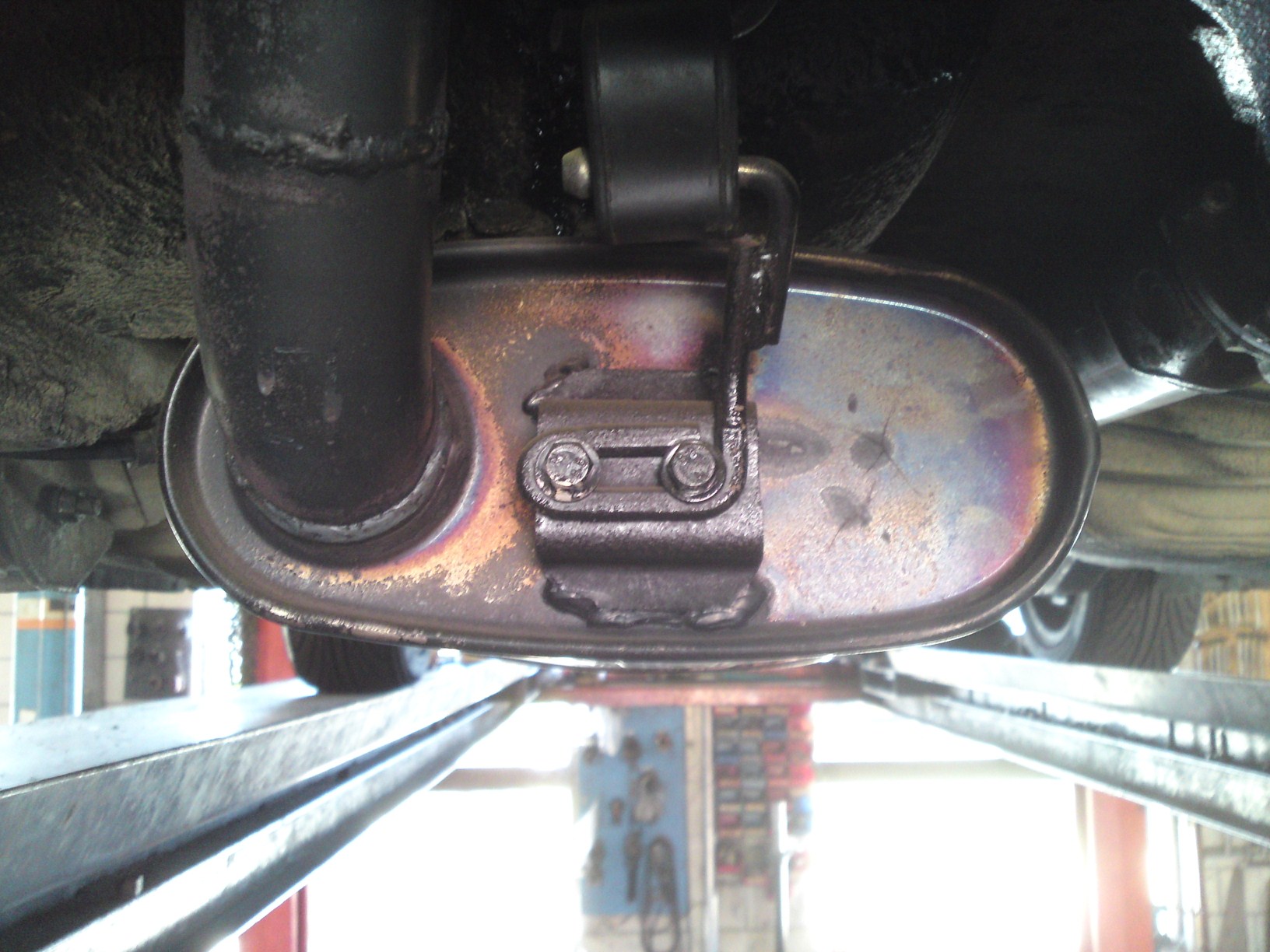

The exhaust from the extractors to the diff is how it went through engineering. Its starting to make horrible noises and is showing signs of how hot these exhausts really get. The big muffler i have to quieten it down, is all heat stressed and starting to crack.
So the cars booked in Tuesday to have a new system put on it.
From the extractors, it will continue as twin 2" Pipes. Under the gearbox and then into a 2" Rotaflo RFR200 resonator on each pipe. Then into a 2.5" coupler before the diff and 2.5" over the diff. Finally the rear 2.5" Rotaflo RF250 muffler will be staying with the droop tip. Hopefully will still be quiet, whilst letting it breath alot better....and most importantly the rattles and vibrations of the collapsing muffler will be gone.
Jesus! some heat discoloration!
Spot the cracks on the rhs?
