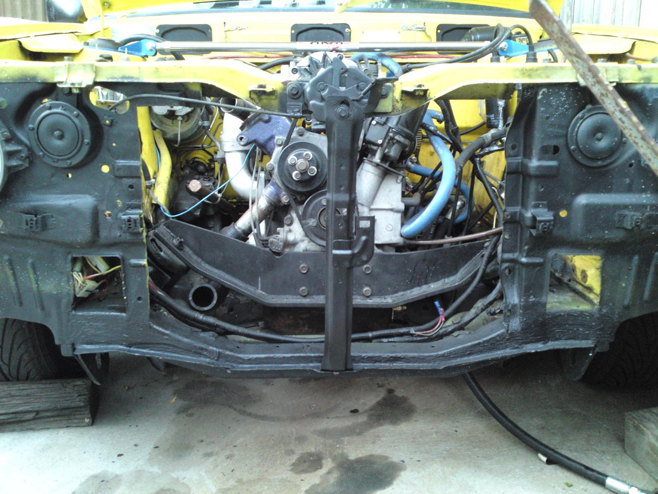

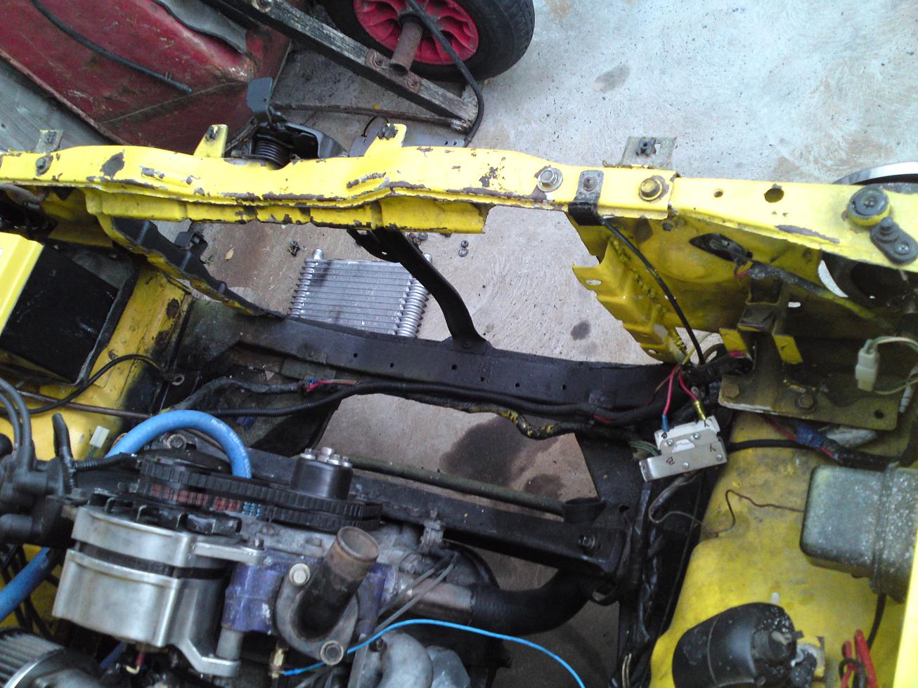

I've had issues with incorrect reading gauges so i've replaced them, and took to the radiator support panel this arvo to allow better airflow to the radiator as the temps are fine at idle, but they spiked a bit when at speed. About 80mm of the radiator was covered which probably wasnt helping the cause.

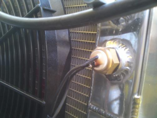

I spoke to PWR today about getting a radiator. I just have to sketch up how i want the outlets on the RX7 Radiator, but unfortunately production has stopped for the year and wont be starting until Jan 5th. So if the S1 rad doesnt cope over summer, I'll be treating myself to a PWR unit with a 16" SPAL fan.
I picked a VL radiator on the weekend with the plan to install it in place of the RX7 rad. Got it home and pressure tested it. 1st one had a leaky end tank. So i took it back and exchanged it. This one had a leaky core....it looked brand new. The rest of the rads were either munted or had thinner cores. So I tore that money up.
Went to another wrecker and got another brand new looking radiator. It leaked as well.....not happy. So that one ended up being thrown at the fence to make sure it was really finished. :y: No i'm not seeing anyone for my anger issues. I gave up on the dirty old holden pieces of shite.
S1 RX7 Radiator is going back to the shop tommorrow to get the outlet welded back in and for them to take a tank off and rod out the tubes so I know that its in the best shape it can be for Summer.
I've also picked up some Redline water wetter. Alot of rally and circuit rotary drivers swear by it. Apparently it doesnt contain glycol, so the race cars use it due to it not leaving an oily residue. Its supposed to crap all over regular coolant so I'm giving it a go.
Slightly larger opening.
I just cut and relocated the mounting. Welded in place. Don't zoom too close on the welds please.

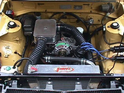

PWR's are good, but also soooo bloody expensive. I recently got one these ASI rads for mine...
http://cgi.ebay.com.au/RACE-alloy-radiator...=item45ef7afb37
They're still a quality product, tripple core and 4 pass. I haven't done a whole lot of driving on mine yet but haven't had any issue at all. Just some food for thought as they're about a 3rd of the price of a PWR.

Whilst wiring up the Stewart Warner gauges I discovered that for some strange reason i had the speco gauge wired into the plug for the back of the standard gauge cluster....which then goes into the engine bay for the stock sender. I have done away with that, and run a new wire like the rest of the gauges have already. That could be part of the reason for a dud reading.

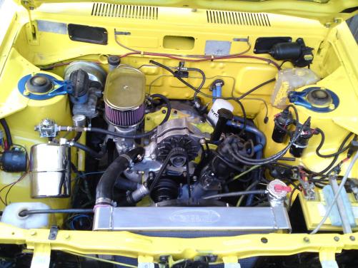

It was pretty easy to fit with 1 excepting - The hieght of the cap!!! If you sat the ASI in ontop of the oil cooler the top of the rad sat pretty much at the same hieght as the original, but the cap sat up an extra 30mm or so, causing it to foul the bonnet. Got around this by basically V-mounting the oil cooler to drop the rad down a bit further. I plan to mod my stone tray a bit to make room for this so I can straighten it back up, but I might wait a bit and get an ASI alloy oil cooler before doing this.
I might have to take you a pic or 2 of my engine bay. :y:
What engine mounts have you used, i have just bought ford escort s2 uits 70mm wide by 53mm high with 10mm stud in centre either side.
New S1 RX7 Mounts. Circular Type.
