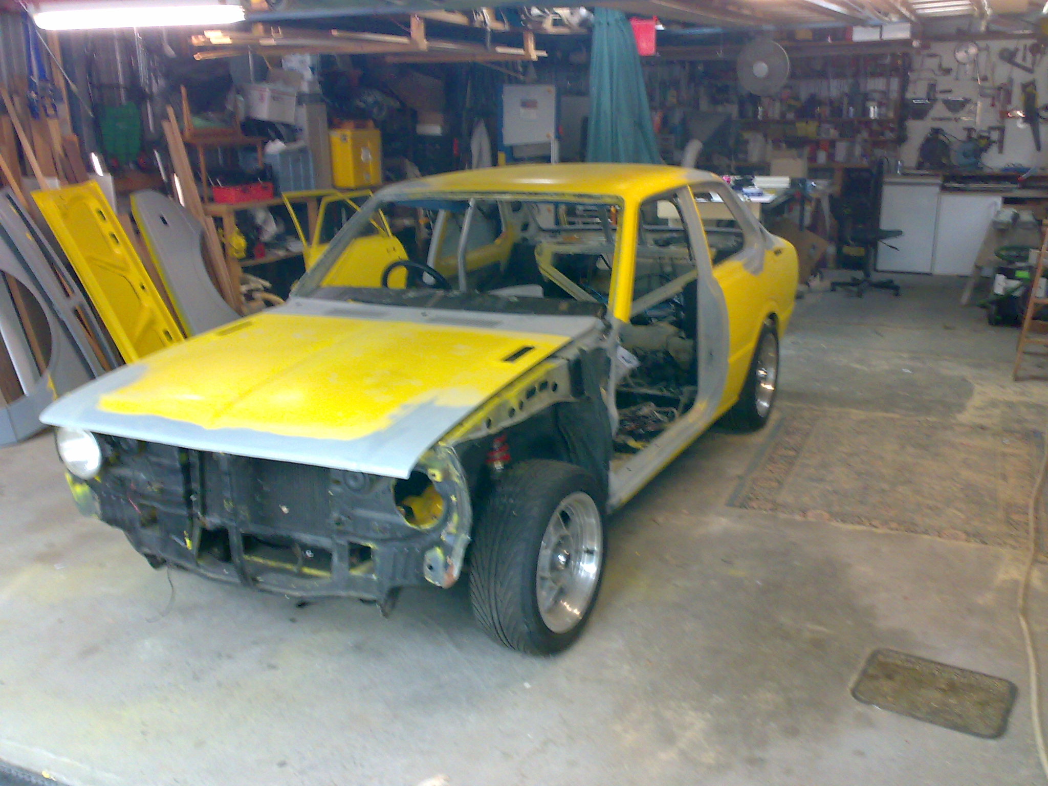

Then winter rolled on and I really couldnt be bothered with the car. I had brief patches of motivation during that time where I tackled the bodywork and set about cutting out all the rust and welding in new sections.
I had an R31 diff shortened, rebuilt and fitted. I eventually found a workshop that charged $3K to mount the Motor, Gearbox, Custom Tailshaft, Custom Extractors and a few other small fabrication jobs that I preferred a qualified welder to tackle.

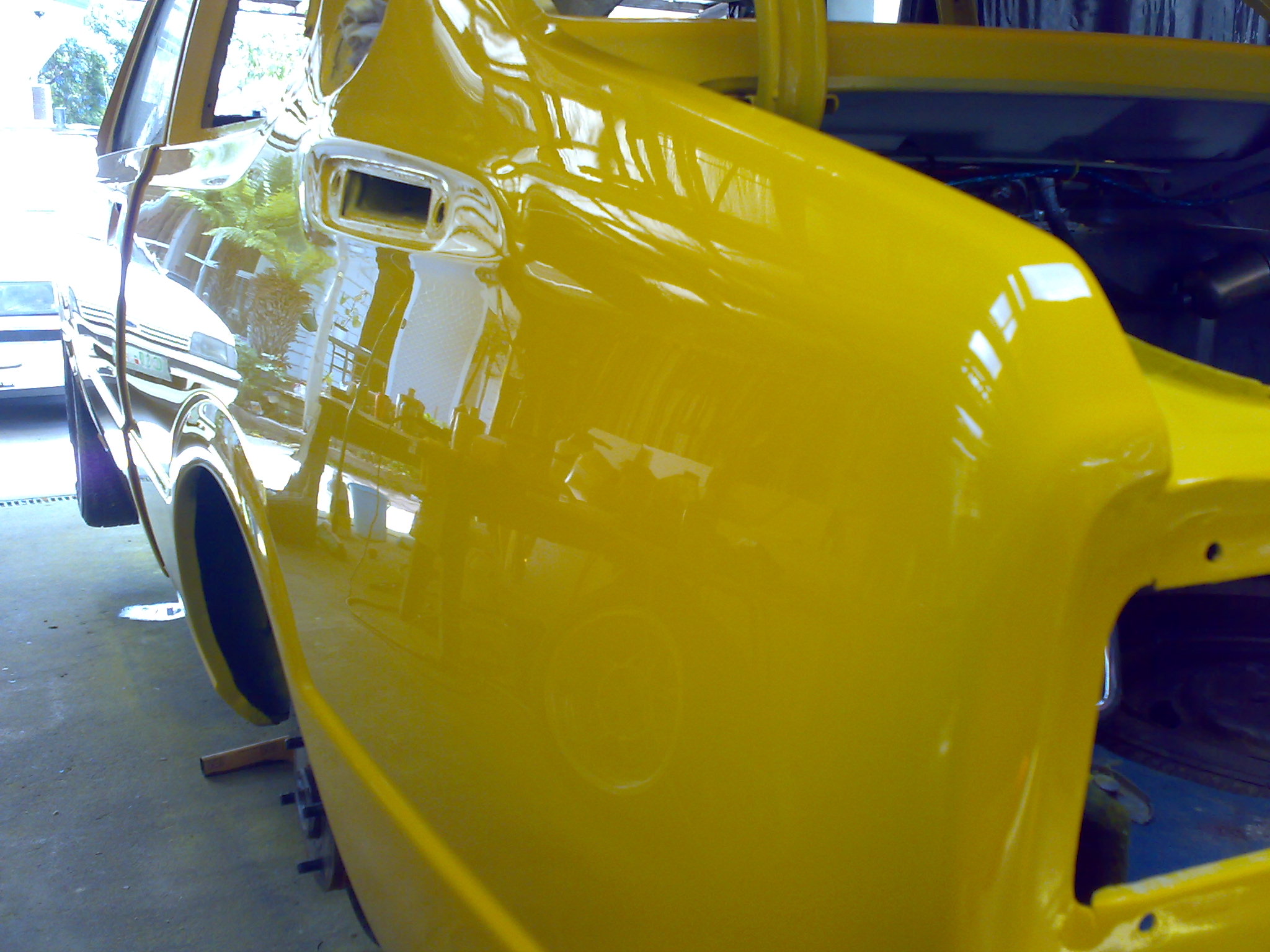

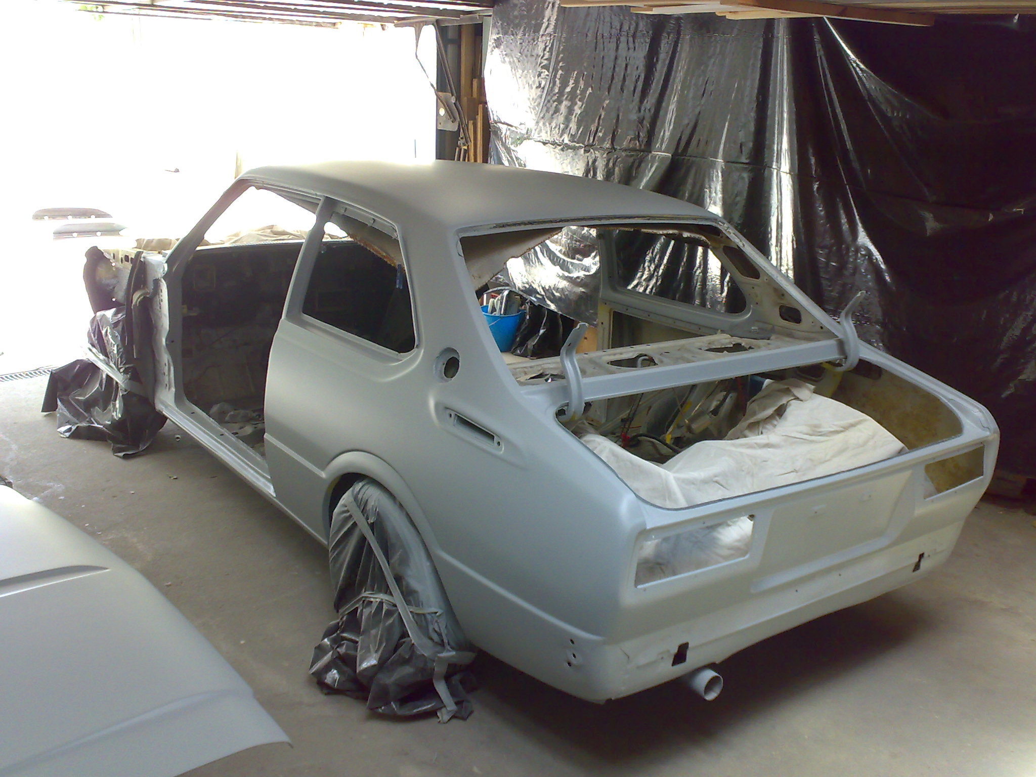

I then set about prepping it for paint. Many weekends were spent rubbing it back and smoothing over the repaired sections.

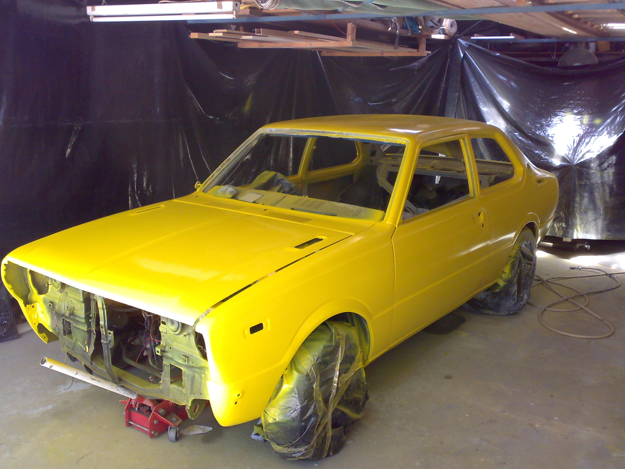

I painted the car in Acrylic Lemon Yellow Tinter.

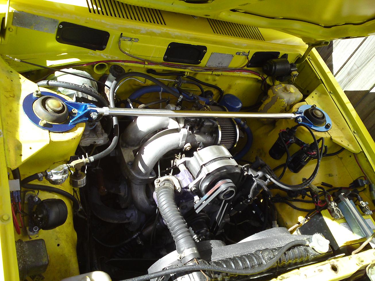

Engine and Driveline:
- S1 RX7 12A Rotary - Std 103rwkW
- 48DCOE Weber
- S5 RX7 Gearbox
- Xtreme Clutches Chrome Moly Flywheel
- Xtreme Clutches Heavy Duty Clutch
- Custom Tailshaft

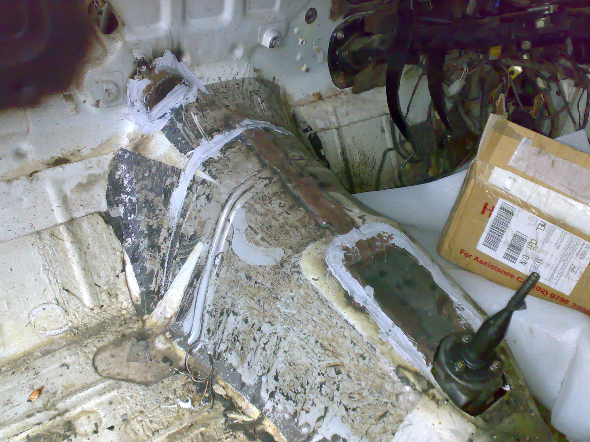

- Stretched Trans Tunnel
- 2" Extractors Into 2.5" system with a Rotaflo Muffler (will be going to a twin system to the diff when I BP the motor)

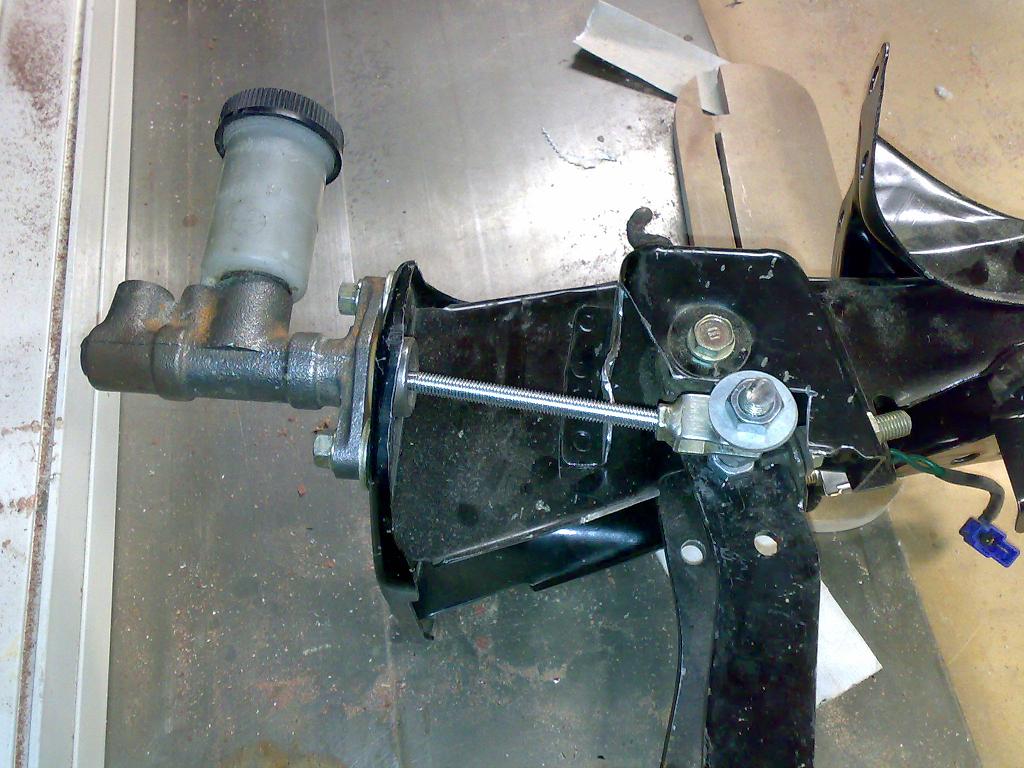

- Pedal Box modified to Hyrdaulic
- R31 Skyline LSD Shortened Diff
- Tailshaft Loop
- VL Commodore Radiator
- PWR Oil Cooler
- Holley Red Fuel Pump
- Holley Fuel Pressure Regulator

Future Plans:
- VL Radiator will be fitted this weekend
- Shim up the gearbox to reduce the slip yoke angle
- BP my S3 Engine and fit my 48IDA Weber to it
- Replace exhaust with 2" Pipes off the extractors into twin Rotoflo resonators into a 2.5" coupling, and over the diff into a Rotaflow Muffler
- Stewart Warner Gauges have been ordered and will be replacing the Speco crap. Speco elec water temp gauge reads 10deg too high.
Rust Repairs
In Primer
Just Painted
Pedal Box

Stretched Tunnel to accomodate Gearbox

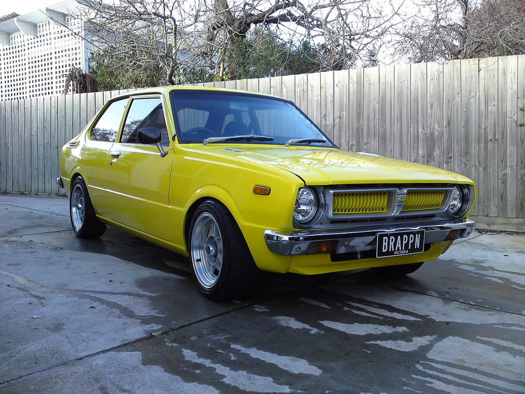

The finished product

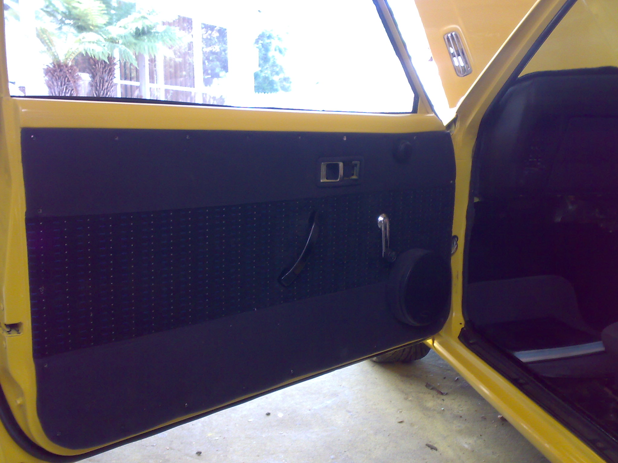

Door Trims - 3mm MDF - I Sewed the fabrics together and contacted them to the MDF
with a layer of Automotive foam to give it some cushion and depth.

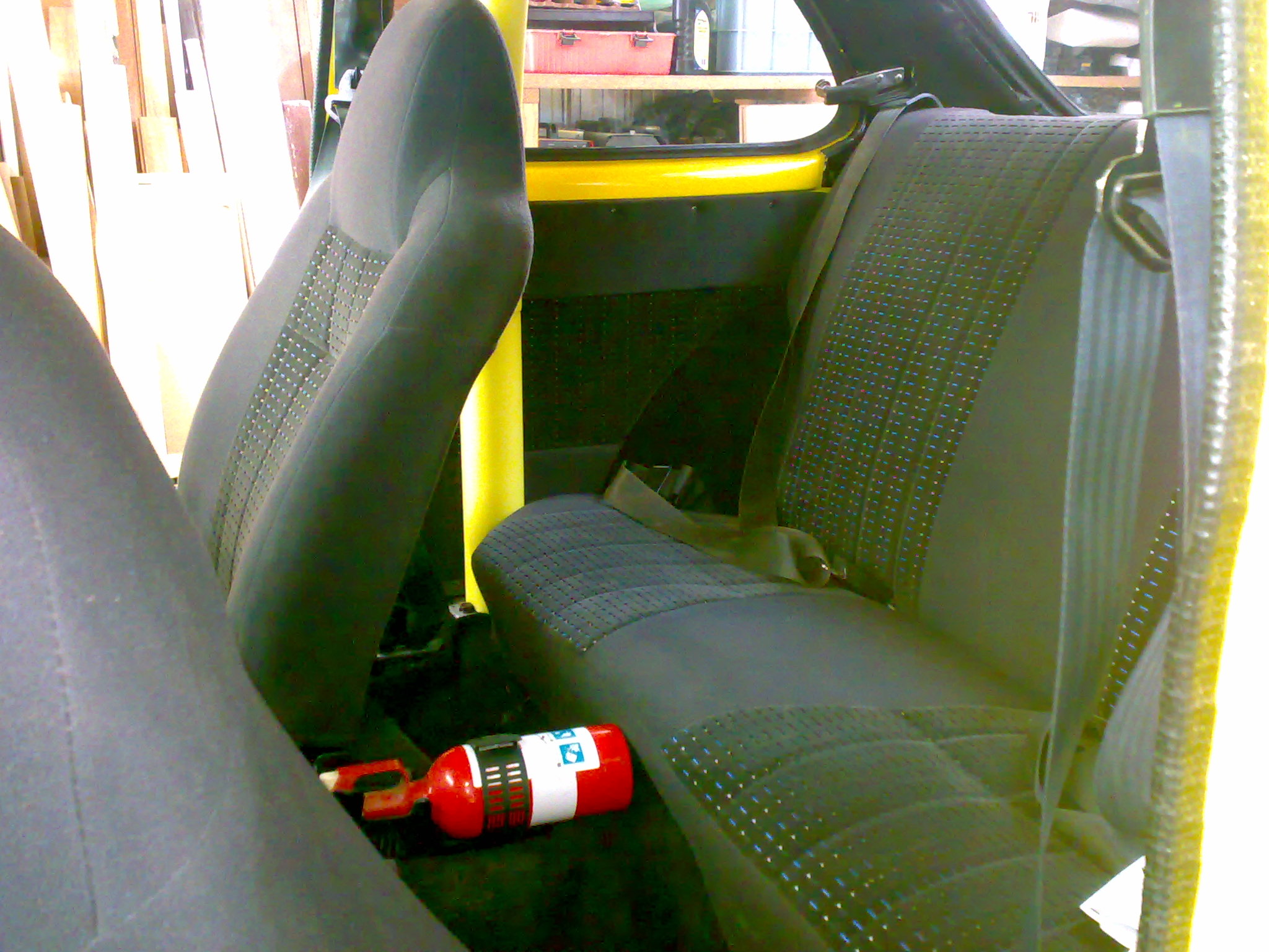

Re-upholstered Seats. Most importantly a Fire Extinguisher in plain sight and arms length.

dfunkt - I was relieved when i got it through the emmissions testing (as part of engineering) second time around as that was the one major hurdle that was giving me grief. It breezed through everything else.
The rectify list was only five items long:
- Emmissions <500ppm HC. It was over 1000ppmHC (Change back to standard Nikki Carb - Tune it for E85 Fuel - Fit Air Pump)
- Reduce front track by 13mm (Get 3mm machined off the mounting face of some TRX rims and bolt them on)
- Replace all seatbelts (Expensive but easy)
- Mutifit wheels are illegal - (Replace with TRX rims as above)
- Rear Leaves too low - (Get some stock leaves reset with an extra leaf, but not as low in ride height)
Pretty easy stuff really.
