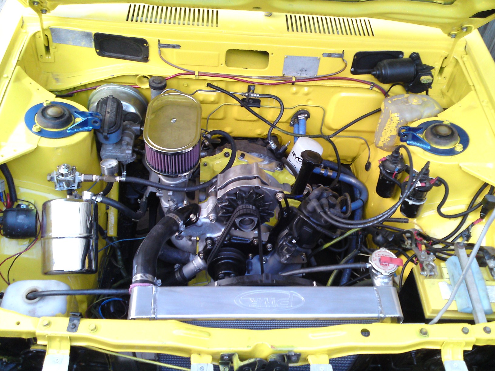

I got a KN56-1210 which has an 85mm high element, and the overall height is 105mm. I had the exact same one here (although the filter was stuffed and the chrome housings were a mismatch) from my engine builder as a mockup one. I also had a taller filter to try (about 5") and there was no chance in hell of that fitting without the grinder making an appearance.
So I have about 25mm of bonnet clearance, which works out nicely.
I just had a quick look at slotting the Rad in. I don't have the patience to start that crap now, as it seems the PWR rad is not a duplicate of the stock one. Theres brackets for the oil cooler welded on which i don't need and its just fouling on things......

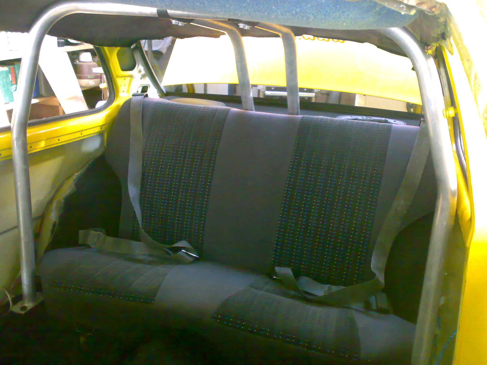

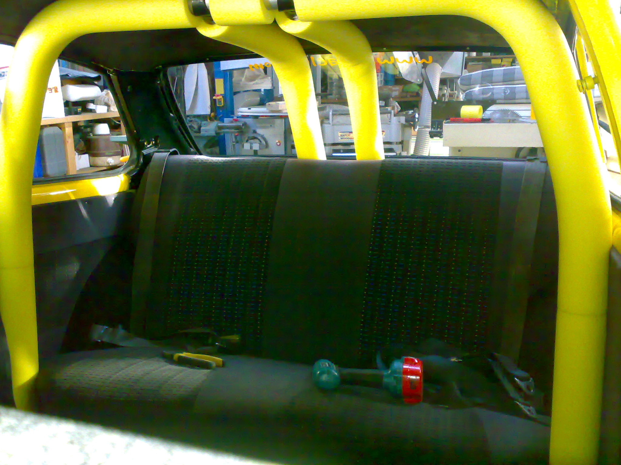

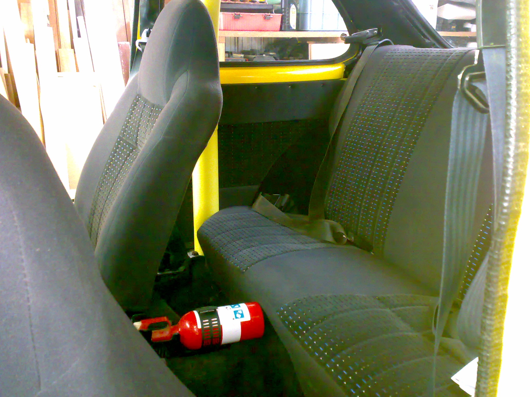

As requested. Just a simple bolt in cage, but i guess its better than not having one at all.

cage looks the goods man. where you find a bolt in cage for the rolla? or did you have it made up?

I bought the cage on here from an interstate bloke. In hindsight, it wouldnt be hard to make one from scratch with a selection of mandrel bends, or even a pipe bender.
