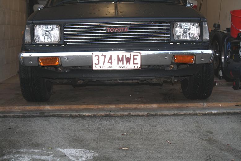

September 25, 201016 yr Author comment_471511 Ha yeah, but the mount on the muffler has detached itself and is currently held up by wire :wink: Lowest part of exhaust @ 80mm But if you guys keep harassing me I'm not impartial to breaking out the angle grinder tomorrow and taking another coil off.... What would a half or full coil amount to??? Two from stock was 40mm. Will the rate get larger themore you take off or the same IE: 1 coil 20mm? EDIT: lowest part of zorst under diff @ 90mm and about 40mm between diff and zorst rails under doors @ 150mm gap between tyre and lip of front guard 25mm. Once car is lower I could bend the zorst up to suit??? Some blocks of wood and a jack, kiwi bends....??? :hmm: Edited September 25, 201016 yr by blzbub666 Report

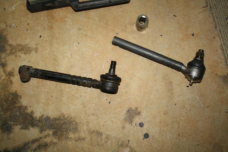

September 29, 201016 yr Author comment_472342 Just replaced my tie rod ends. Fitted the new ones exactly as the old ones were on. Took it for a test drive, was all over the road. I was like "WTF!!!!" Got home and looked at the car front on, it looked like Prince Charles. Turns out the tie rod ends were 5mm shorter than the old ones. What a F around. Had to adjust both sides twice to get it close. Got a wheel alignment to cash in from buying my wheels thank god.< What I have learned, buy genuine Toyota parts. :y: And yeah KETURBO25 its a good system, though I spray gunned my car and touched up with cans, its the same as any other colour, doesnt quite match. RESPRAY!!!! EDIT: The steering wobble is gone and steering is TIGHT. Edited September 29, 201016 yr by blzbub666 Report
