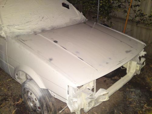

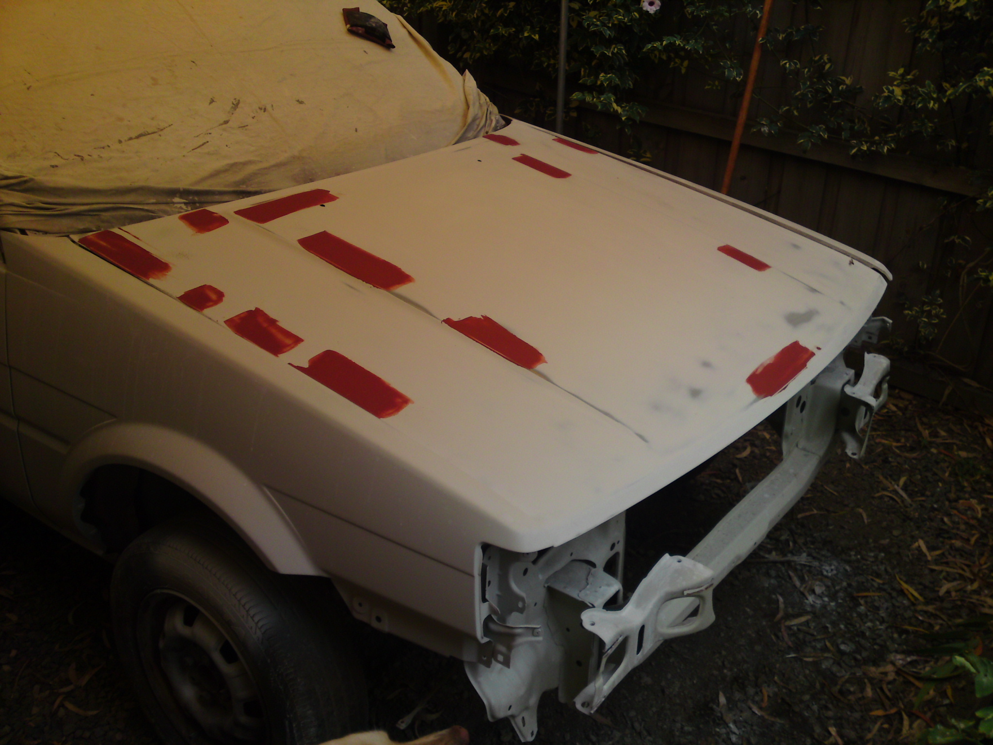

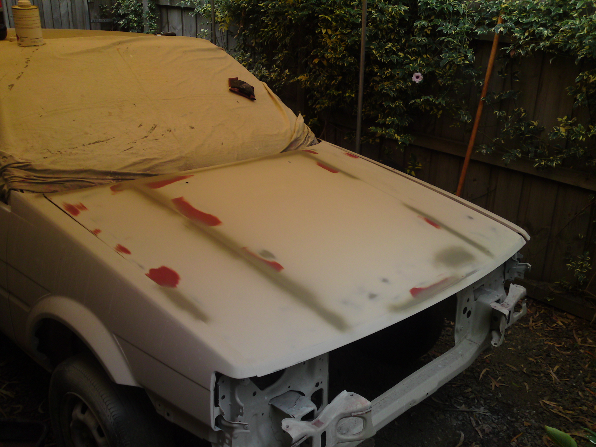

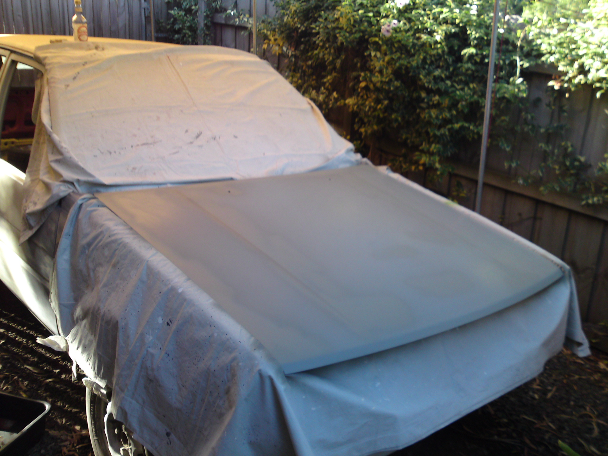

Started working on the front end of the seca so its ready to transfer over to the sedan. The bonnet has not had any attention to it for over a year and there was only 1 coat of etch prime on it so it was starting to rust up again.
Here's a list of things i been doing in the last week
1. Washed the car down
2. Sanded it back
3. Touched up the bare metal spots with etch primer
4. Sprayed couple coats of 2pack undercoat
5. Sprayed black paint (guide coat)
6. Block sanded
7. Filled with stop putty
8. Touch up spray with etch prime where i sanded back to bare metal
9. Undercoated bonet with 2 pack
10. Guide coat again
11. Filled again
12. Touch up with undercoat
Pics
You can see just how many dents
were on the bonet after i block sanded it

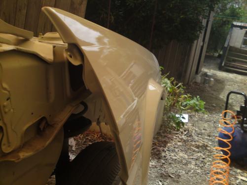

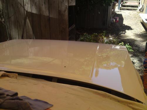

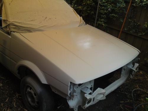

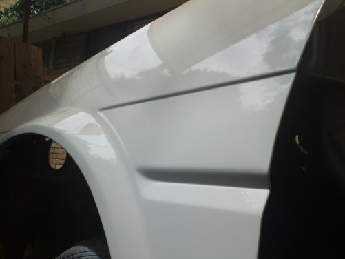

Today i painted the 2 pack Gloss on the front end.
both quarter panels are finished but the bonet has only got 1 coat on, Wind, dust, lint and bugs were a huge problem.
I was amazed to find that 600 grit sandpaper was too rough, i had to rub it all down with 1000grit before applying the last coat on the quaters.
There is still a bit of crap on the paint but its pretty good concidering I didn't use a spray booth :D
My finished panels in the sun to bake
Edited by Johno

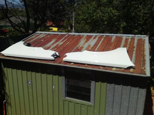

I wasn't happy with the finished guard's so I gave them another coat this arvo and they came up awesome :hmm:
Not a single little dent anywhere, just shows how much 1 years worth of prep can do I guess.. :D
I wasn't happy with the finished guard's so I gave them another coat this arvo and they came up awesome :D
