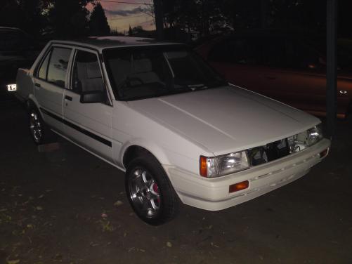

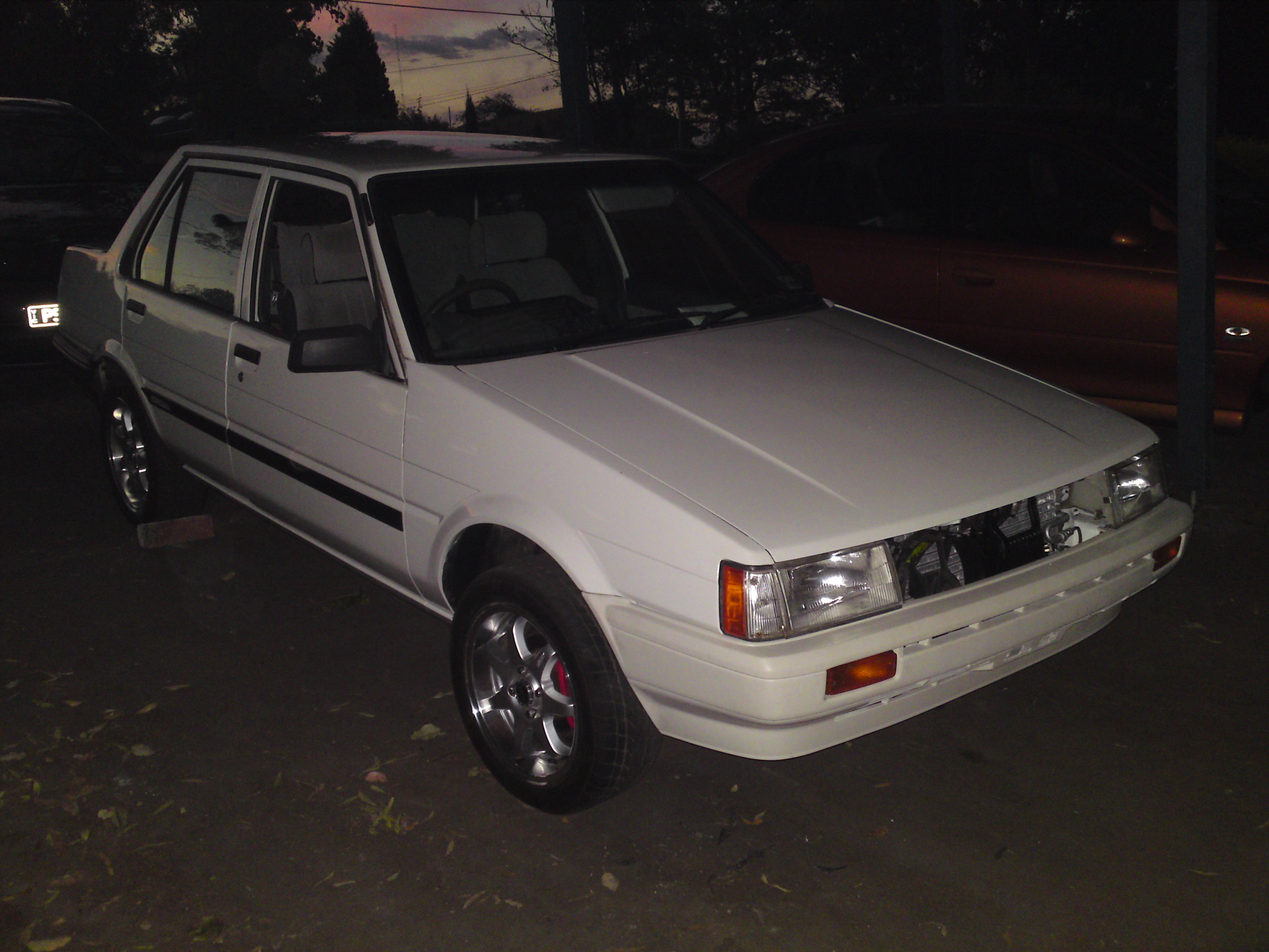

Little sneak peak of where its up to..
I'm trying to keep it as stock as possible for the roadworthy so I want the 13" wheels back on but they don't fit on now because of the bigger brakes :lolcry: I really need to lower it but the new springs i got are a bit too low for the roady i think, stock airbox is in, stock exhaust is in, bumper on (just needs to be painted)
Need to sort out the heater fan wiring, 4ac heater wont mix with the 4age loom :lolcry:
I'm thinking about taking off the side strips? What do you think?
Edit: Oops, forgot to upload the pic.. :lolcry:
