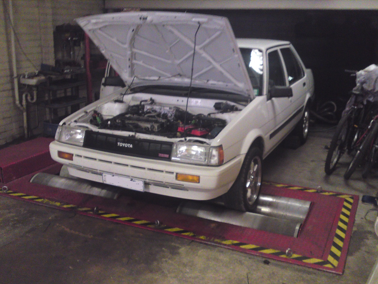

Booked in for a Dyno tune today.
  • Replies 140
  • Views 113.2k

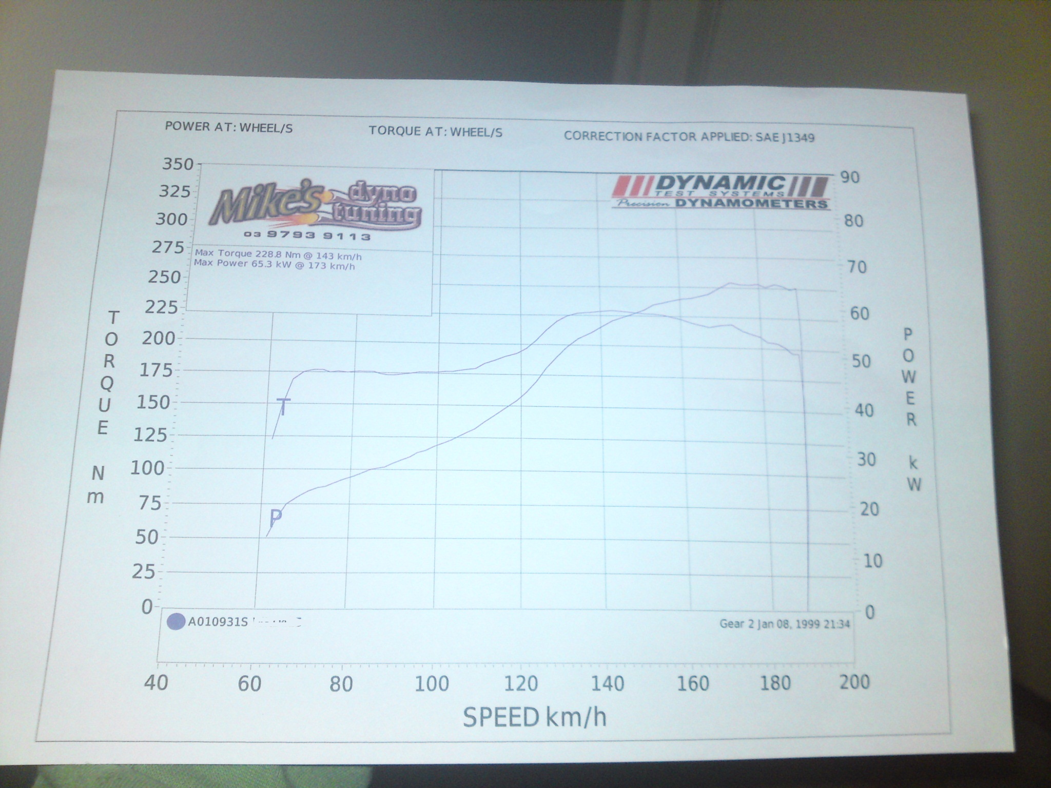

Done the dyno test.. :P
65.3kw @ the wheels 229Nm of torque
http://www.youtube.com/watch?v=bcfg8CVfqlo
EDIT: I just got the dyno run to see what I'm putting out atm. Now its mod time.. Hehe!

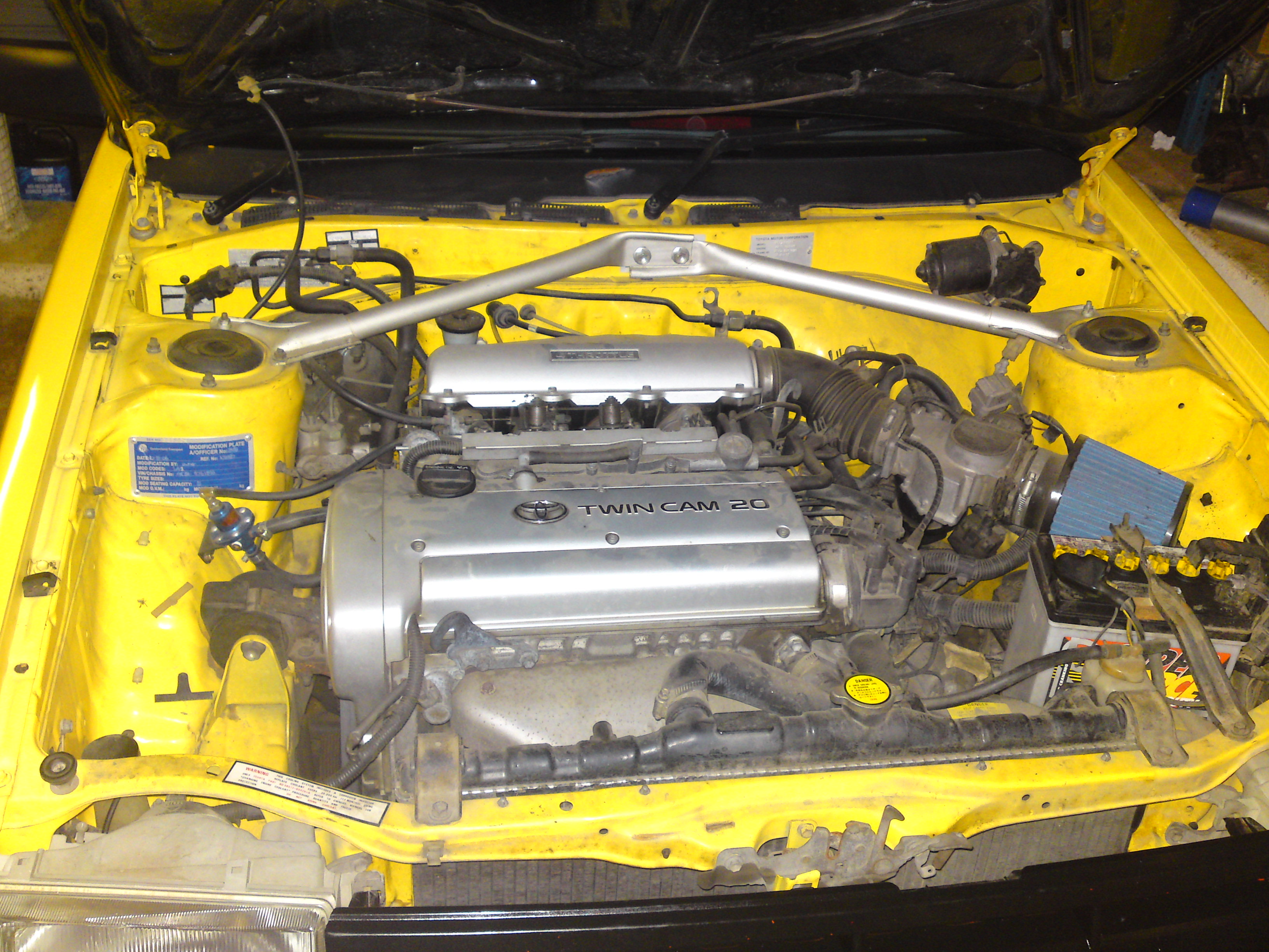

Still not sure whats happening to this.. still doing strange things :P
Hunting idle comes and goes
Oil cap has gone like a chocolate milkshake but oil is still clear honey in the sump then the oil cap clears up again :D
sometimes I hear water under dash then other times not, even with heater on.
I'm loosing water from somewhere but can't find a leak
Temp gauge almost goes to red then back down to half again and does this 3-4 times on a 40min drive
big oil leak from cam covers and front of cam gear housing and some leaks from the head on gearbox side
I feel like just taking it to the mechanics to get all fixed but wheres the fun in that (plus it costs money) and I'm broke ATM :no:
and not only that, my daily decided to blow a heater hose today, prob jealous that i been with the corolla for so long. EL fords are a prick to work on, just had to help my mate change a coil on his EB.
AND i have to work tomorrow just get get some cash together so i can't work on either car :hmm:
Edited by Johno
The water under the dash & The temp guage rising then falling could be caused by an air lock in your cooling system.
Try idling the car for a while with the radiator cap off and see if any of it bubbles to the top.
Cheers for the reply :D. I bleed the cooling system 3 times and its still getting air in the system. Oil cap is clean again today.. Wtf??
