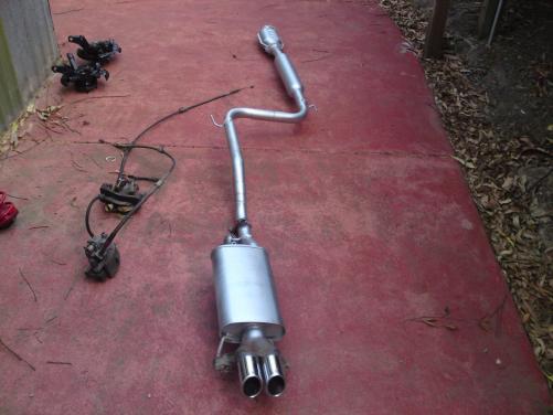

Painted the 2" sports exhaust in heatproof paint

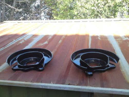

Rear disk brake thingo's

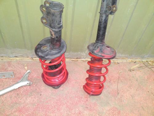

x4 twinky shock strut thingo's. Just the springs for now, i'll let it dry out then cover it in tape and do the black

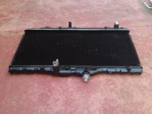

Radiator
