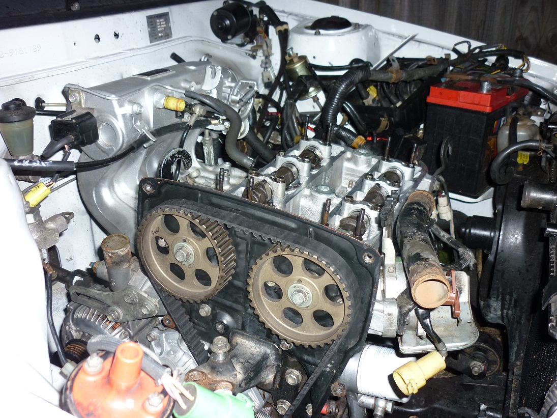

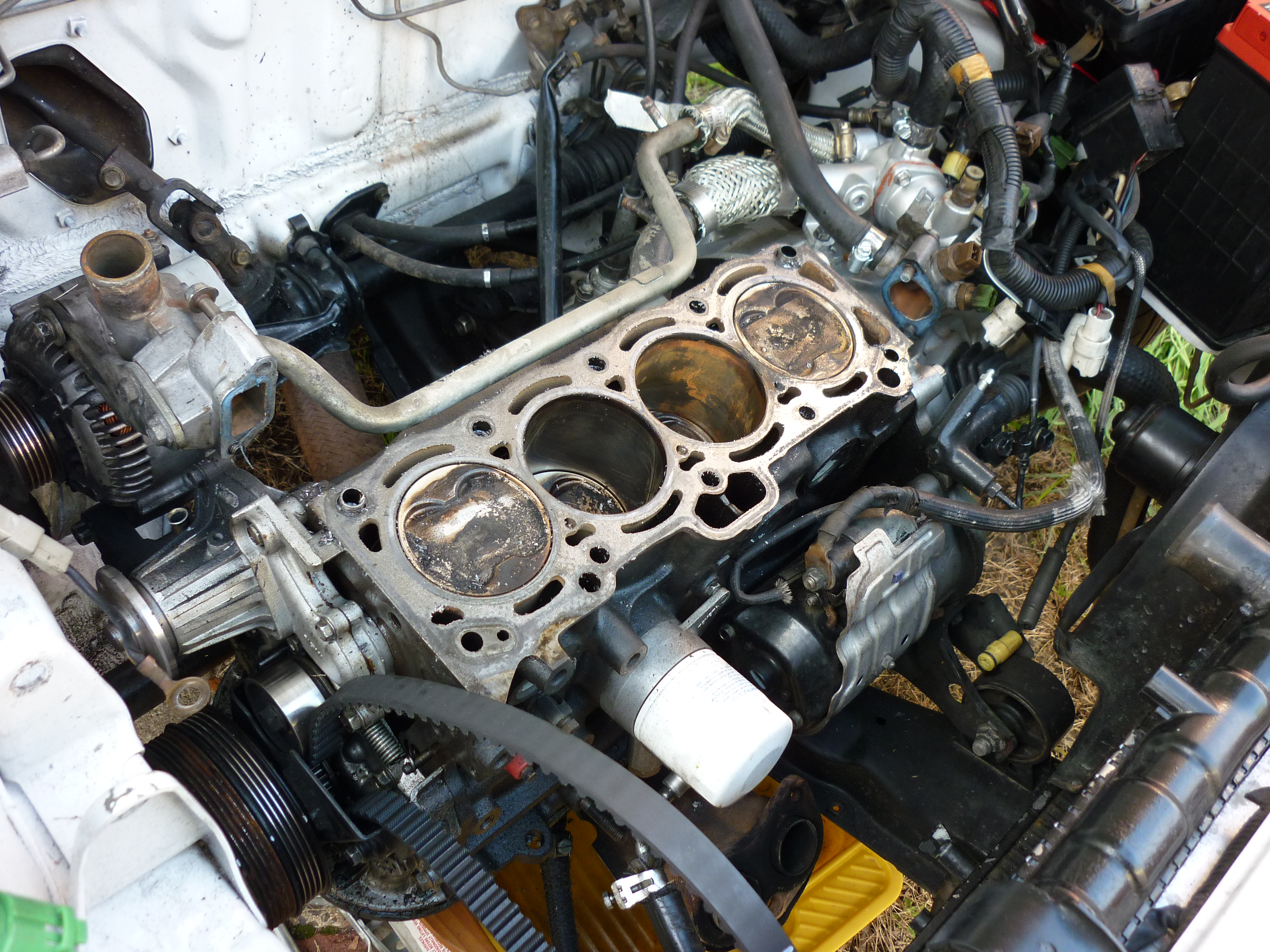

Cheers guys, I took it off the road and lastly drove it to a mates house last night for repairs. I started stripping the motor down and all i have left is the cams and intake manifold then i can undo the head bolts and go from there.
I couldn't believe just how f@$ked the oil was. All through the cam covers is Grey and white slug/oil everywhere :P

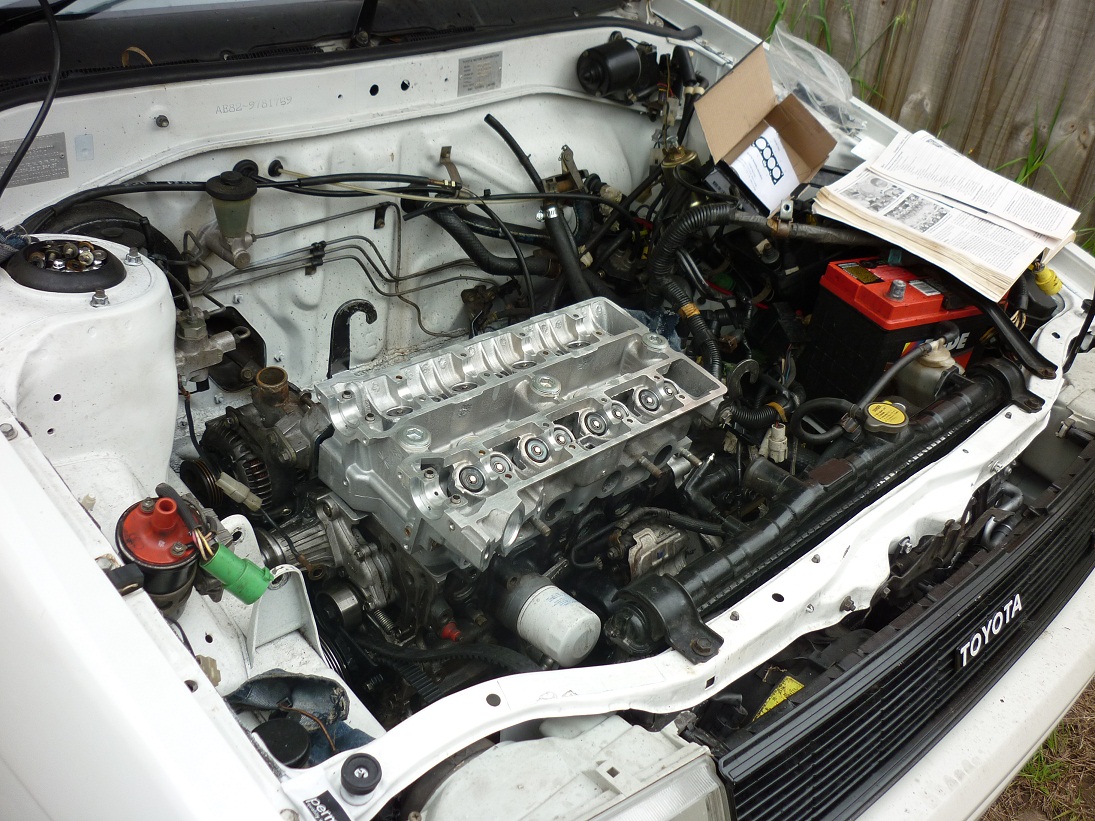

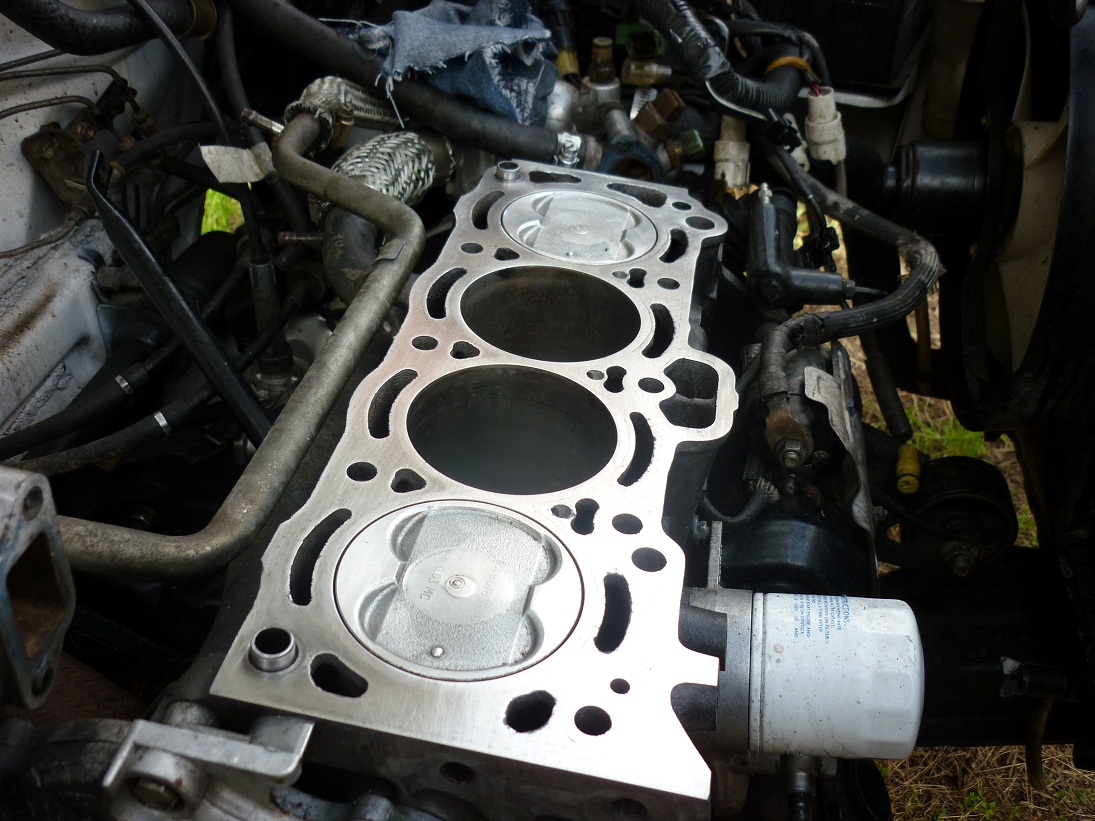

Pulled the head off and found the gasket blew in 2 spots. Took the head to my mechanic and he recons maybe i will need the head welded up but testing will find out for sure. I should know in a few days. Bought a new reground gasket kit. It includes every gasket and seal i need to rebuild the top of the engine. I also bought a new set of 4age head bolts and also bought a 0.8mm TRD metal head gasket. I aslo asked if they could polish the exhaust ports on the head when it gets refaced :jamie:
  • 4 weeks later...
Big update time.
I got the head crack tested and pressure tested and all good.
Got it refaced, I was going to shave it 20thou but my mechanic advised me not to because I'm using a 0.8mm head gasket.
Fast forward 2 weeks..

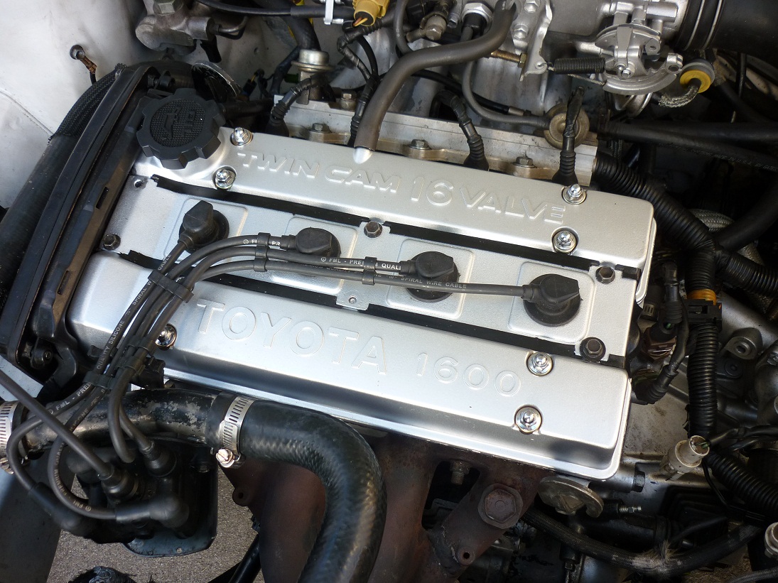

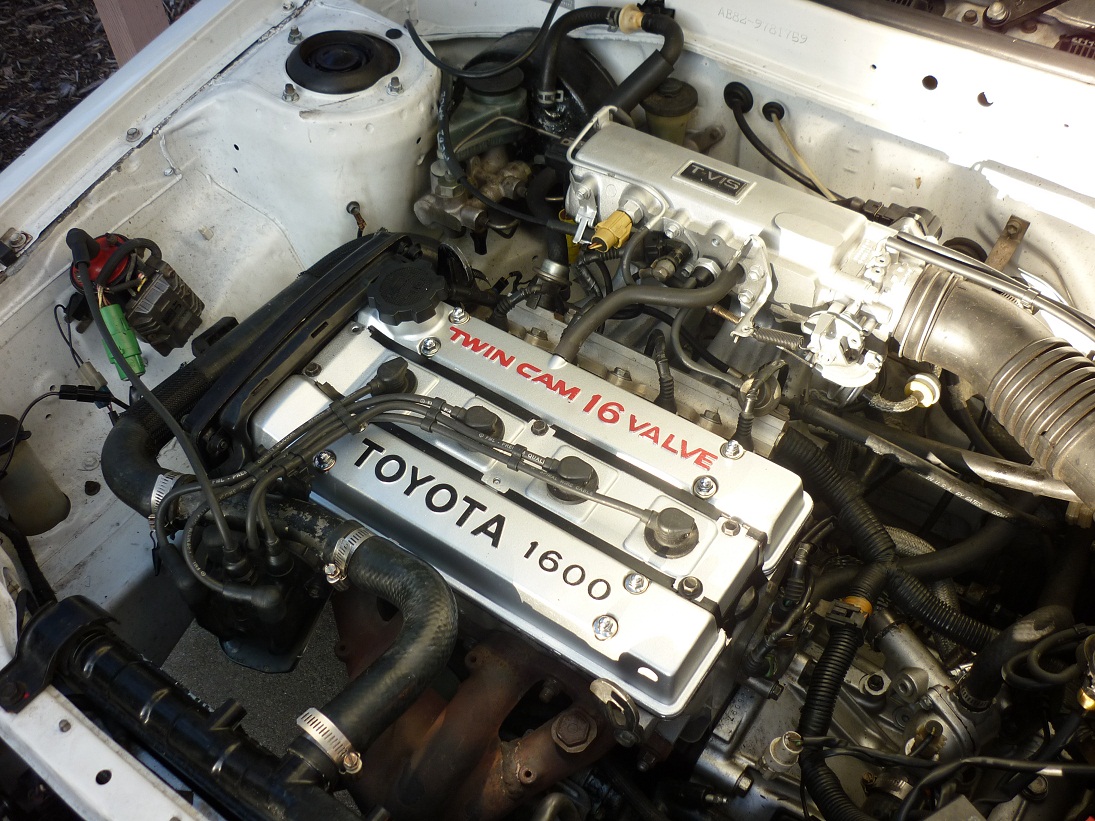

Well i was going to use the 0.8mm gasket but my block was not as clean and straight as it could be and couldnt be stuffed getting a stone so i used the standard gasket that came with the VRS kit just to keep it safe. I put everything back together and it started up fine. Painted the cam covers while it was all apart

Ha, it won't need to be reshimmed if the shim and buckets went back into where they came from as it has only been cleaned.
then just retorque head bolts
