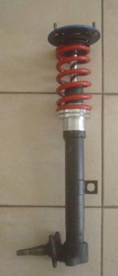

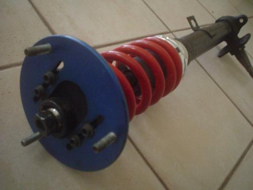

I'm doing a coilover conversion on my 20 currently.
When I have done it I will post pics and specs of parts I used :hmm:
When I have done it I will post pics and specs of parts I used :blinks:
