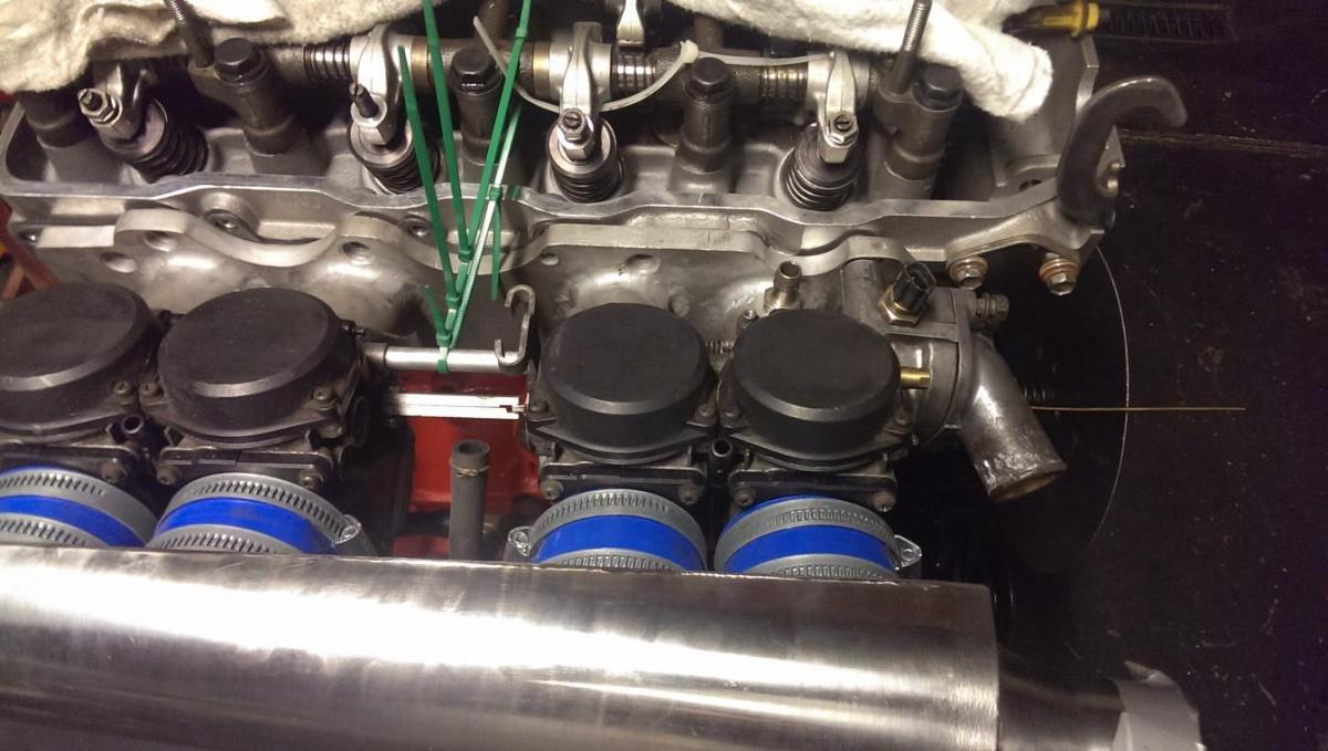

3psi is specified pressure. there also gravity feed on the bike as the fuel tank sits higher than the carbs
problem 1. thermostat

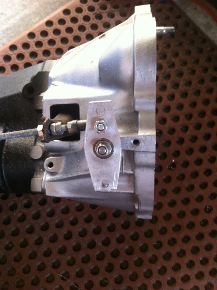

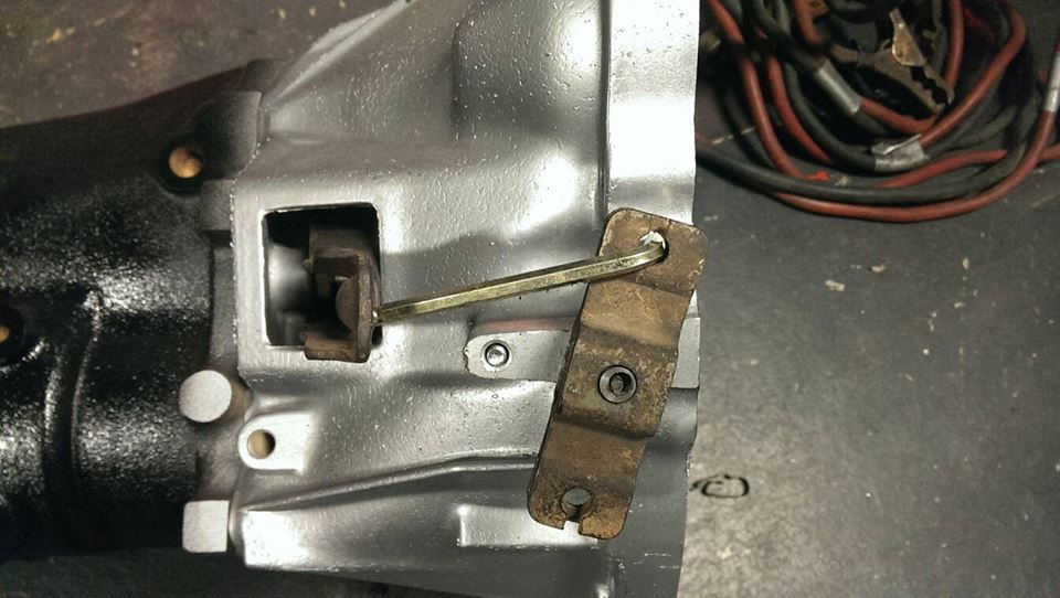

problem 2. W50 is hydro (I'm NOT CONVERTING!!!!!!)

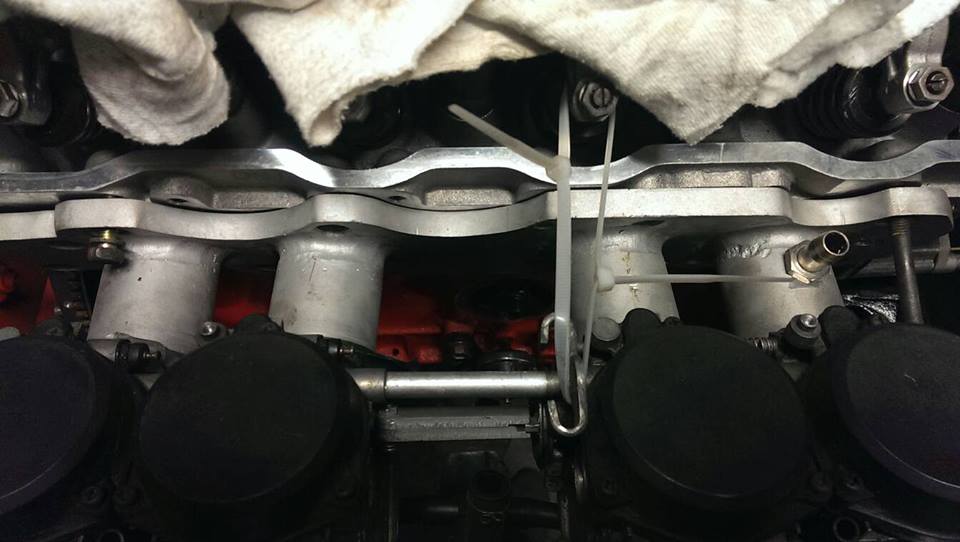

simple looking system. wil be making something like that with 10mm steel with a bearing or brass bush in the centre. adjustable push rod and should work like a charm ;)

carb setup looks nice, yesterday i modified my w50 to suit hydro clutch....
clutch mod is 90% done

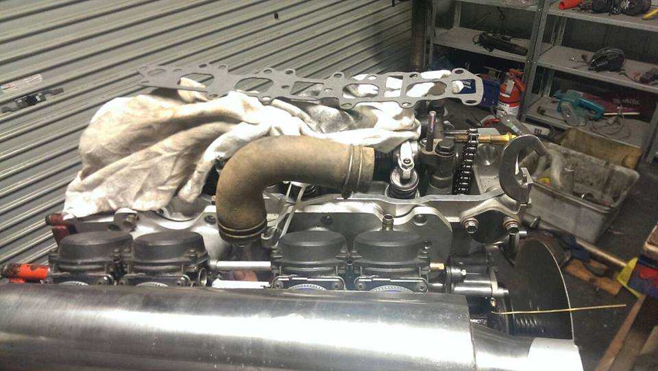

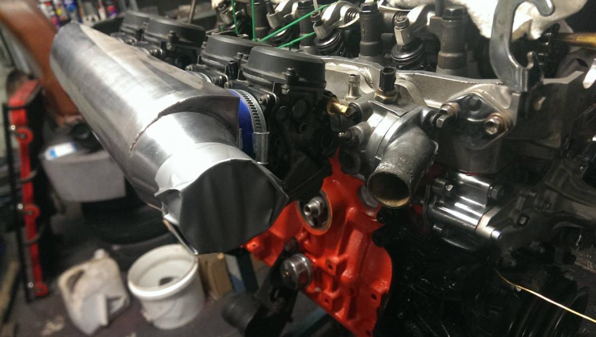

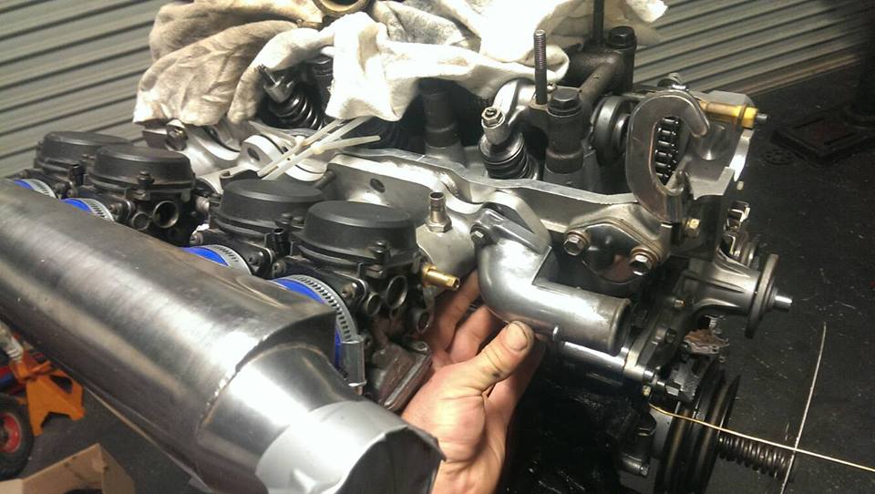

went to my local wreckers and found a ford courier thermostat housing that looks nice and neat.
