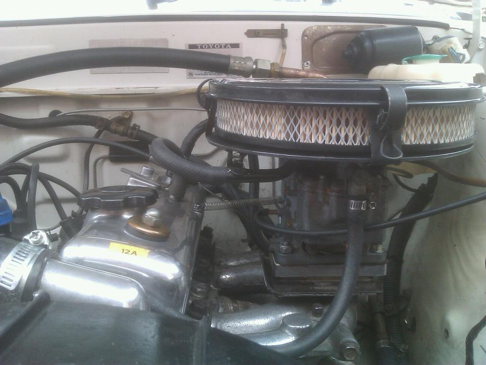

i replace my dissy oring and re installed my dissy. set my timing by ear. checked it when i got home. was 1 tooth out and idling at 40/60 degrees advanced LOL! didnt like to rev at all. all fixed now.
brakes need a real good bleed as they feel inoperative :/
fitted my 28/36 dcd. most simplist amazing carby ever! don't need to remove the top section of the carby to change jets!
pulls like a sucking fchool boy! shits all over my old 5k. induction noise is also amazing.

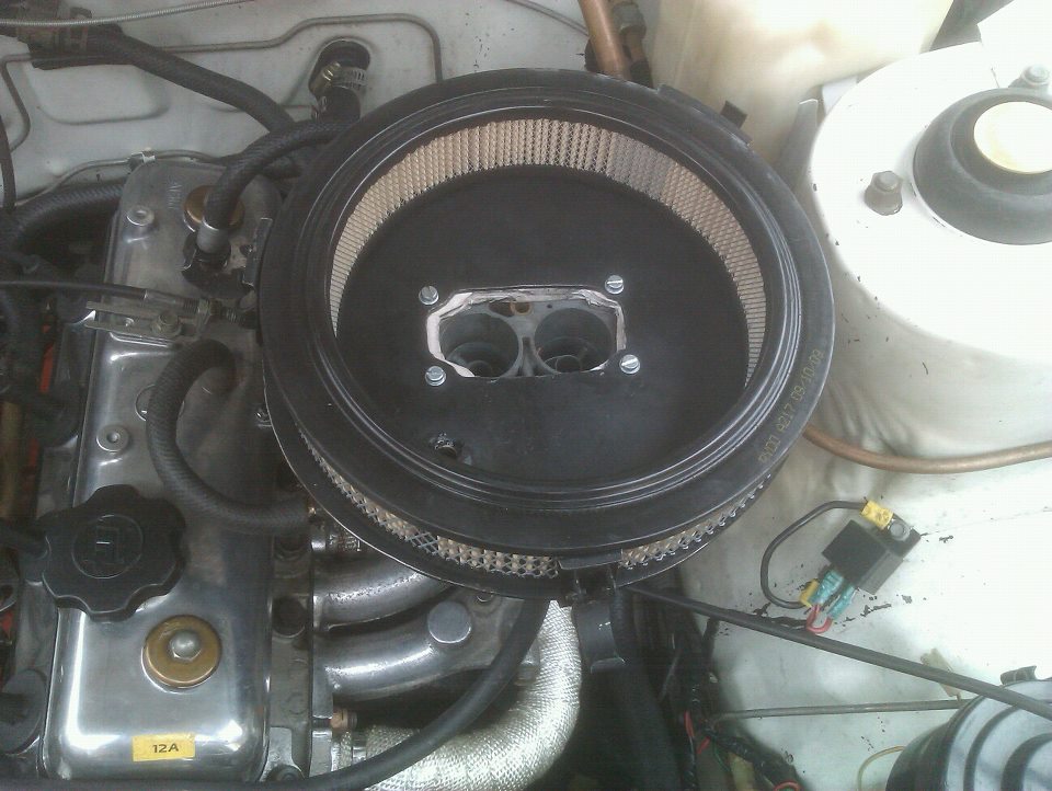

didnt have a gasket for the weber and use a bit of silicon.
on the way back from lunch with the boys she wouldnt play ball. checked my main jet and no fuel came out but a chunk of silicon did!
fml.

28/36 dcd nice! I'll get around to putting mine on one day haha
Couple of questions..
What venturis are in it?
Is it ok to fit with standard fuel pump, no pressure regulator or return line?
What size jets are you running?
Looking good!
Cheers
gday boss, std fuel is enough. No return or reg
Primary is 26 sec is 27
130 pri
150 secs
Runs like a champ!
thanks chief! i was trying to copy masons design
i love mechanic secs. the fuel gauge drops as soon as you hear induction but :P

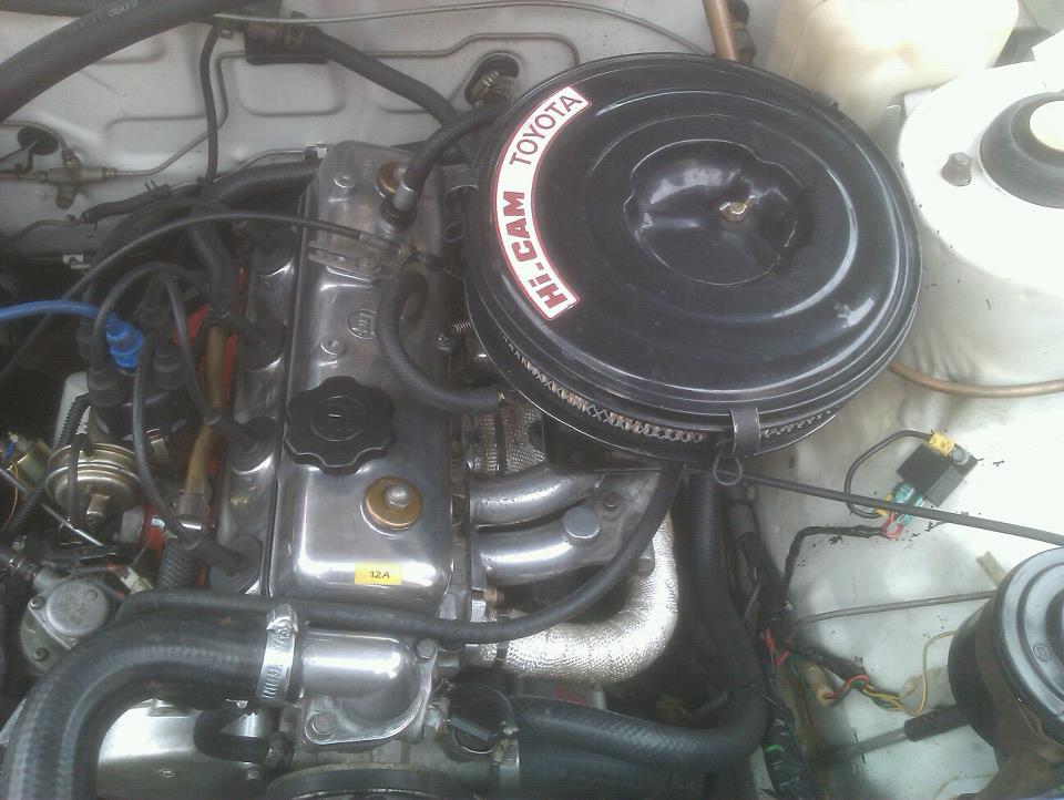

LOL at the 12a on the rocker cover :lolcry:
12a with noisy lifters :P
