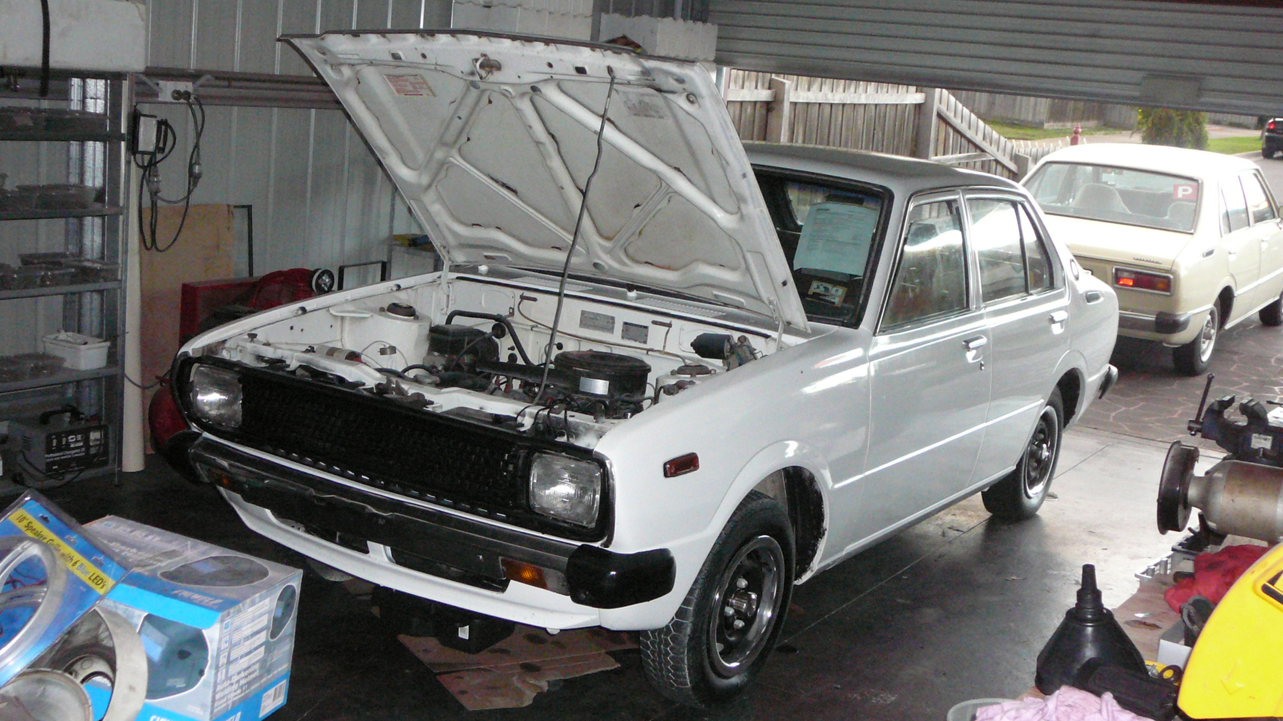

i scored this one off ebay for $650, picked it up from albury (boarder of nsw/melb). since i couldnt find anyone to tow it back on a tralier i decided to drive it back sad.gif, it was a 3 hour drive each way.
i loaded the car with almost all my tools from work. spare dissy/fuel pump/carby/tyre Just incase.. what a waste of time that was. drove it back didnt break down! but then again it is s a corolla smile.gif
some pics

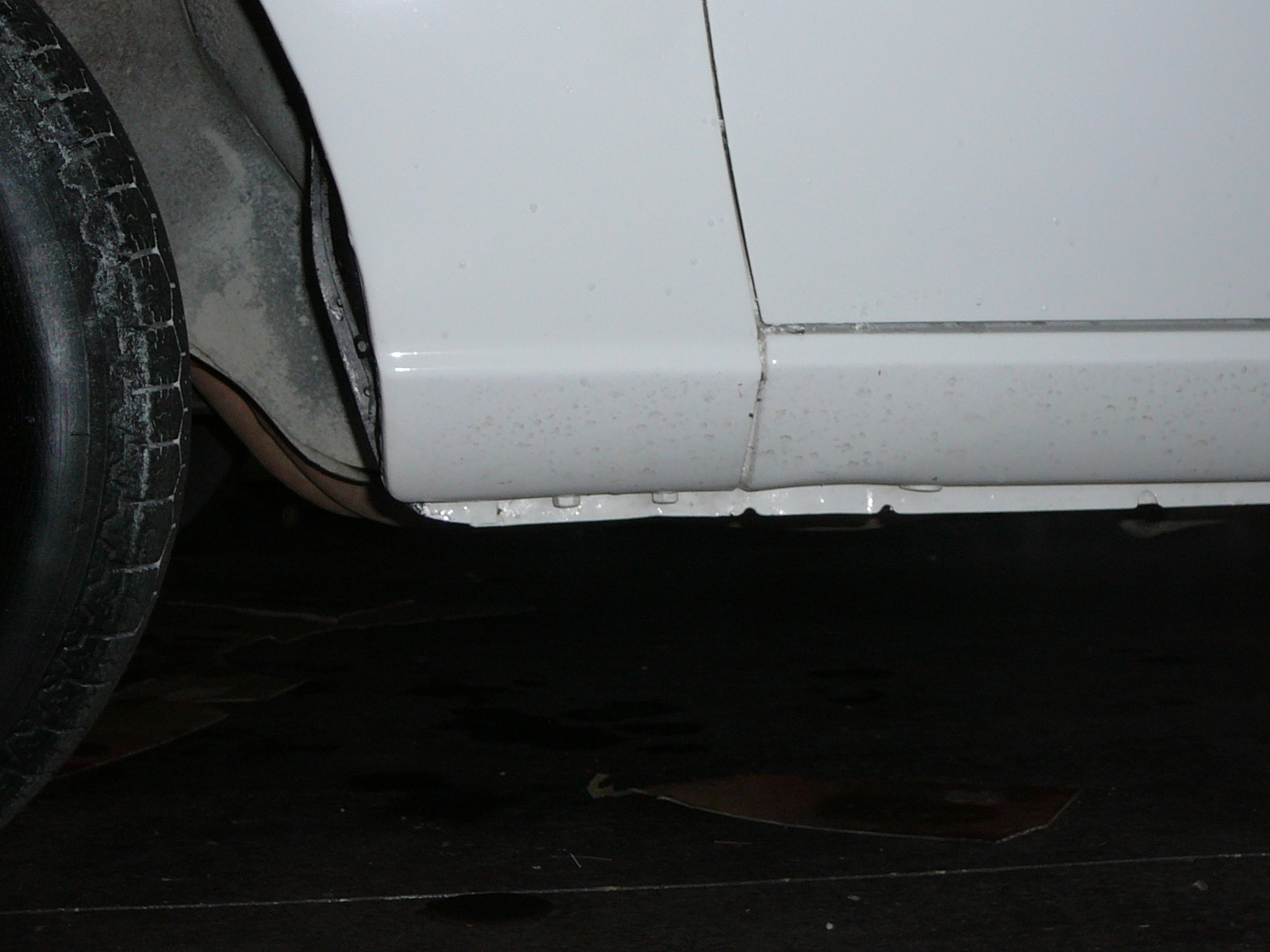

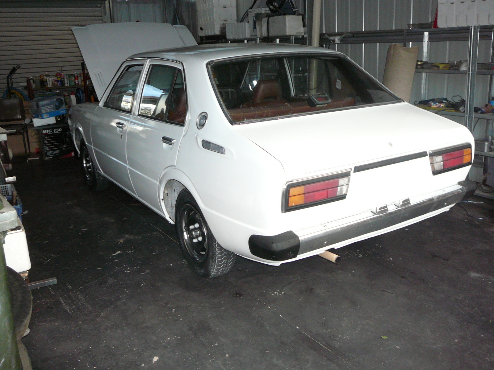

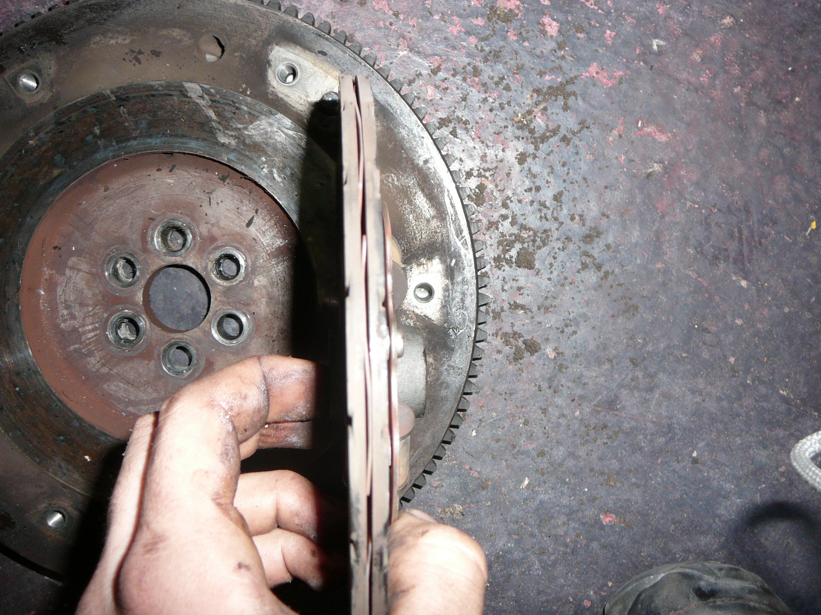

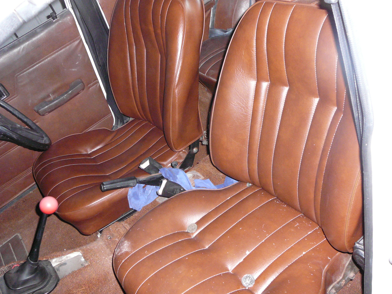

post-8435-1270887654_thumb.jpgpost-8435-1270887746_thumb.jpgpost-8435-1270887786_thumb.jpgpost-8435-1270887838_thumb.jpgpost-8435-1270887889_thumb.jpg post-8435-1270888032_thumb.jpg

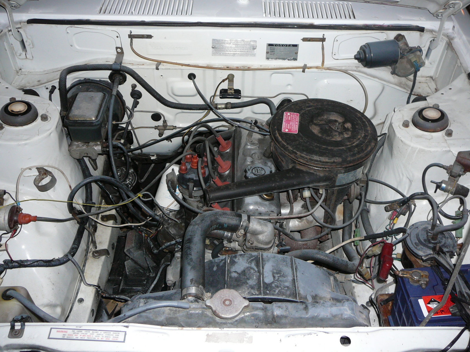

as the story goes from the seller
he bought it off a 16 year old girl who was learning to drive in her back yard, so she painted the car in pink house paint!
so the seller bought it off of her. sanded it all back and painted it in 2pak. he painted it and bought a bombadoor and lost intrest
200 something on the clock.
5 speed manual
blows a bit of some on start up
noisy thrust & input bearings
stripped thread on the sump plug!

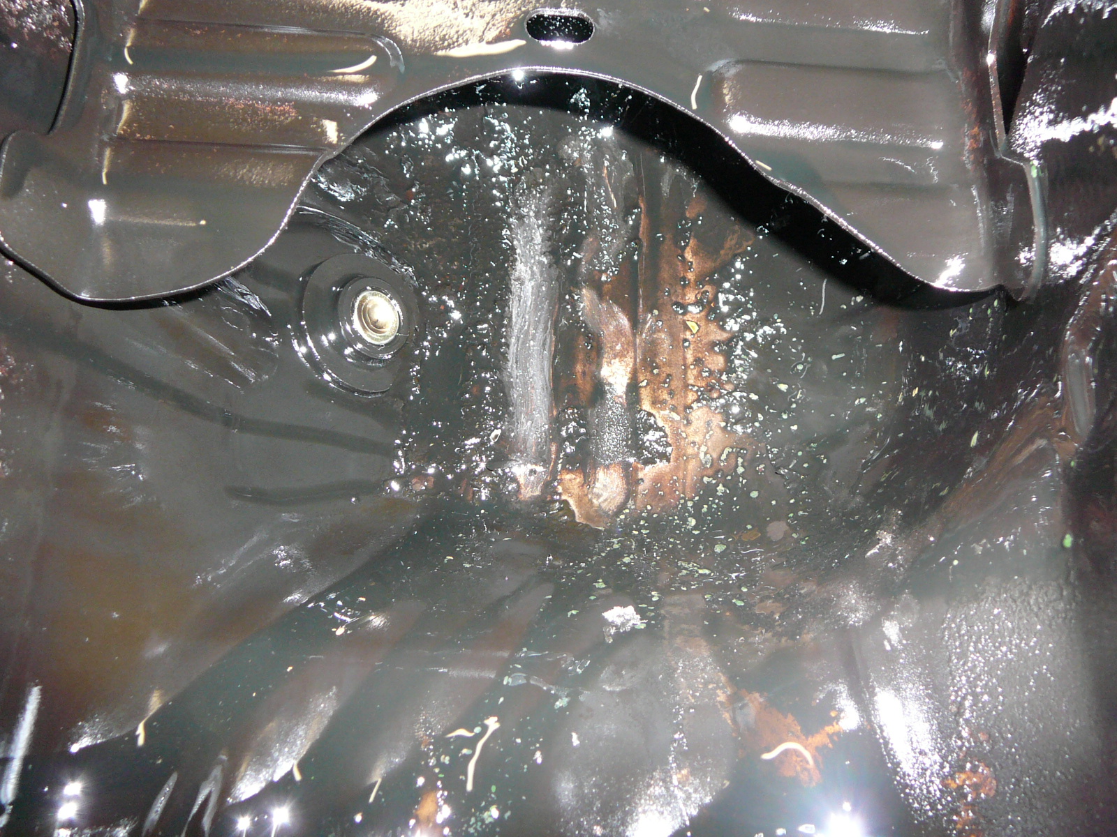

over spray everywere

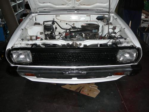

and most of all square head lights

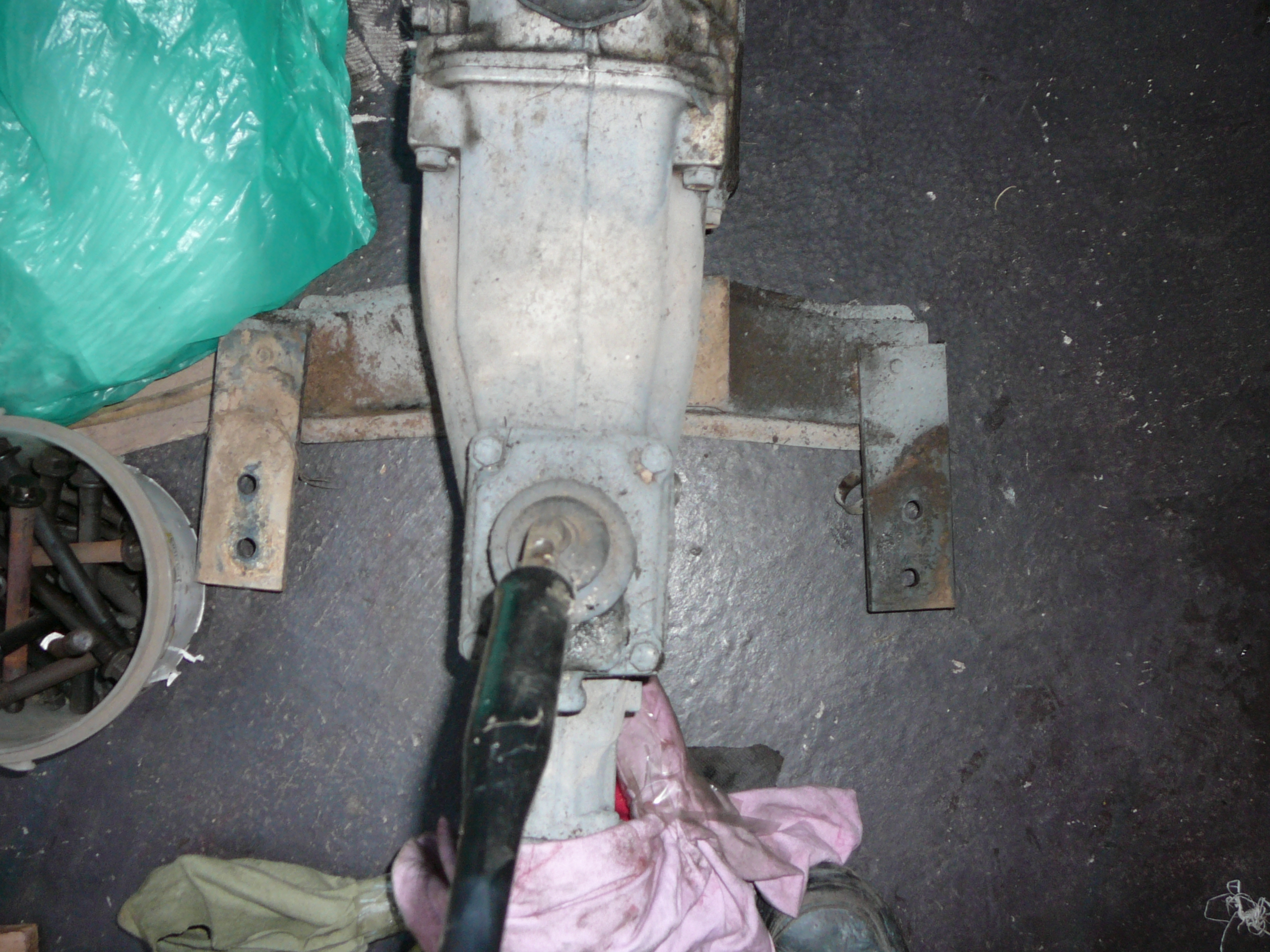

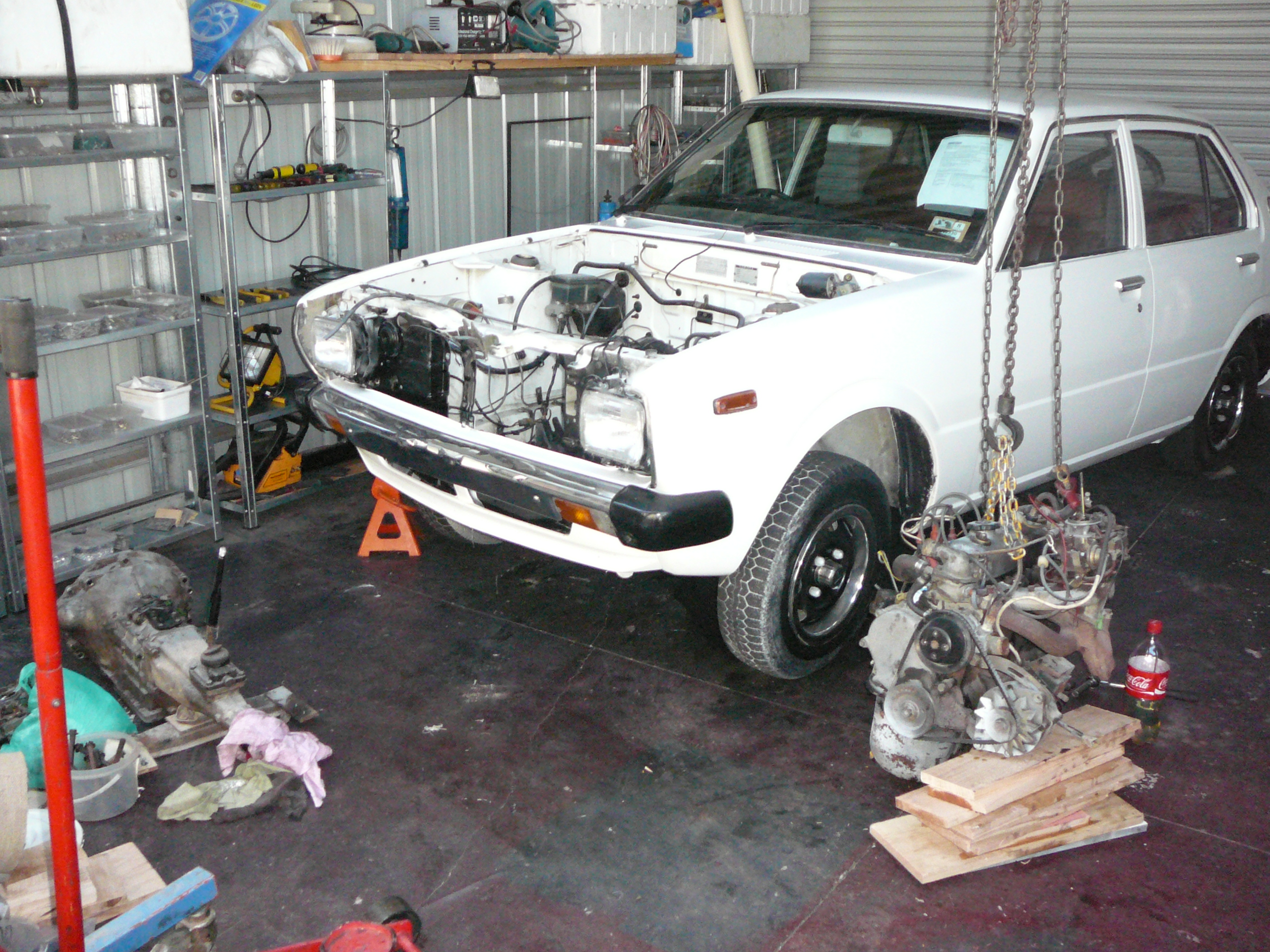

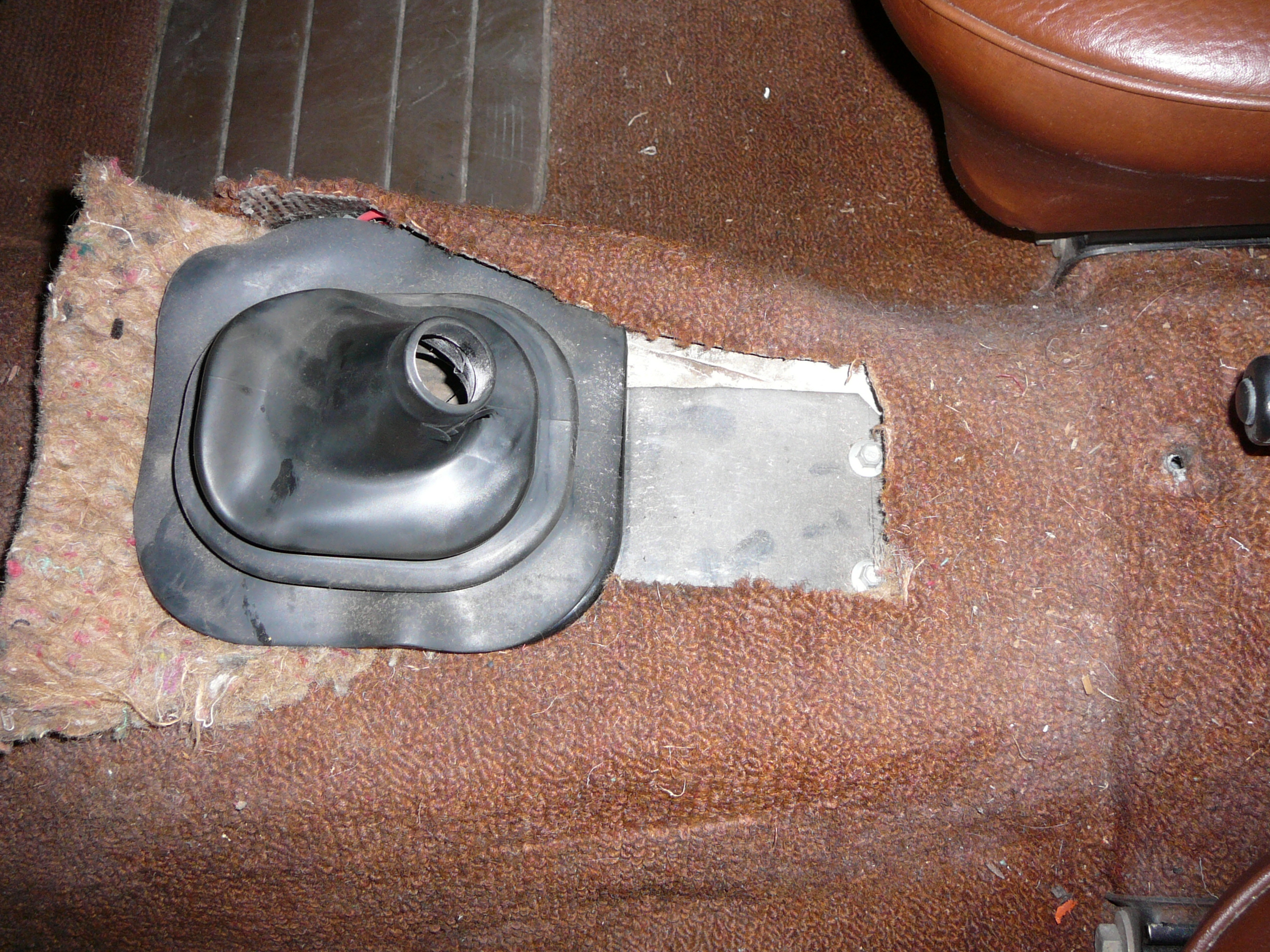

ripped the engine & g/b out
previously a auto? looks like it!

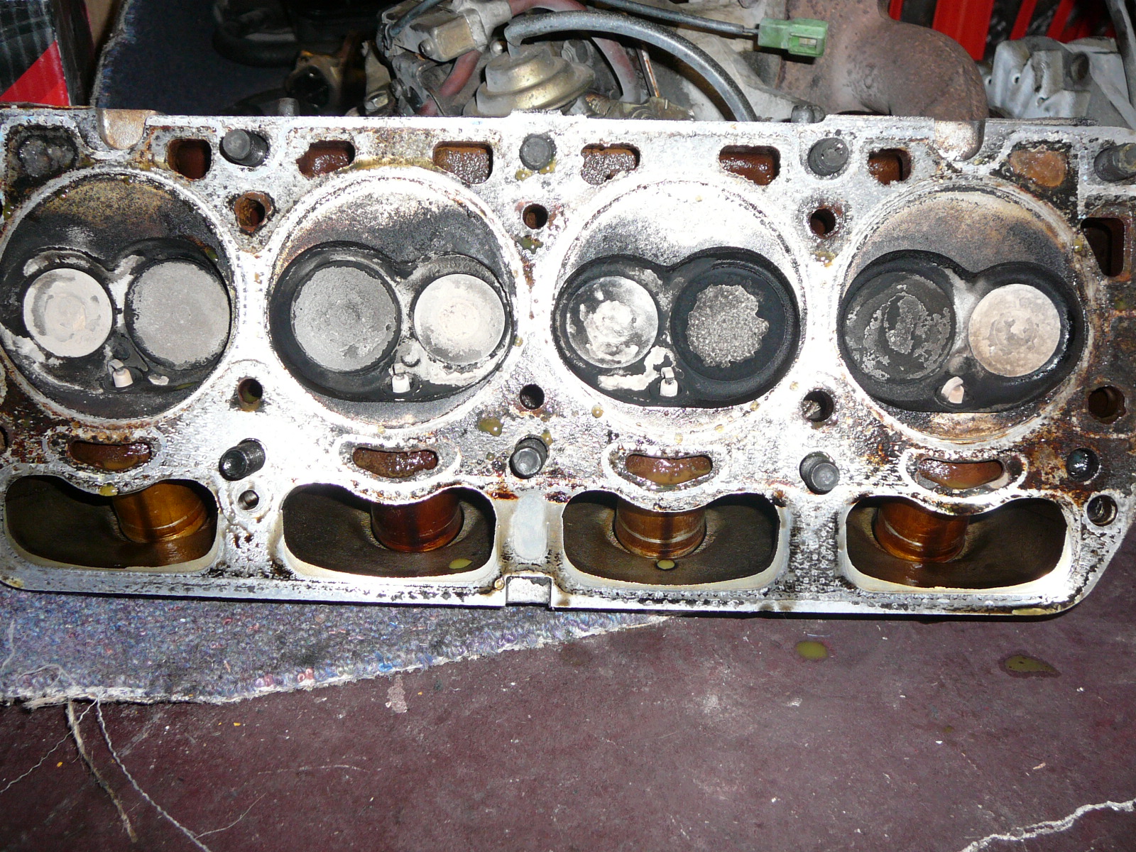

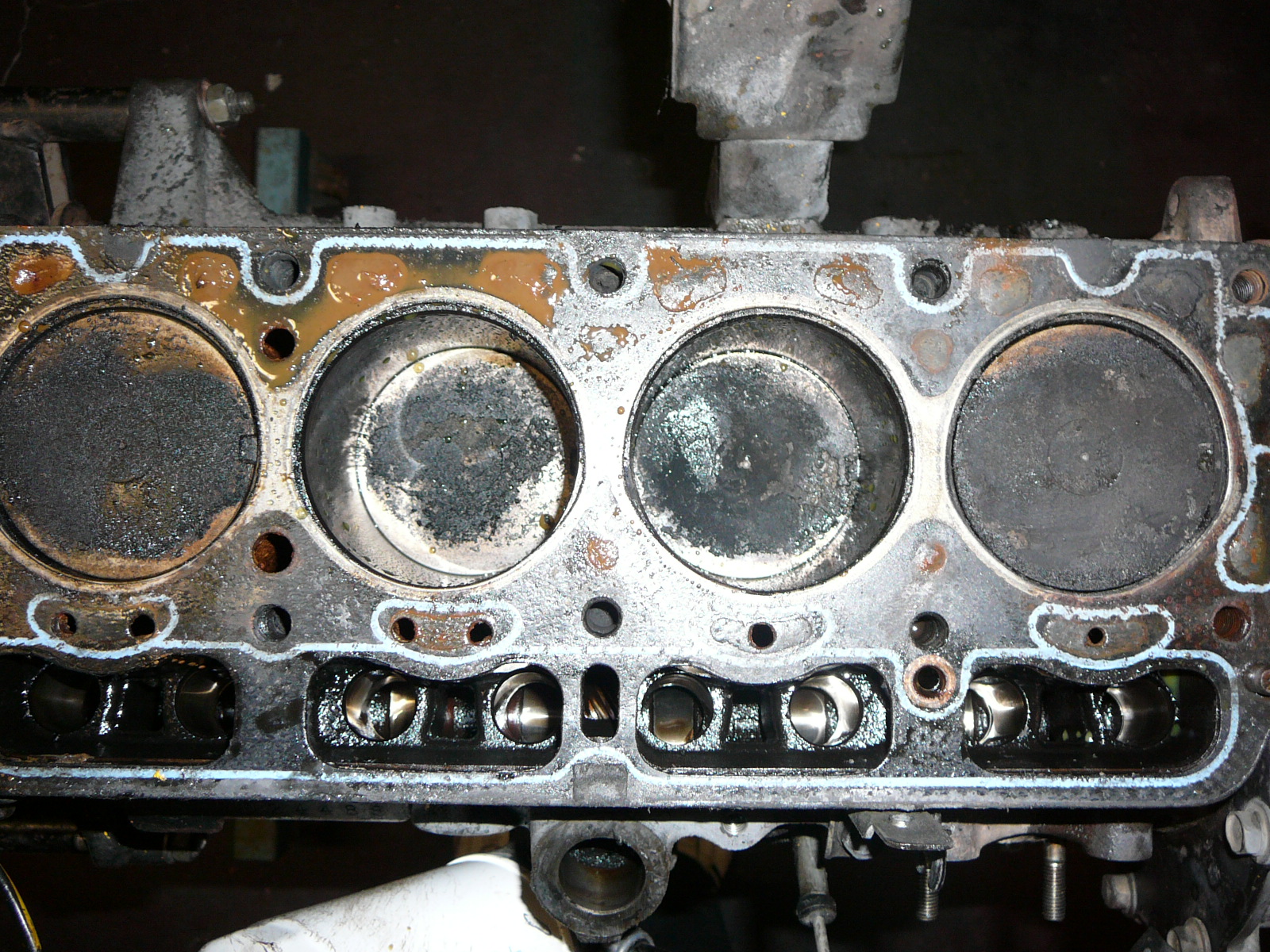

stripped the engine in a hour :bash:, found alot of metal on the bottom of the sump, what does the carbon build up around the valves mean? (i found valve saver in the glow box?)
post-8435-1271066585_thumb.jpgpost-8435-1271066349_thumb.jpgpost-8435-1271066392_thumb.jpg

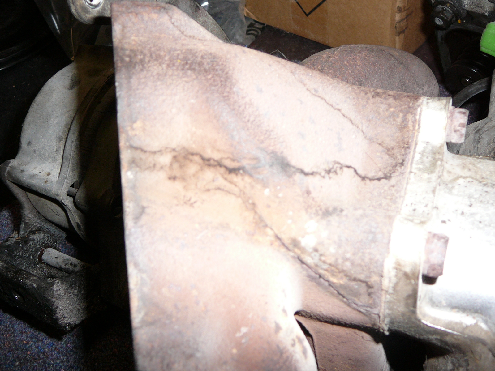

cracked manifold? all the bolts for the manifolds were loose!
gonna throw the gearbox in the hot wash at work tomorrow, order the input shaft bearing/input/output seal
