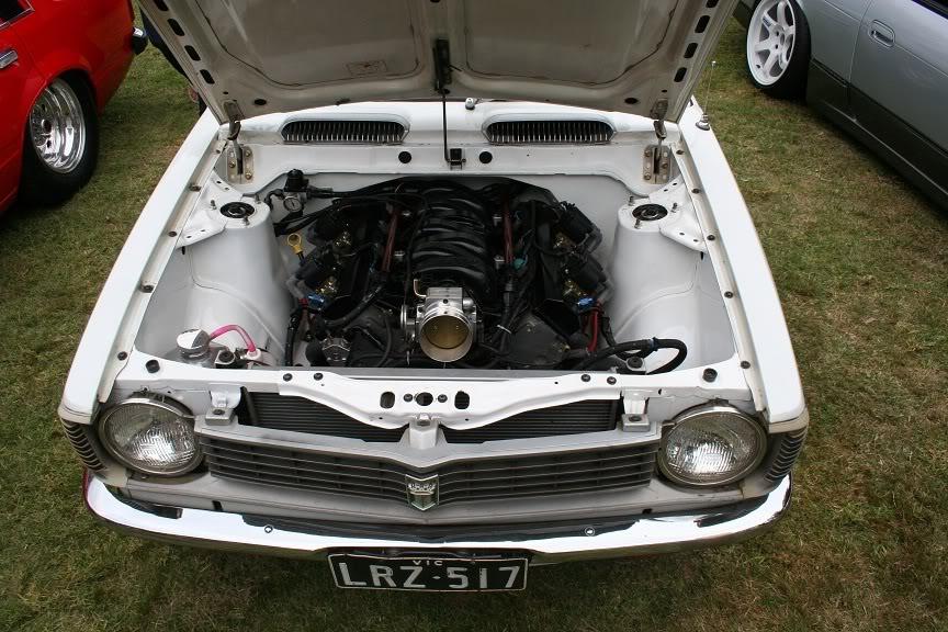

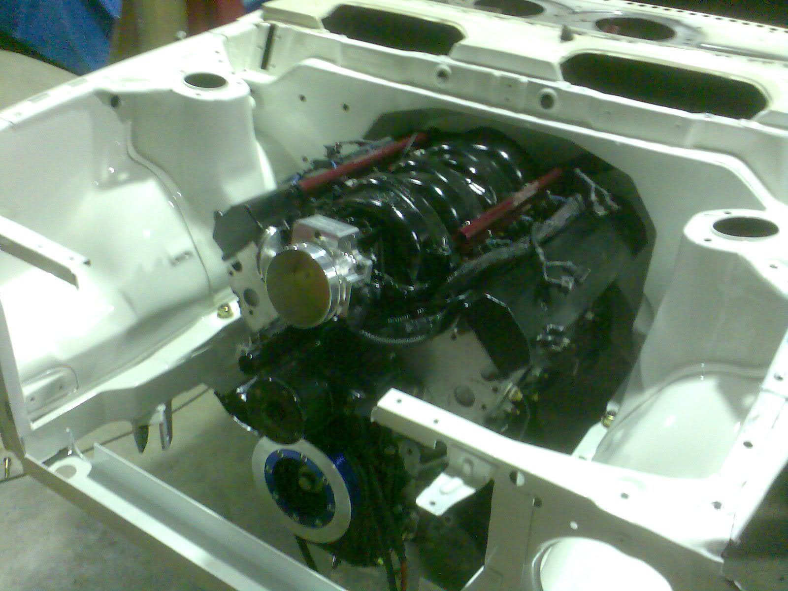

New member, noticed you has a engine conversions section, thought I’d pop a couple of pics of what can be done if you put your mind to something, stop talking about what might be a good idea and just pick up the angle grinder and start cutting. :blinks:
Took me two years.
Ls1, power glide, 4 link, 9 inch, molly cage, rack and pinion, 5 stud…. Fun times. Makes 300kw at the wheels aspirated.
Cheers,
Johnno

Awesome. Has it had a run down the 1/4 yet ?
Very nice.
I spot some aftermarket coils, have you got the original coil looms still?
that looks friggn insane nice work man.... so when ya going to return that car to me :blinks:
Very nice.

ok I tottaly didn't see that coming, how does it handle?
Yeah overrated! Its got nice Nissan S15 coil overs in the front, rack and pinion, good brakes. You normally steer with your foot anyways...

your a mad c**t! love it sooo sooo neat
Droool... Just wonderful.
What happens when a Commodore and Camry get busy ?. Now we know.
And the number plates. So it can be registered ?.
I see nothing camry about this car.
That is an awesome ke20 you got mate :blinks: I looked into a ls2 for my ke36. But decided against it due to the fact that I wouldn't of been able to engineer it. If only I had the car and a shitload of money last year I couldn't got it engineered.
Can't wait to see more pics :jamie:
Neither Camry nor Commodore really. More a Chevrolet and a Corolla.
