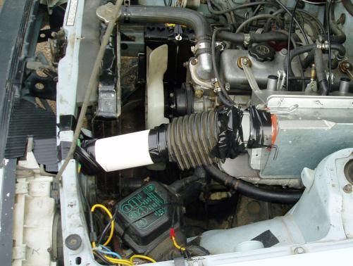

Arond town its no different, but this morning I got out into the hills around Ophir at 80-100kph and it was climbing hills at 16.8 to 1 mixture! So the extra air pressure leans it out too much at speed, which equals high exhaust temperatures and burnt valves. However easily fixed with the mighty SUs, I just pulled the choke out! :laff:
I'm happy to have it running down around 17 to 20 on over-run downhill, or cruising at 15 to 16, but I like it to richen back to 14point something when I slowly press the pedal going up a hill.
If you boot it the SUs always richen up, and its around 13 doing this, which is fine.
So I think I will put a pressure relief valve in the air box to stop the pressure pushing the petrol level down in the carb float bowls!

The simplest I can think of is to cut a hole in the top of the airbox and glue a rubber sheet over it as a flap, so I just glue the top edge. Where the yellow circle is.
When the car is stationary the rubber will seal the hole with its own weight, and it will be on the 'dirty' air side of the air filter anyway.
When its running over 80kph the air pressure will lift the flap and release the excess.
Its another one of those damm problems where I'd love to see under the bonnet while the car is running at 100kph, like watching the carbs to see if the pistons lift right up... I could cut a hole in the vertical face at the back of the airbox and hang the rubber vertically.

Overall I'm not convinced that I know why it leans out from the over-pressure, given that SU carbs regulate fuel by air velocity and they should compensate for it. I was thinking it must be pushing the fuel back down the jet, but that might not be it.
Maybe if I richened the top end of the needle it will run under a little boost quite well! That would make it too rich pulling the same 3-4000rpm in second as there wouldn't be the ram effect, but that's not really a problem.
Air velocity and air pressure are two different things. With higher air pressure you'd have more air molecules for a given volume, yet you'd still have the same air velocity through the carb. ie. denser air moving at the same speed, making it run leaner.
I'd be maybe looking into the blowthru variants of SU carbs (as in MG Metro turbos) and how they go about metering fuel for varying air (boost) pressures.
That's what I was thinking, I couldn't see how having the air push down the fuel level would be all the answer, as with higher pressure the piston lifts higher which exposes a richer section of the needle. Probably both factors work together, the piston lifts up and more air goes in for a given throttle %, and the mix is slightly leaner again because the fuel level is lower in the jet if the jet is now in +ve pressure instead of neutral pressure.
I'll try and get some clear pictures of the options tomorrow when we take it down to West Wyalong. I'll run it with and without the scoop, with and without a 20mm gap between the plastic tube and the rubber tube, and with both rich and lean needles.
