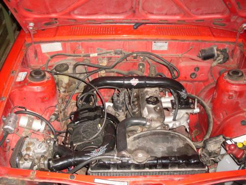

That looks alot nicer, i think my dad went over the top making sure it was 'sturdy' haha. He seems to be under the impression that there is less pipe that the air needs to travel through having it mounted on the left? Well thats what the guy at the supercharger place was saying :P Going to try make a new gasket on the weekend and see if that makes a difference.
Cheers

Oh no s@&t just noticed that. My top mount took 30sec to remove it's just two 11mm bolts for the t clamps and unplug the temp sensor. That bracket looks plenty strong maybe it could just be notched to give clearence for the oil cap.
Stu.
Haha, we made sure that there was enough room to take the oil cap off and the rockercover :P
Ah good to hear. It looks really really close in the photos.

Hmm.. something seems to be wrong with my engine. When I'm driving, it will start vibrating at ~3000 rpm, then stops at about 3500? not to sure. Once it has past the vibration point, it the supercharger seems to start working propely, as in you can hear it and feel it. Anyone know what the problem might be? I'm thinking it might be the flywheel?
Hopefully going to swap back to the 3k engine and see if it still makes the vibration and go from there..
Cheers

After much fiddling, we swapped over the head and put the 4k on to lower the compression. Now there is no more vibrations and it runs alot harder haha. Contemplating the idea to buy a cheap ke70 and swap the gear over and make it 'fulleh sick'..hmm..
