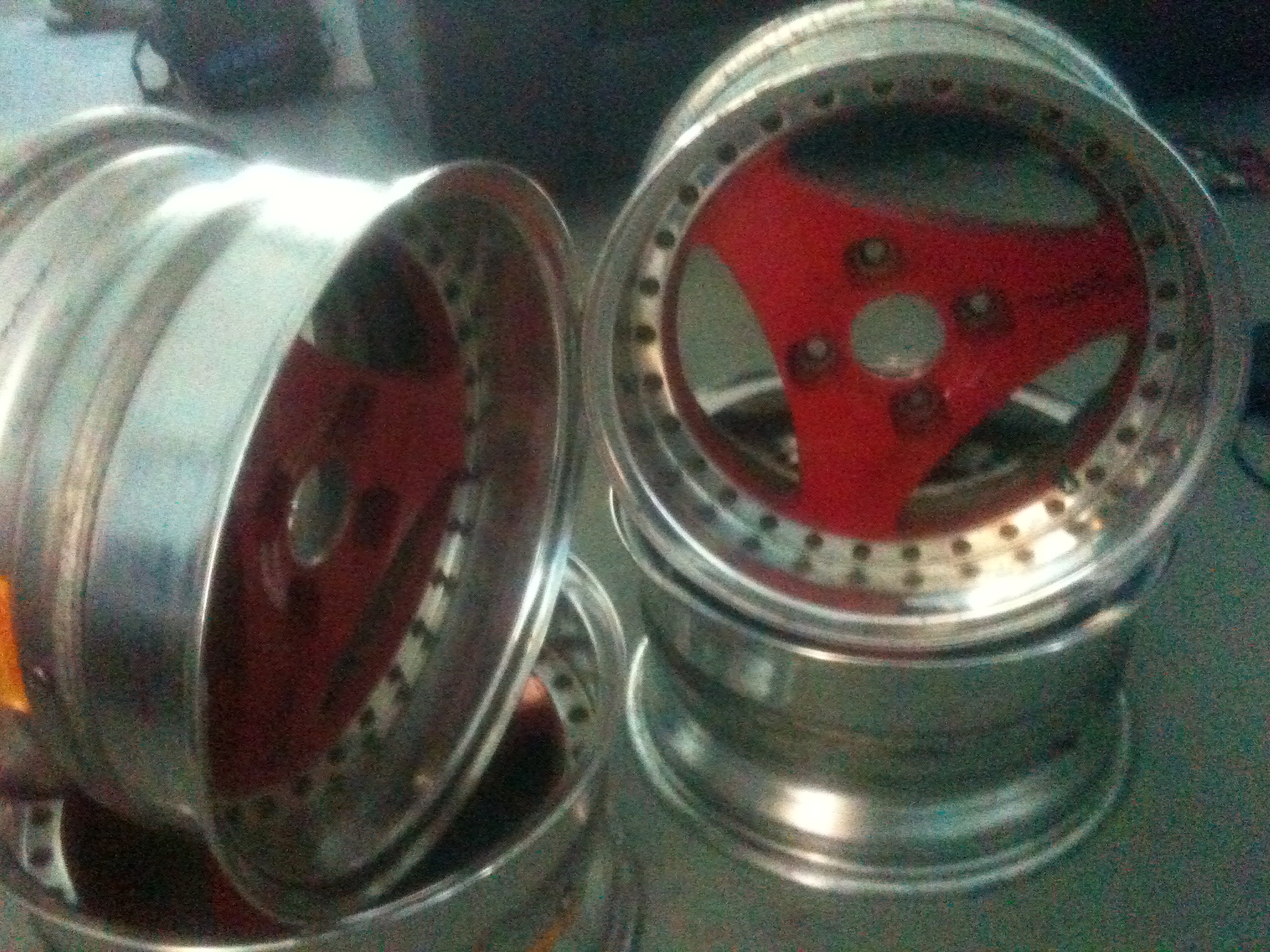

R31 Silhouette 15x6"? They look good. Just needs Chrome Dress Rings, and some low. :)

These rims are purely for rolling around on. I cbf'd pretty-ing them up. On that note, I believe there is some strut rub, so I'll chuck on a 3mm spacer.
