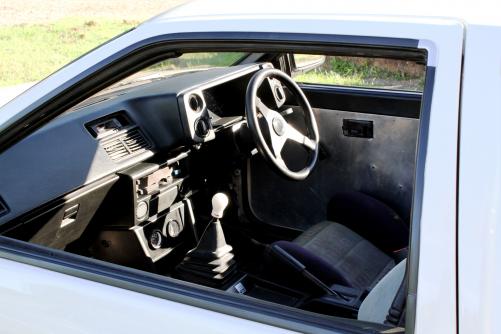

Interior:
-Velo drivers seat
-Nardi wheel
-TRD resin gear knob
-stripped interior
-Cusco 5 Point half cage
-Speco electric oil temp gauge
-Omori mechanical oil pressure gauge

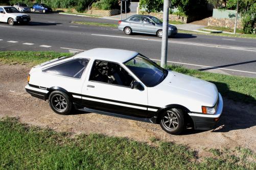

and the latest picture after wrangling with a semi trailer...
actually went down to the smash repairers today to sort out some issues and good news is that the car is well on its way to recovery. brand new front bumper, lights, parkers, bumper mounts, brand new steering rack and tie rod ends, couple of welds on the chassis rail (more on that later 0_o), another LHS guard, paint bonnet, guard, door, rear quater bot bumpers and mirrors.
