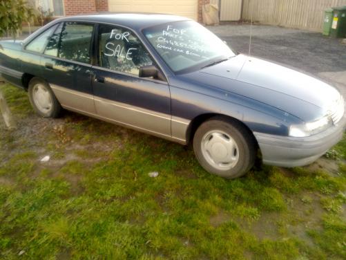

I considered turning my sedan wreck into a cab chassis but gave up on the idea.
May have a bit of fun with it though once I part it out.

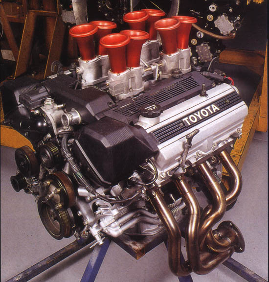

No he needs a......
post-10684-084305500 1302765145_thumb.jpg :dance:

+1 for the 1UZ aswell
