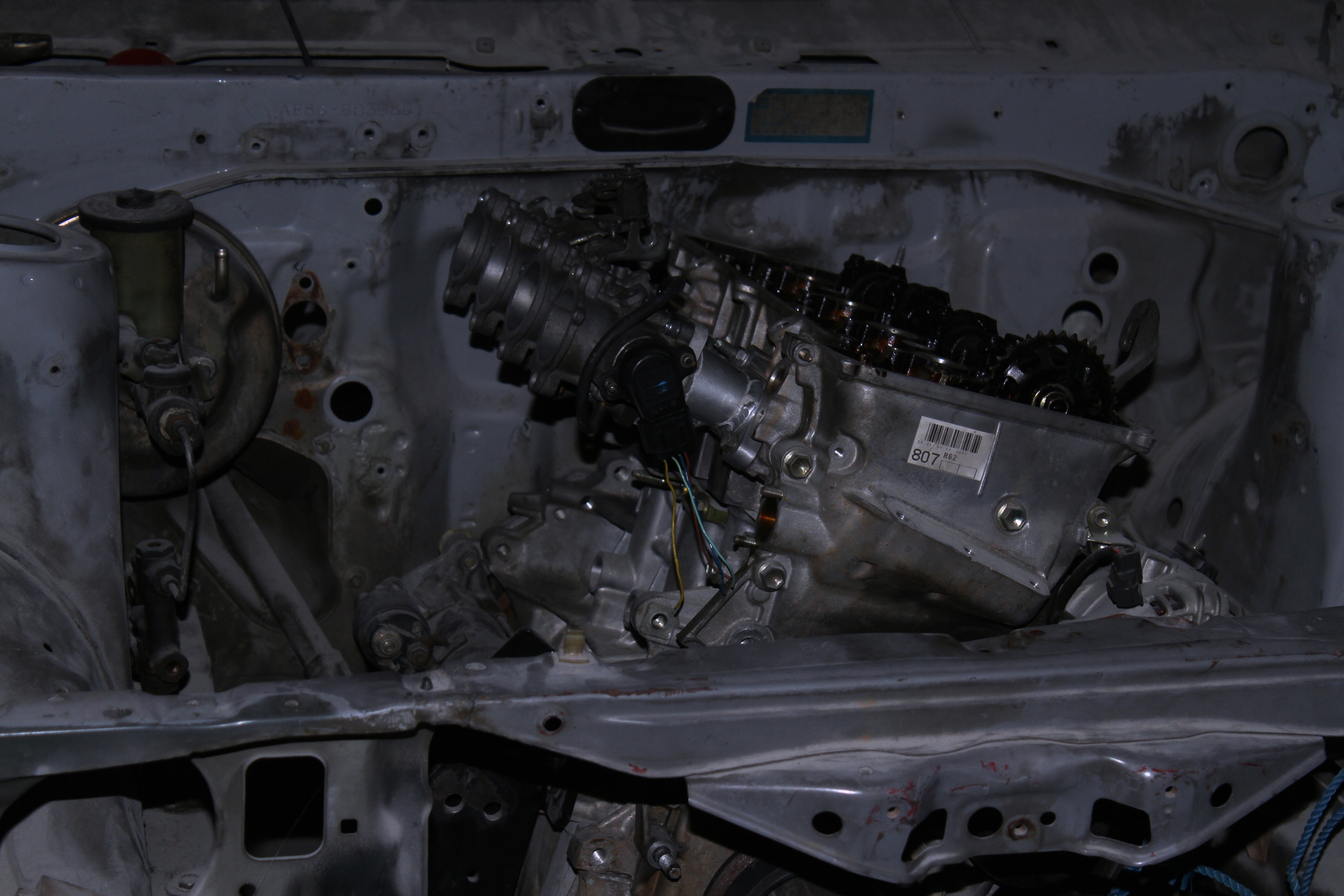

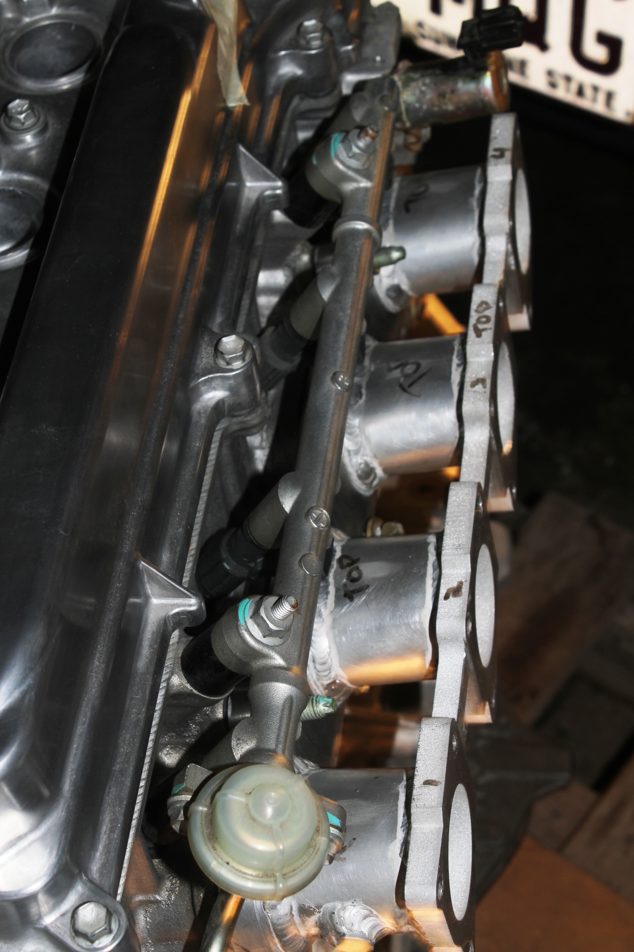

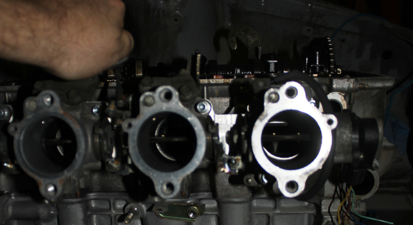

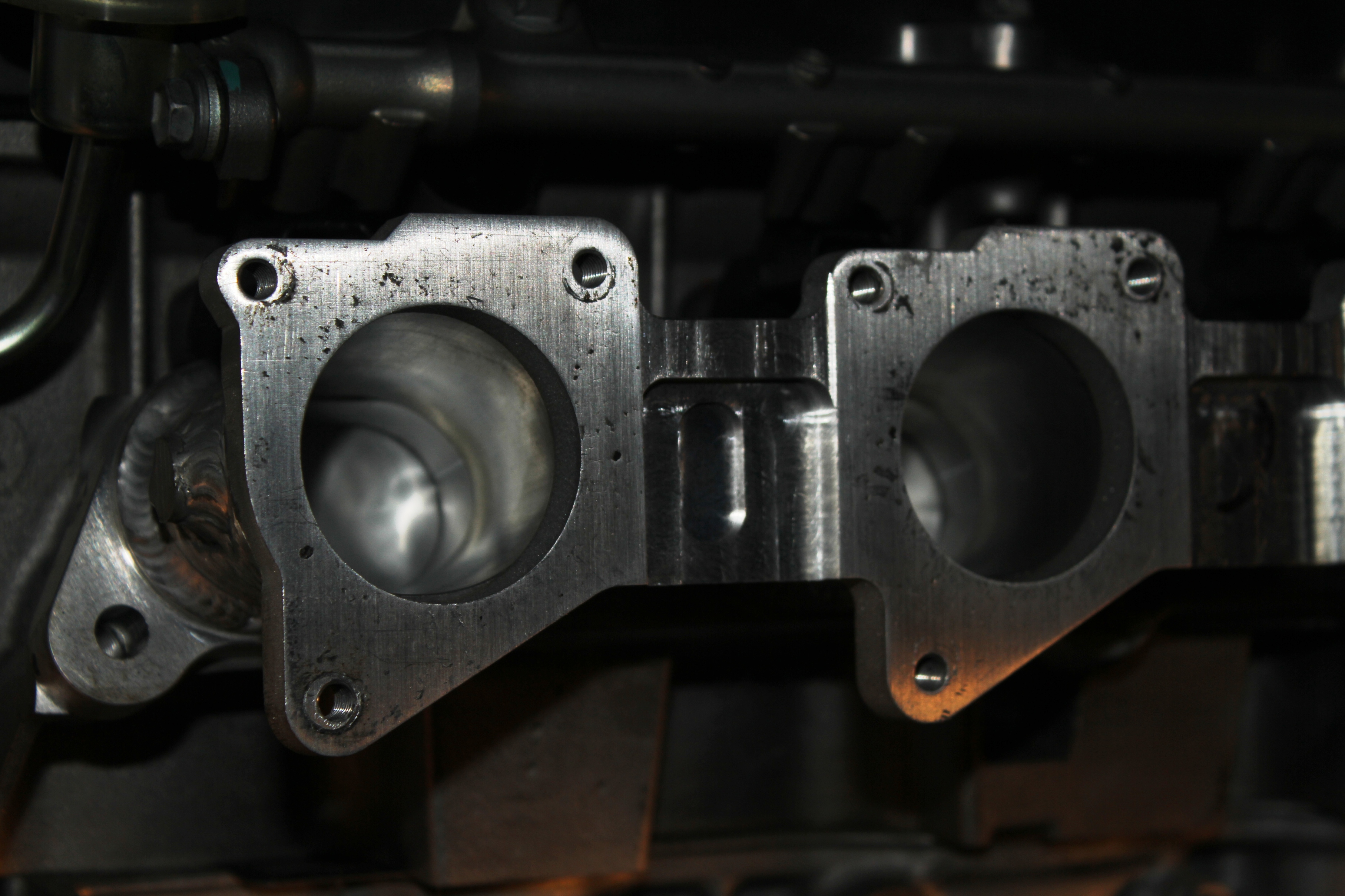

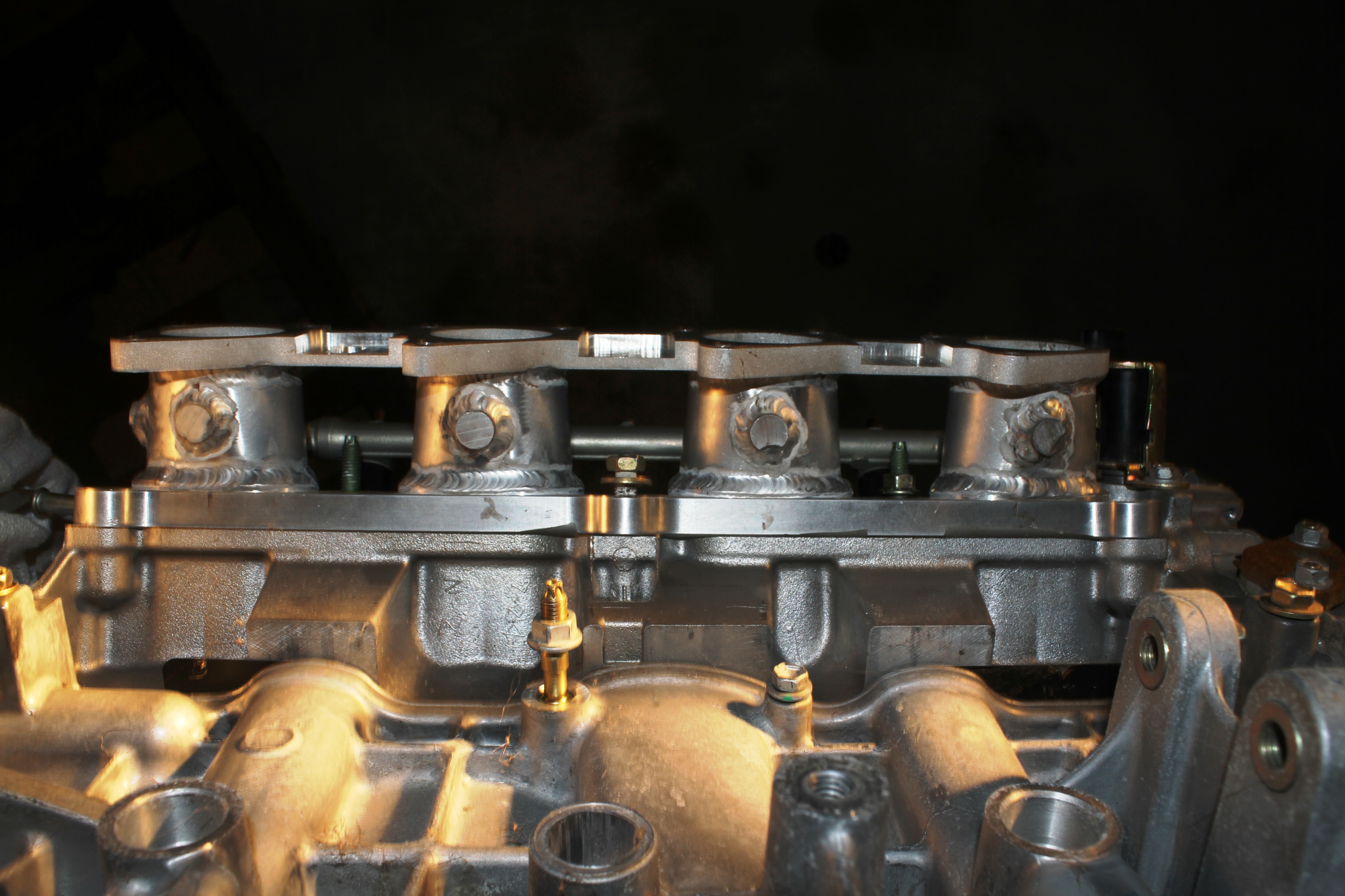

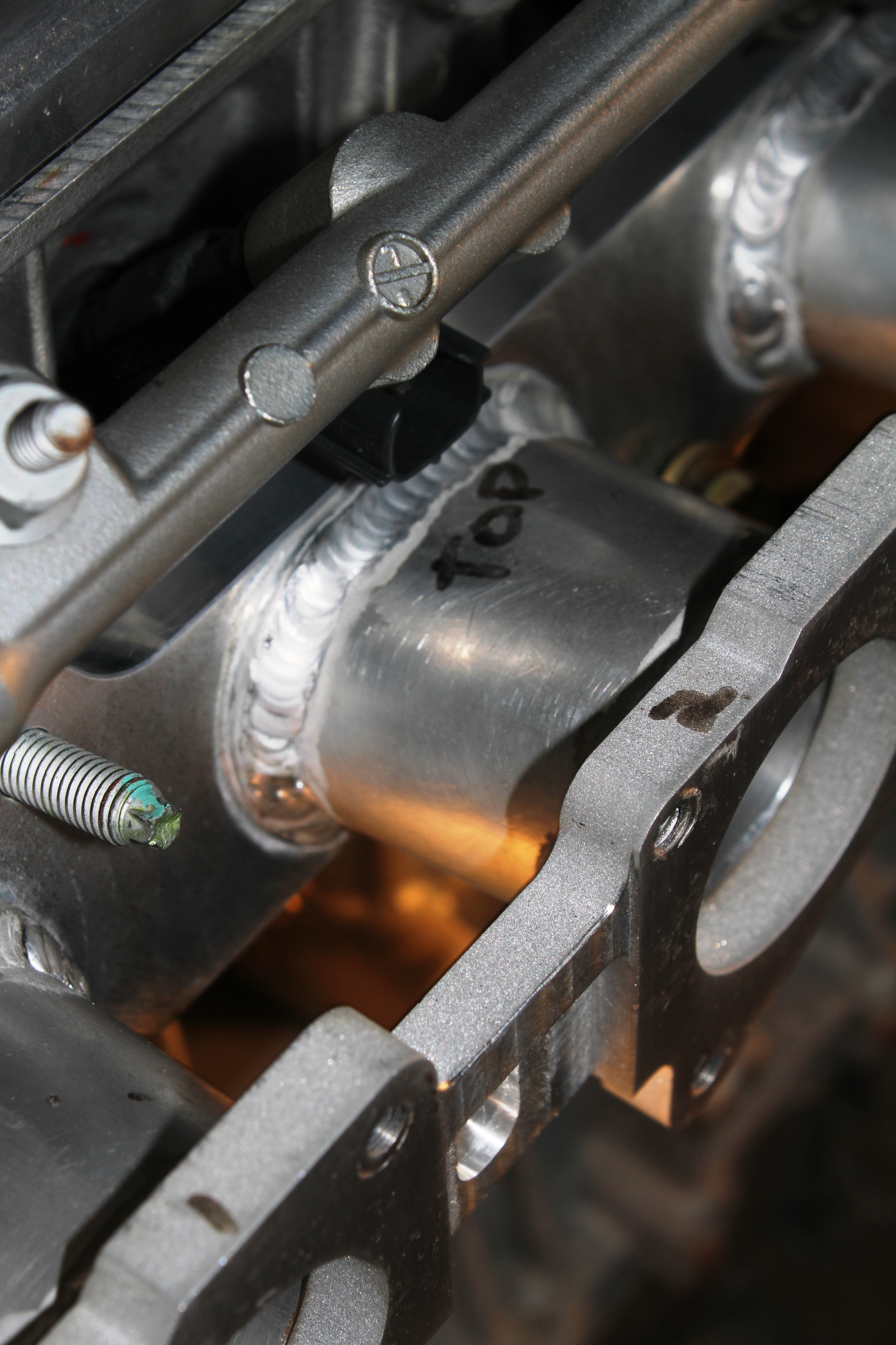

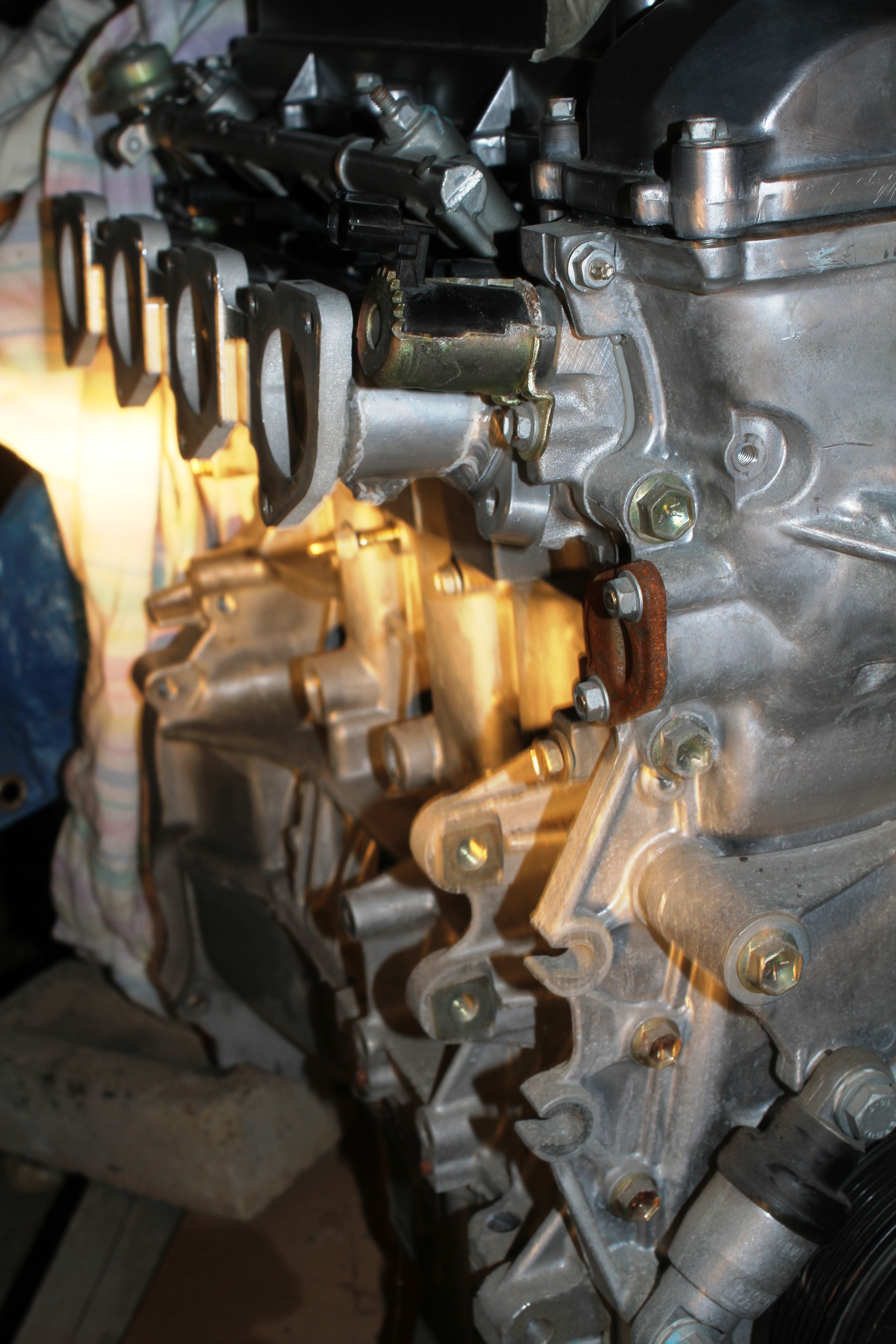

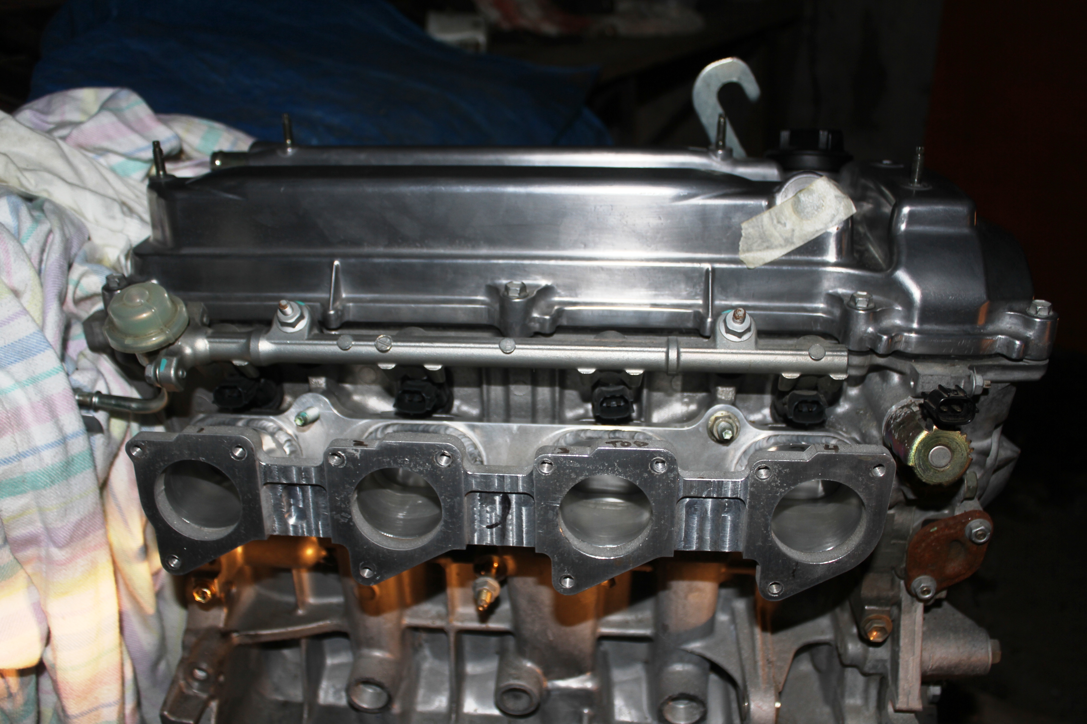

Just got the manifold back, it has very little warpage. :laff: :rolls: I'm super happy with it, now I need to face and seat the tabs I had added for vacuum nipples and the booster port, and drill and tap their holes also. Welding looks good, there's a few minor pinholes but hard to avoid in alloy, but importantly, it seals air tight and the welds look hot. I'm gonna polish the whole thing once I face the throttle side lightly on a linisher. The engine side needs no linishing really, it has about a 20 thou twist that should seat itself when bolted down and the oring will seal a treat.
all sounding good mate, when do you hope to have it all up and runnning?
Be a while yet I think. Just taking each step slowly and with lots of planning.

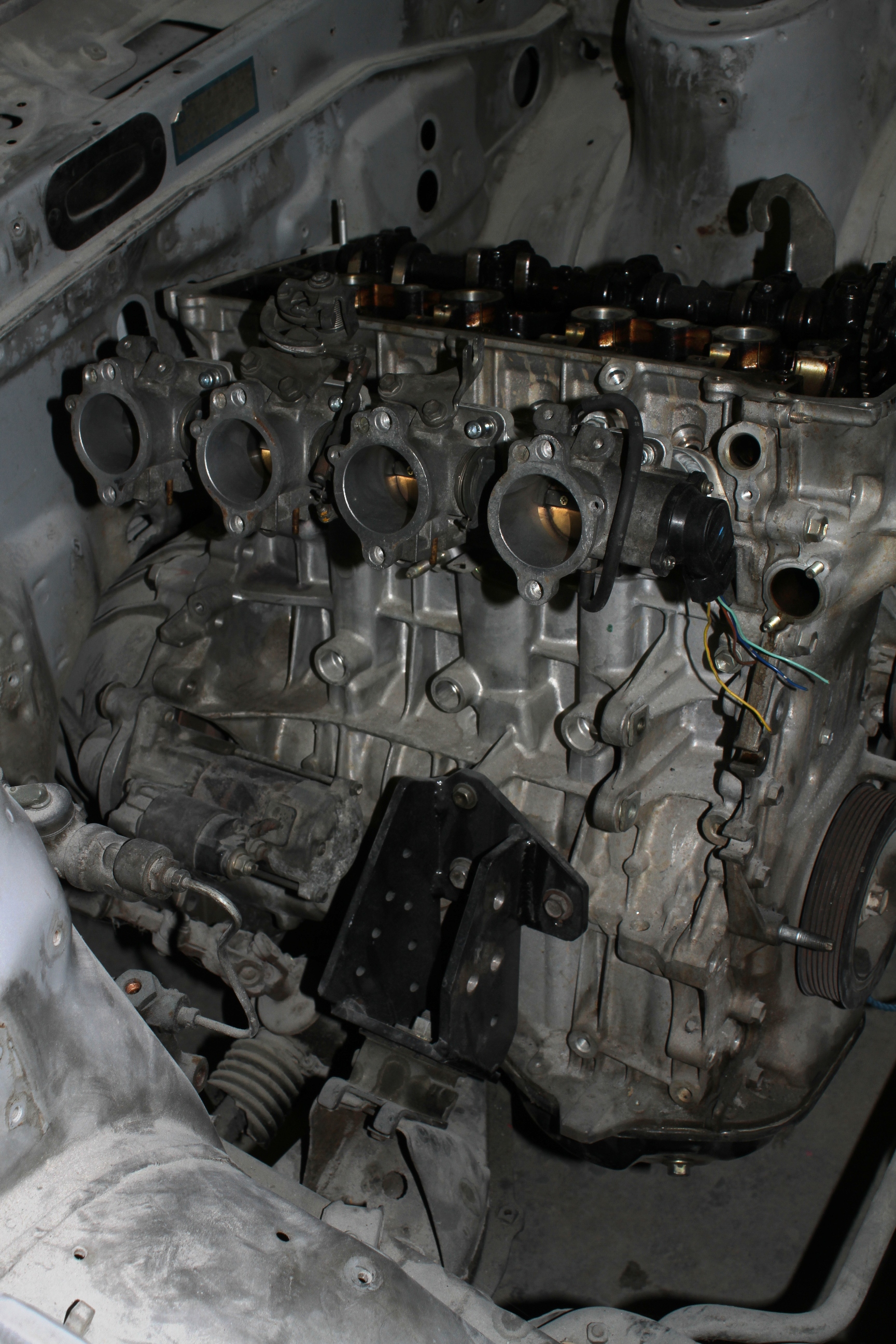

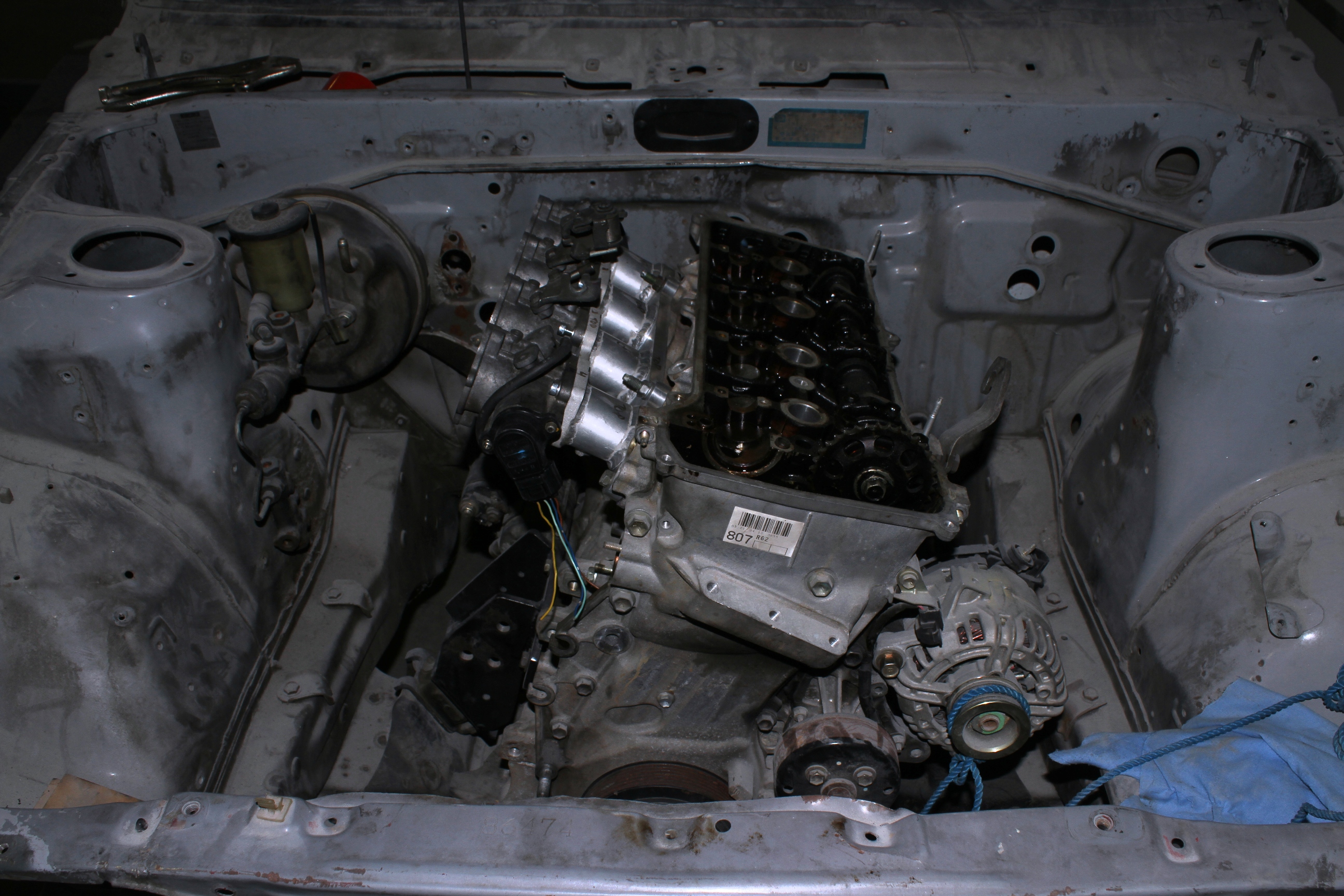

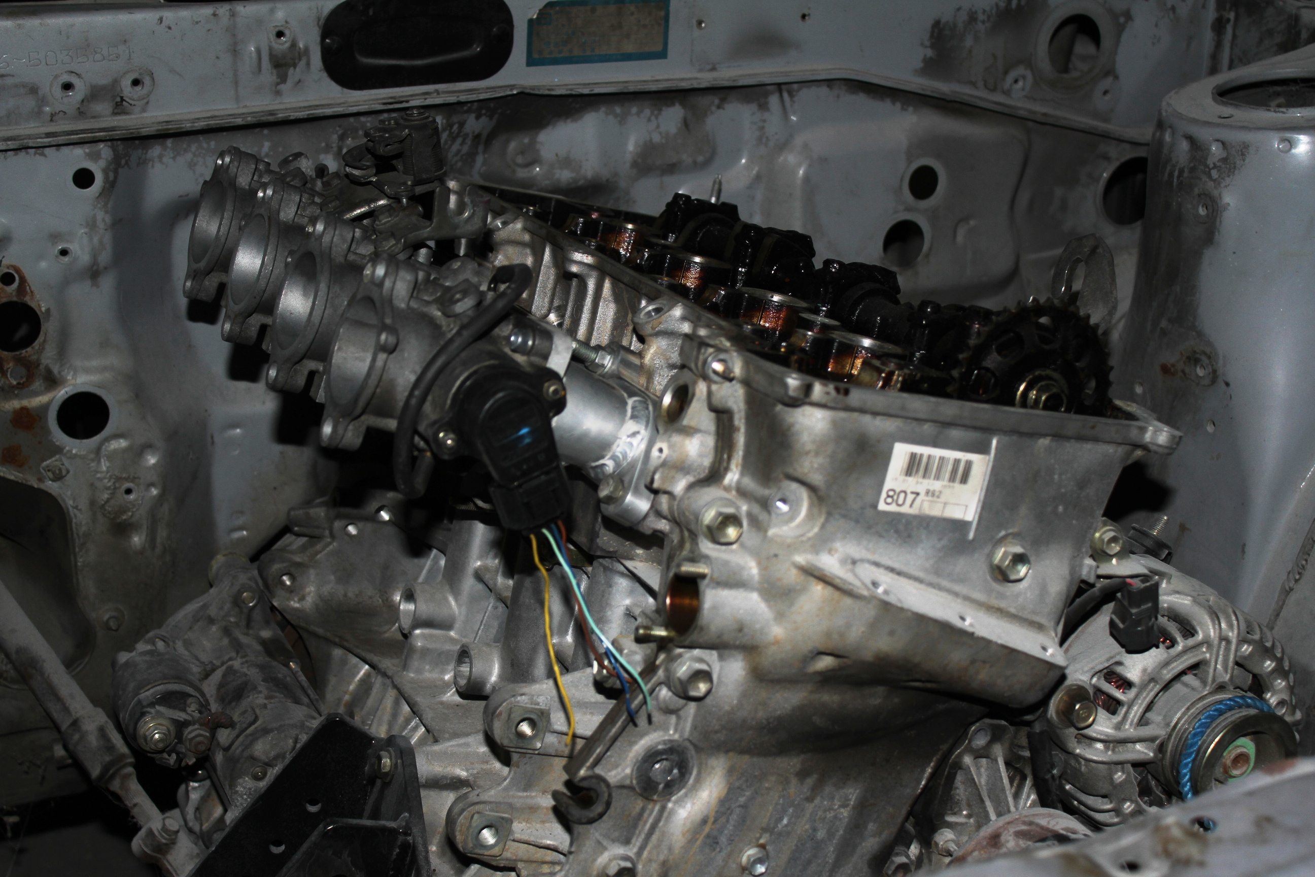

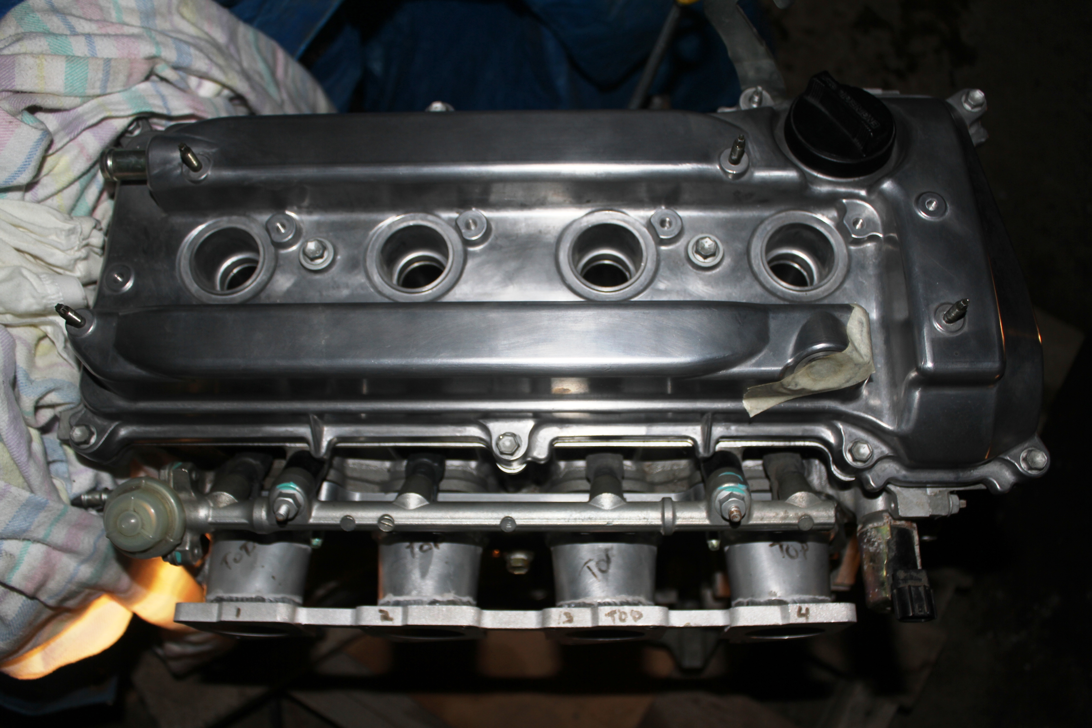

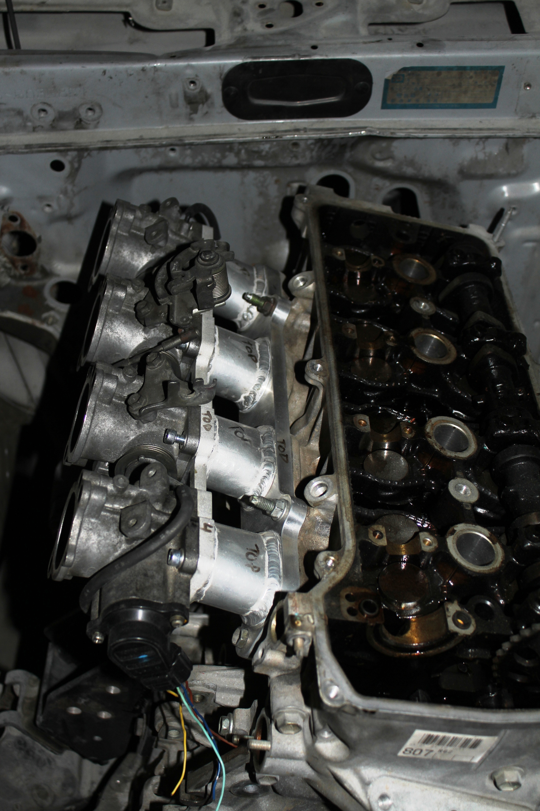

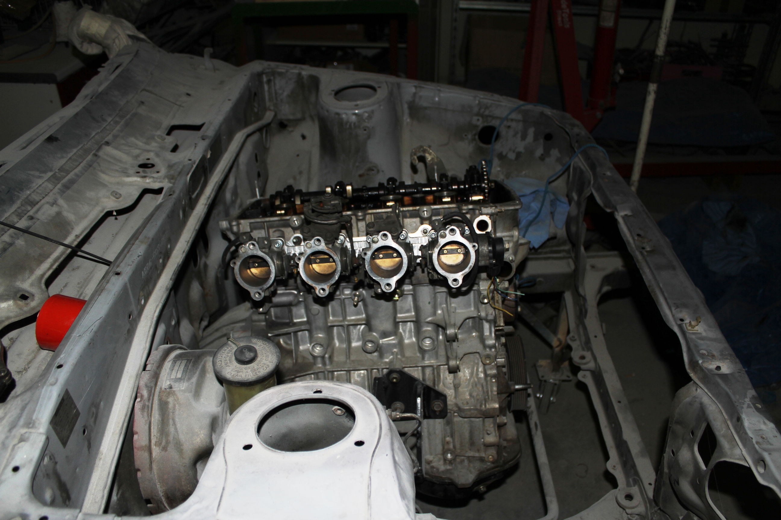

I'm very very pleased with this manifold. Its a fairly straight shot into the throttles, they point above the brake and clutch stuff, miss the fuel rail and allow ideal room for injector access. Also, it misses the VVTI solenoid handily, sticks out just far enough and looks hot like the rest of the alloy engine and head. The welding looks pretty nice, and you can see the little platforms I had fitted for the bungs to go to vacuum brake booster and the custom vacuum manifold I need for a map sensor.
I might initially just get it running with some stock trumpets and make a simple box. I really want it to be quiet and not sound like it has carbs or itbs for something different.
Enjoy the high res photos. and thanks to samq for the machining.
