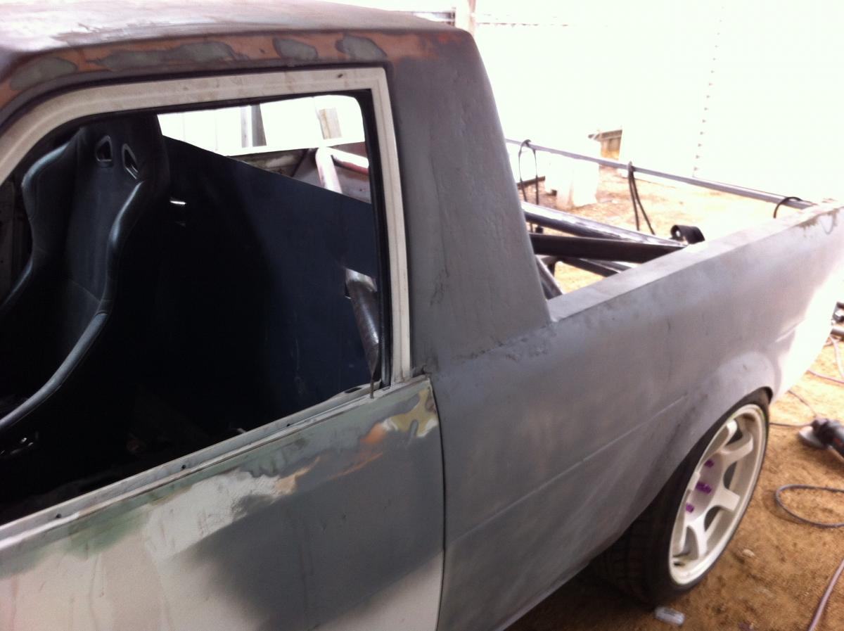

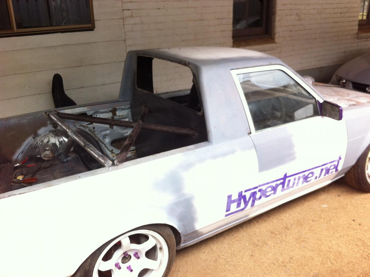

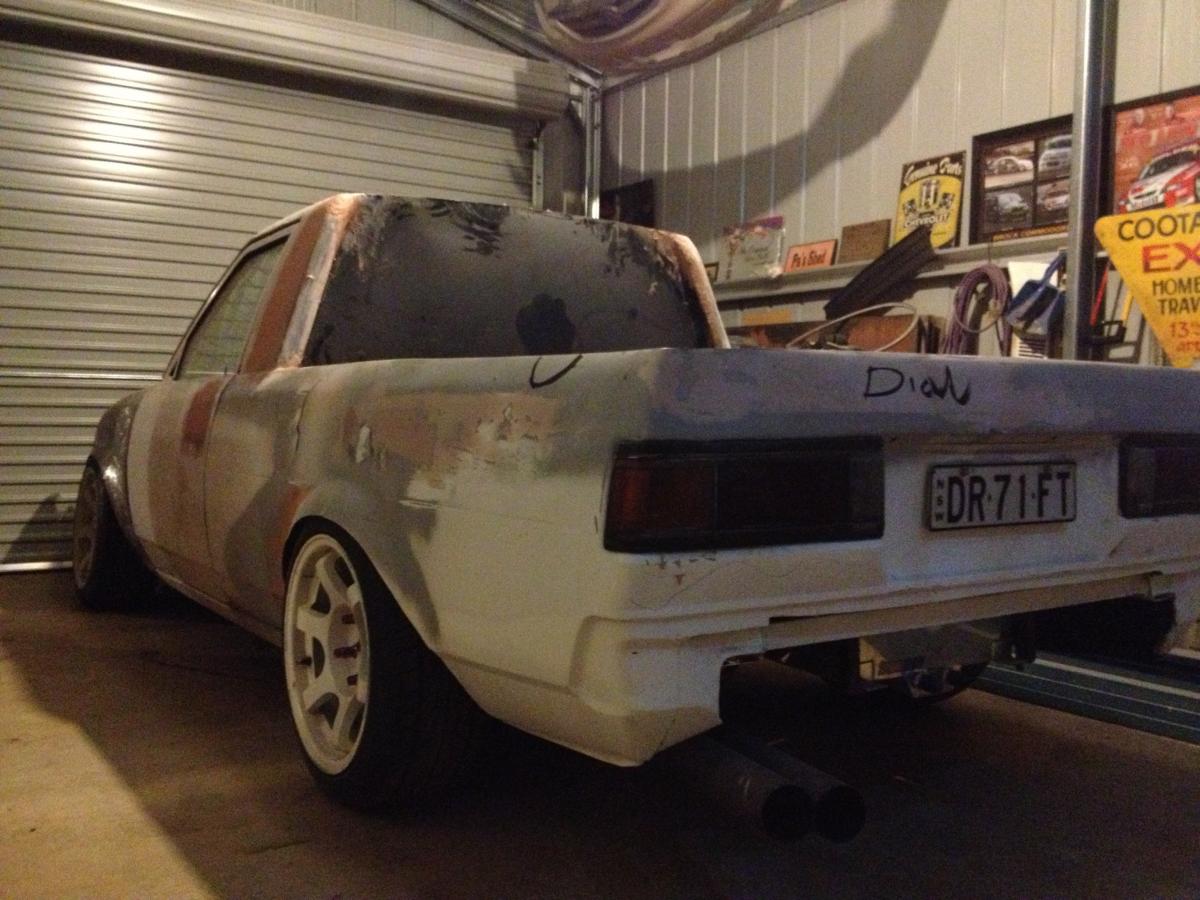

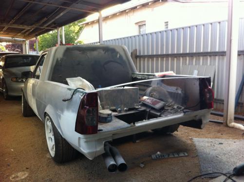

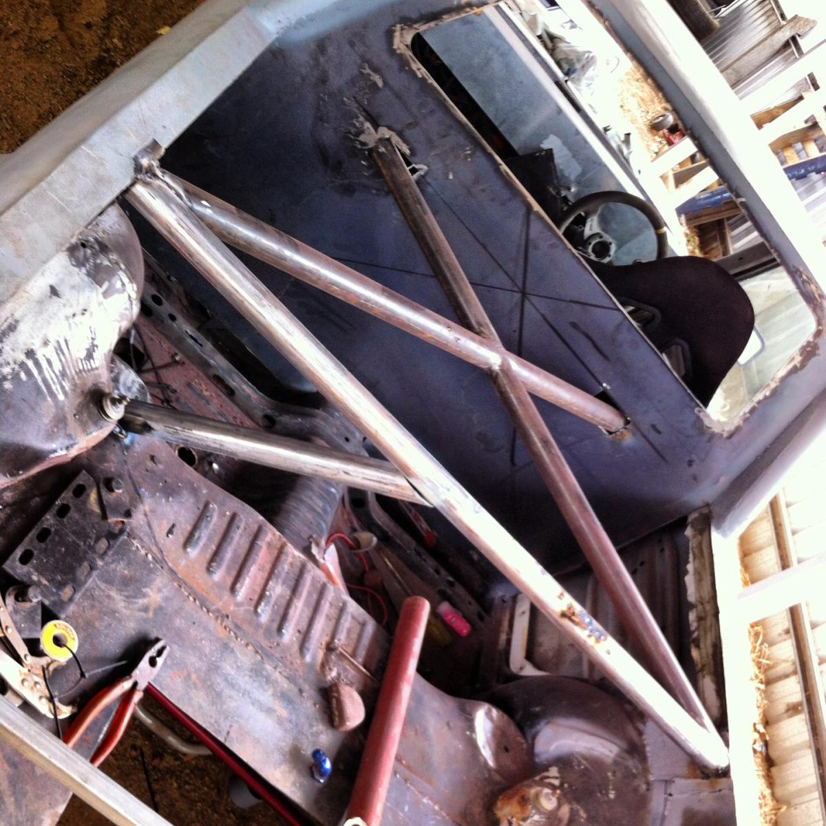

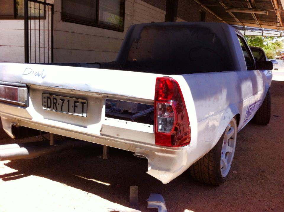

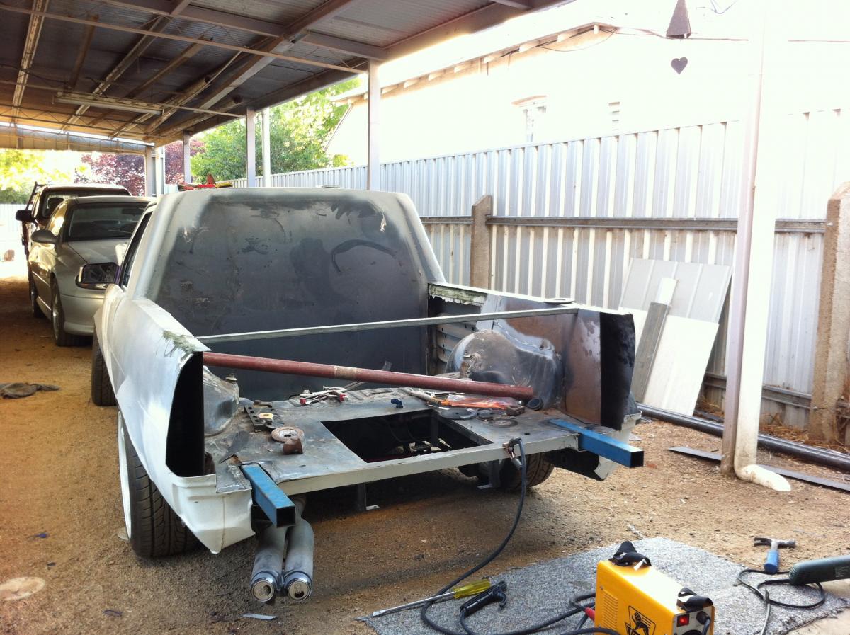

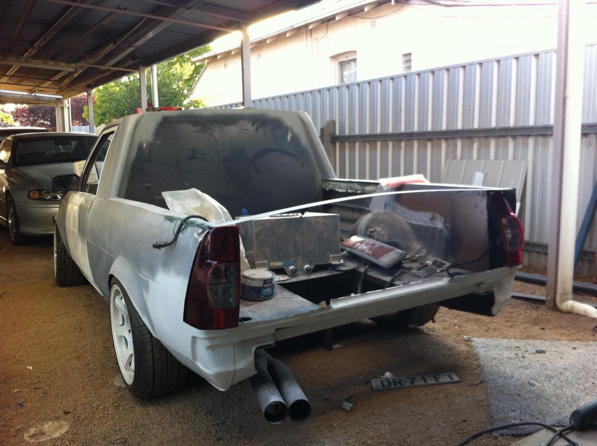

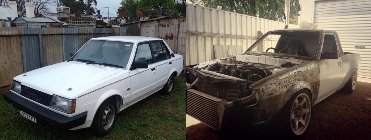

yeah its a bit crazy haha, found just the right size rods and the right amps so as it wont stick and wont blow holes, spent this week welding the bonnet to the cowl and fiberglassing it to make it one piece, going to be using one wiper from a hilux and modifying the motor and mechanism to have the arm swing 170 degrees.

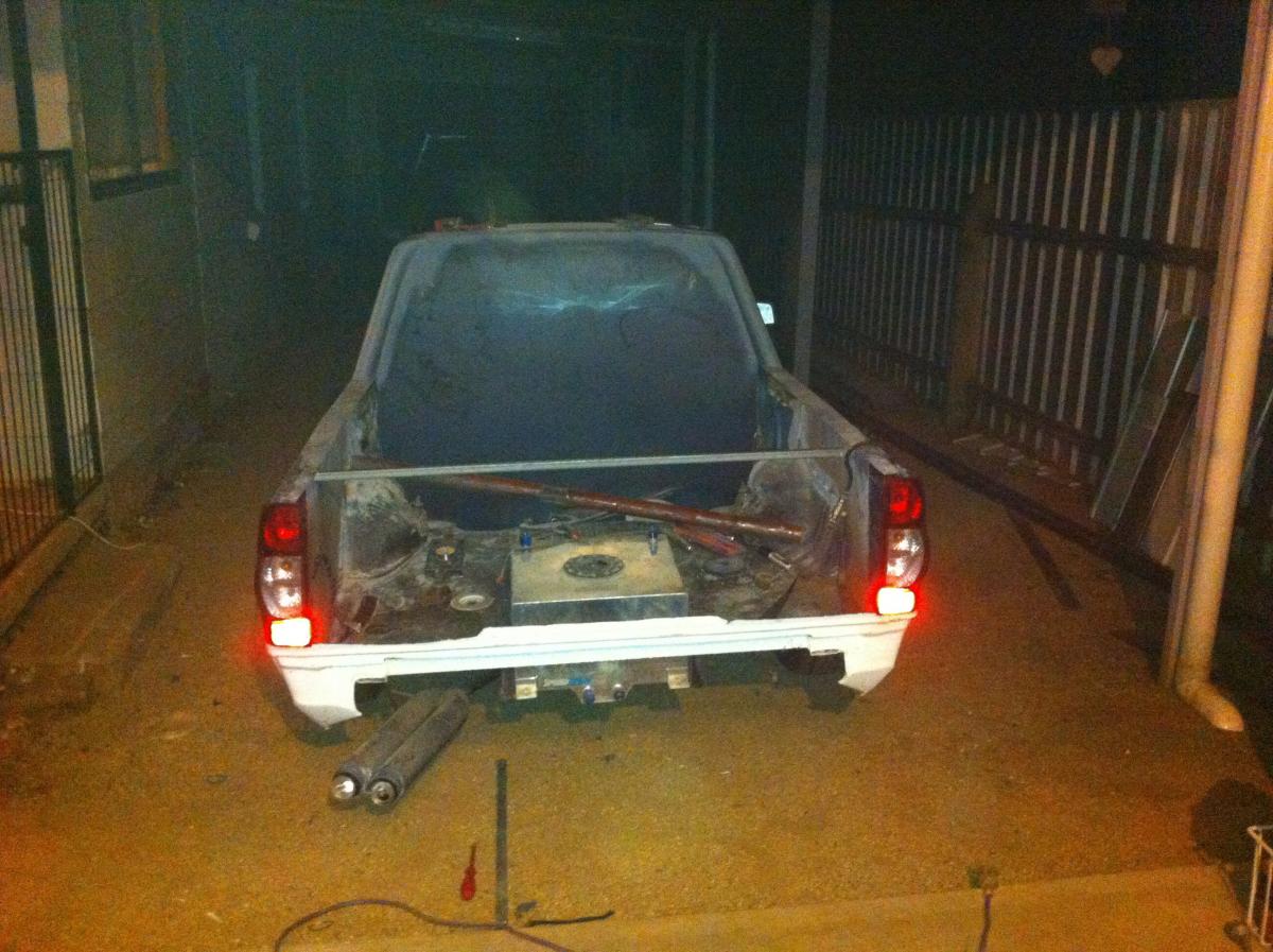

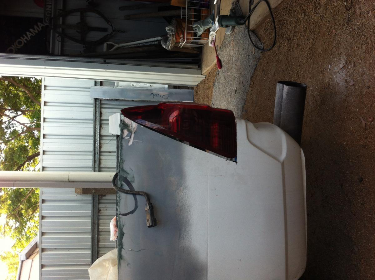

i need to stop spending so much time thinking about shit as i nearly took to the rear of the ute with a grinder to chop the whole rear end out and shape it similar to a datsun 1200 ute, with the corner lights etc
