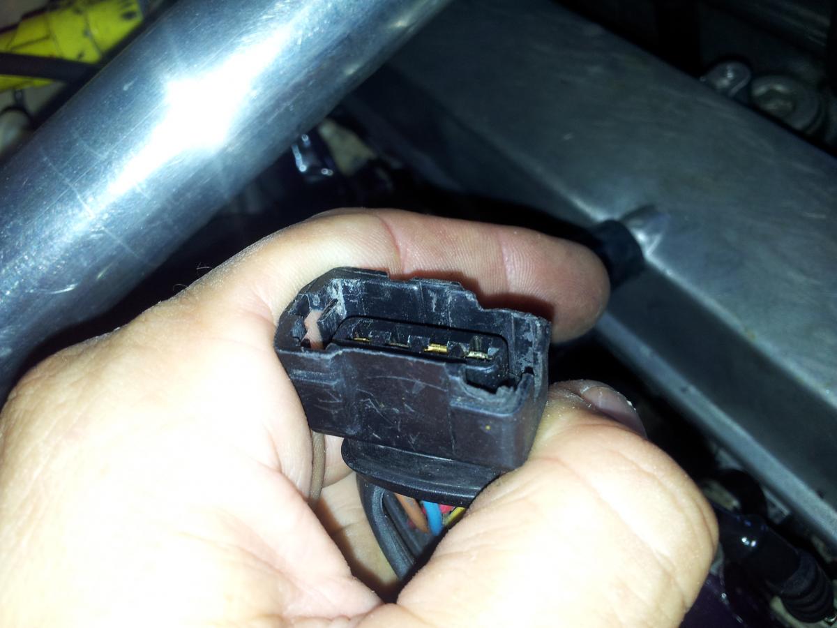

I checked the volts as per the service manual at the plug, it reckons I should have 0.1V at throttle closed to 4.5V fully open.
No matter how I adjust it I'm getting 0.2V-3.5V. Plus the plug looks like this:
So I'm leaning towards a bung TPS.

Very well could be the tps or its plug.
