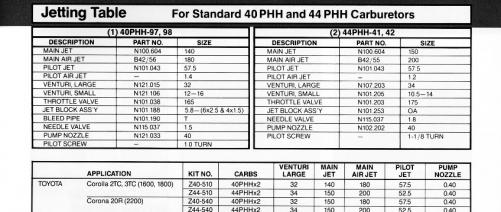

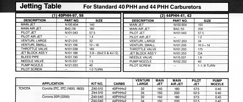

Ah- Can you post up the jets sizes for us? Might be someone who knows Solexes on here.
Air jet & fuel jet on the mains would be the ones, it might be really lean. ..and the 'choke' size in the venturi throat. I assume all 4 pump jets shot out fuel.
For Webers we'd be running 36chokes with 170 airs and 140 fuels or thereabouts.
http://www.rmcarburetors.net/Tuning%20Tips.htm
^ Listed on that page are the 2TG jet sizes.

Found a starter! buut i have 200 jets...?!?! and the smal ones are 57.5
i'v understood that it should be 180 orginal but the P.O told he used it daily and that would be impossible if it was running like this, ide is at 3000 aswell so i suspected air leak in the manifold, fixed that and havent startet it after that but what else could cause it to idle at 3000? where is the ide screw?
Edited by SM Hunter
Take those jets out & look at the bottoms. Those are the air jets, the fuel jets are at the bottom of the emulsion tube. Sit on Google and learn about (yet ANOTHER thing to learn about on cars..) side-draught carbs! Lots of Weber stuff on the net, most of which is similar.
The fuel gets sucked up through the bottom, the air gets sucked in down that 200 jet ad they mix in the emulsion tube. The air has more effect at higher revs, the emulsion tube has a lesser effect than the air & fuel jets, but all three can be changed to get the best match.

here's a starting point- (which I haven't read, I must confess, I just saw the jet pictures..)
http://www.ozgemini.com/forums/tech/viewtopic.php?t=19014
Gold!
It will run fine with these jets, not as good as it absolutely can if you have non-standard parts like cut cams or extractors, but good enough though- Idle problems are somewhere else, like leaks or throttles not set up properly.
