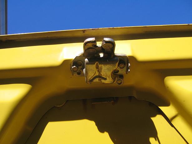

:jealous: -I've just created something today!!
A couple months ago I was at the wreckers and I bought myself a KE70 boot latch, cable and release lever. Today I marked out the new holes so I could mount it in place of the original latch.
I still need to thread the wire through into the cabin. As for the latch, i might end up searching for another lever. This one has a fuel tank lever too so i'll need to hack it off. Plus its bulky.
Jon.

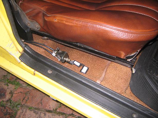

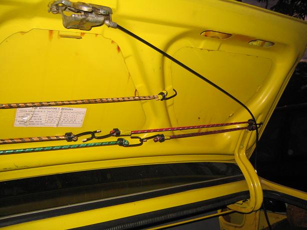

Okay, so after i did the boot release latch, i fitted the cable. Heres how it turned out:
Heres the lever. It still has the fuel door cable attached. I'm currently looking if there are any cars that had just a single lever. I don't really need a fuel release.
It also tucks away behind the panel between the two doors. My panel beater today told me he could weld me up a bracket for it to fix onto since it is currently loose.

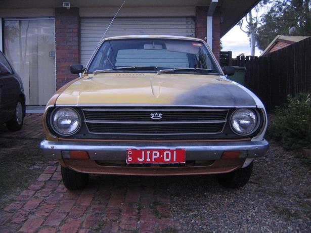

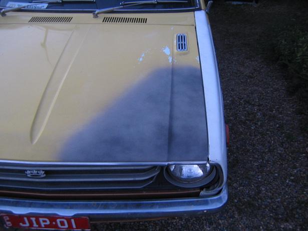

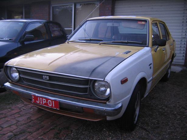

So today i got my car back from my panel beater.

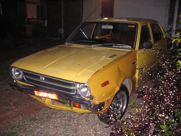

Heres how she was before:

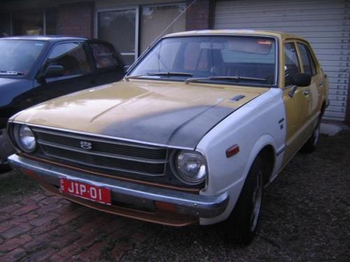

And Now.
Heres the repair on the bonnet
The side view with the new apron, bumper and grille. the bumper is yet to be polished up.
I had two choices of aprons. One early KE30 one and the late KE30/KE55 one. I chose the Late KE30/KE55 one cause i like how it flares out in the front.
Now lastly, a front on shot. Before Lolla was just 3 colours, now she has another 3. She's Yellow, Baby shit (Mustard), Gold, Grey and now White.
