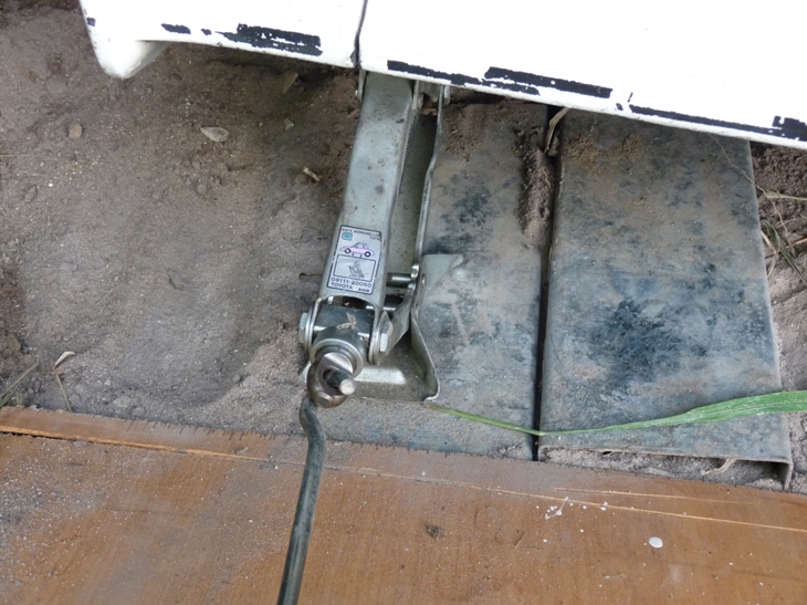

This weekend, I have to do the mowing, put the round tyres with air in them on... and push the car out onto the mowed lawn, get the scissor jack under it and jack it up and put it on axle stands, get under it and drain the fuel, wire up the TPS sensor, swap the 3ETE injectors to 4EFTE ones, swap the injector plugs to 4EFTE ones, finish other ECU mystery wiring, and hopefully have the car ready to fit the loom and maybe a test fire up the following weekend.
Couple of progress pics:
Jacking the car up, I used these steel plates under the jack, worked a treat.

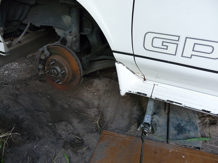

I'm going to need a bigger jack to put the axle stands under the car.

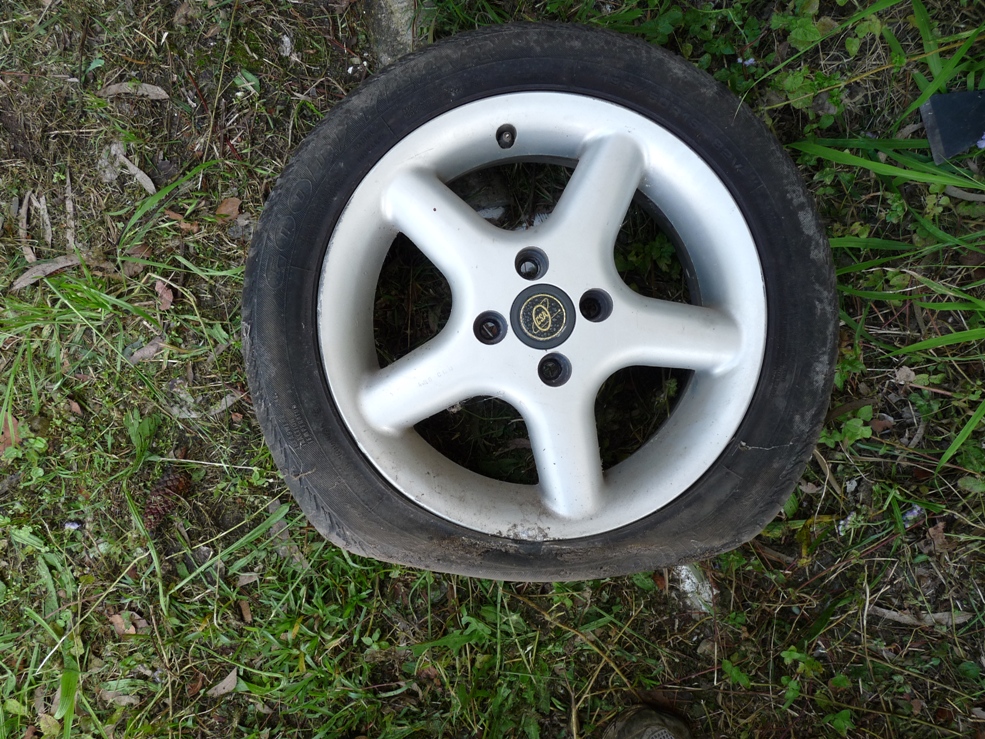

If you were wondering why did I swap the wheel, here is the answer:

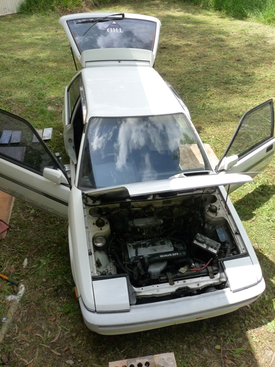

Finally I have some room to move around and I can air out the car, Maxi doesn't look to bad after being in storage for so long, still nice and shiny.
