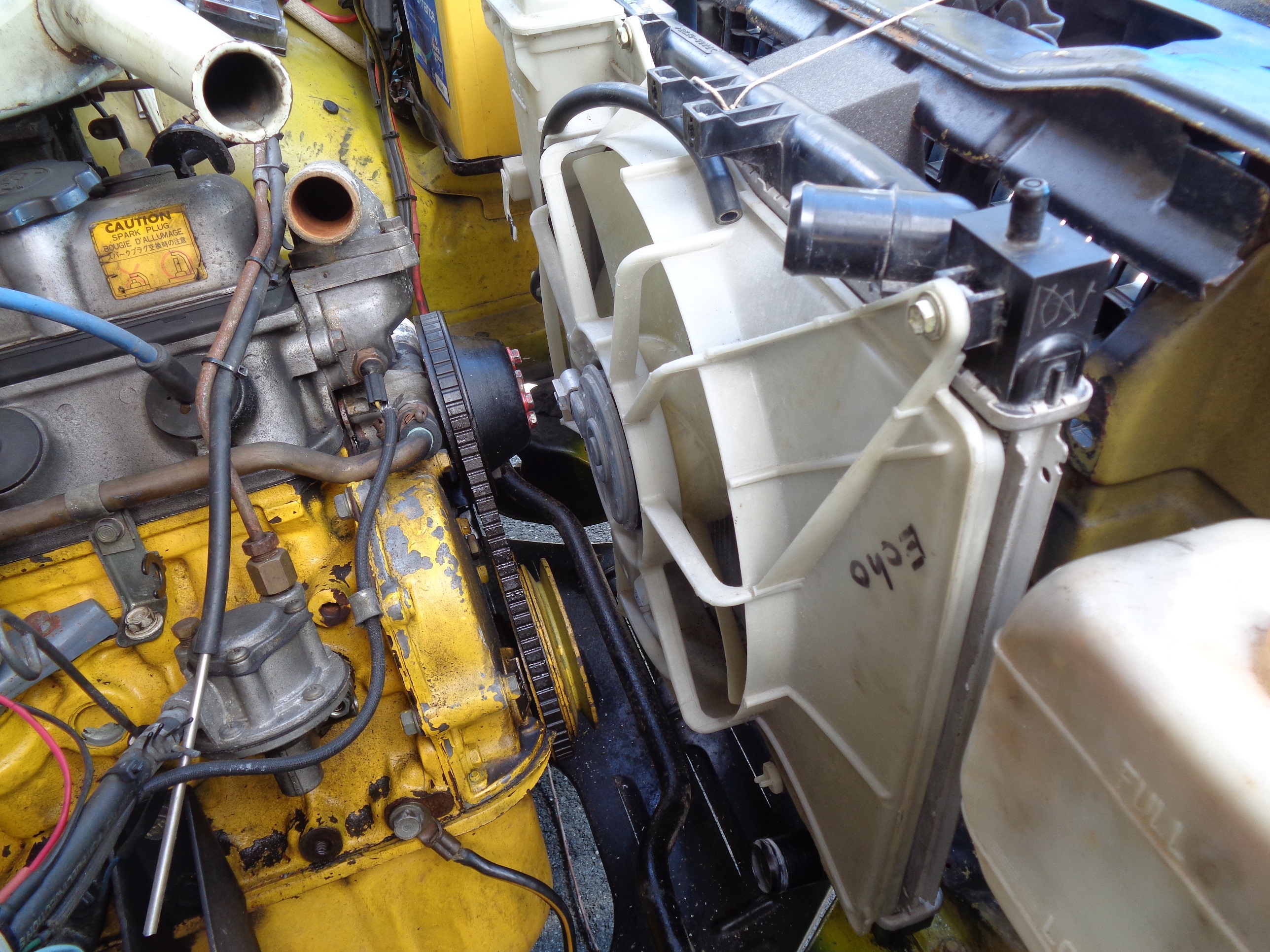

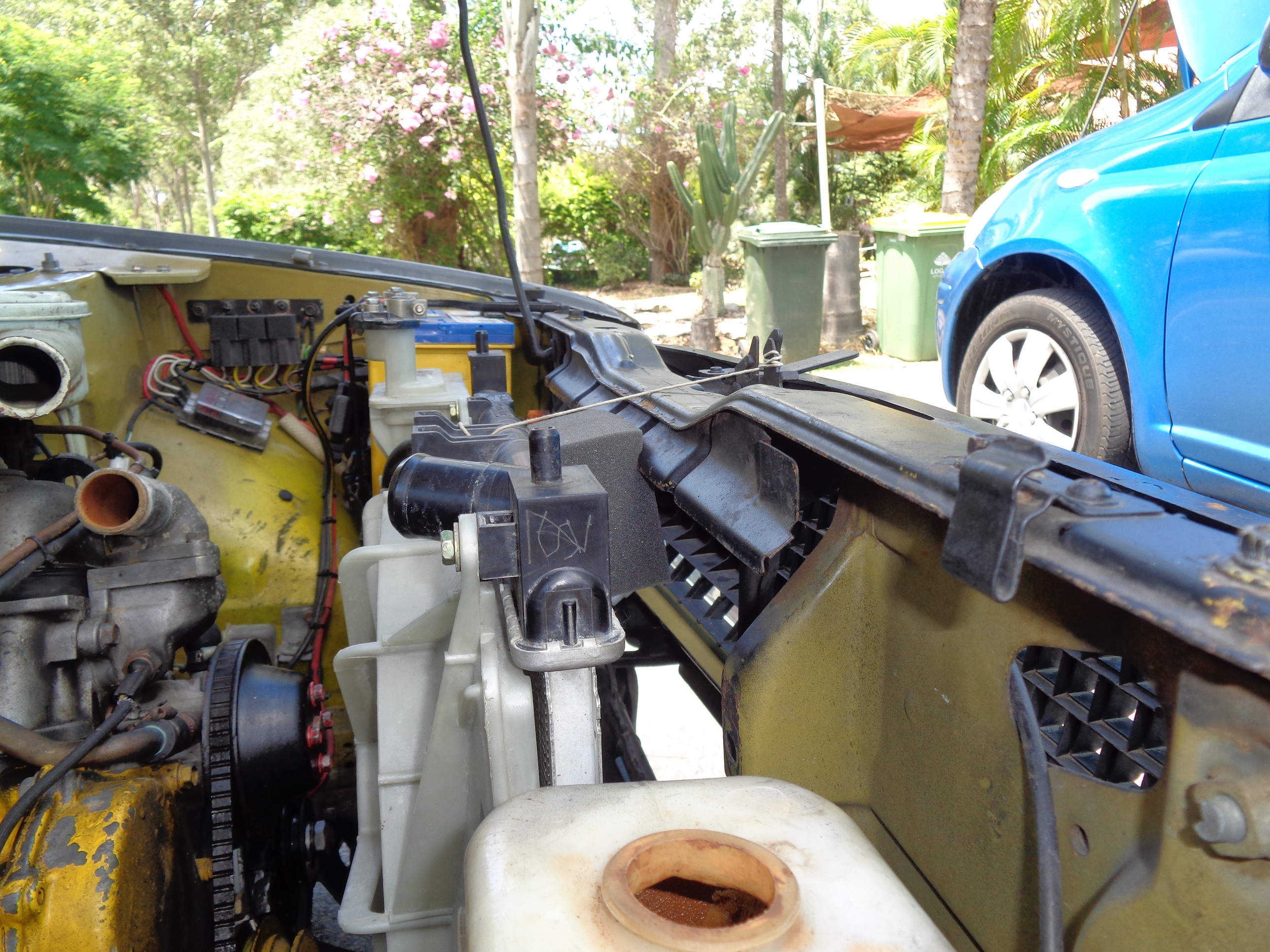

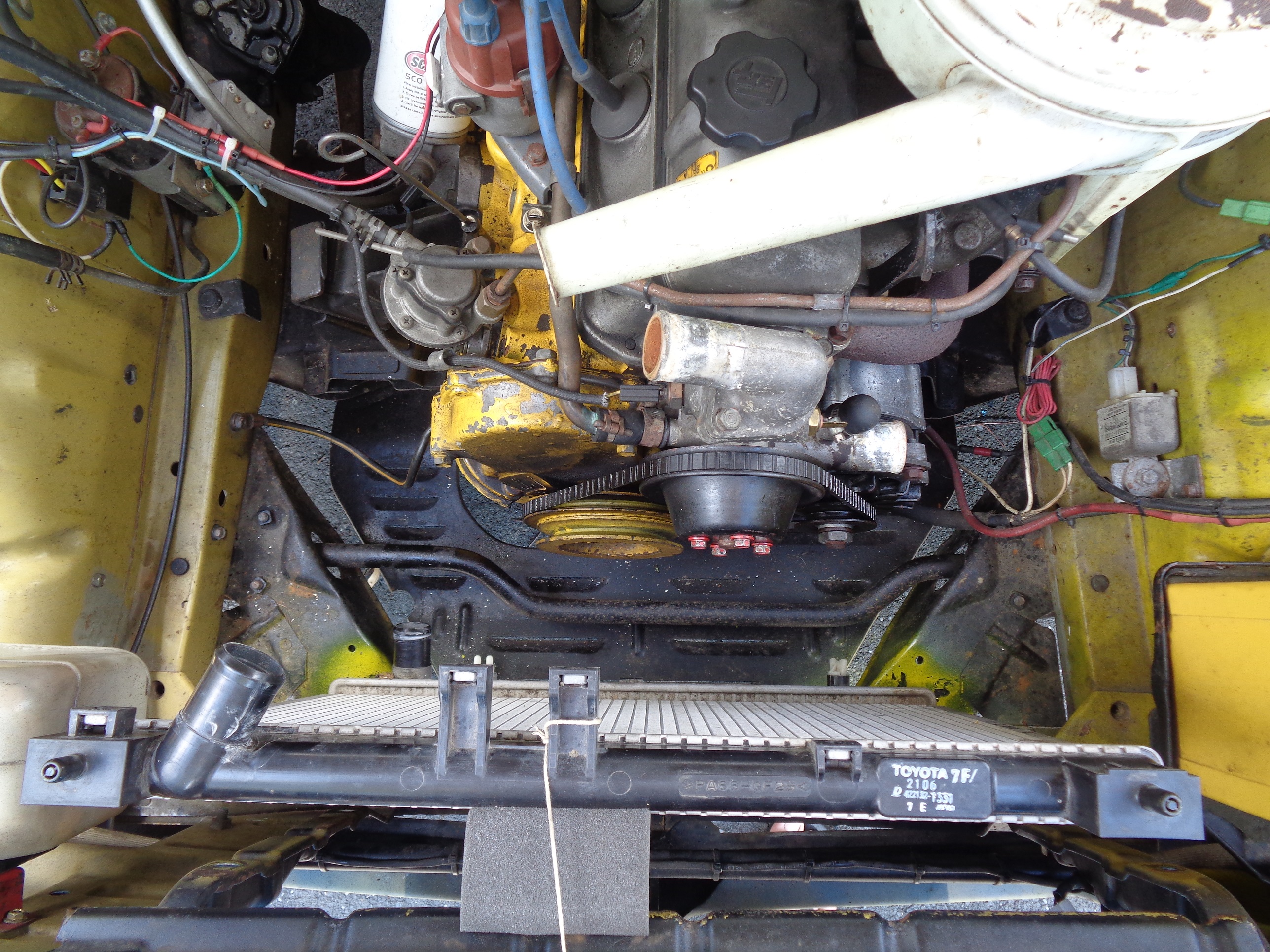

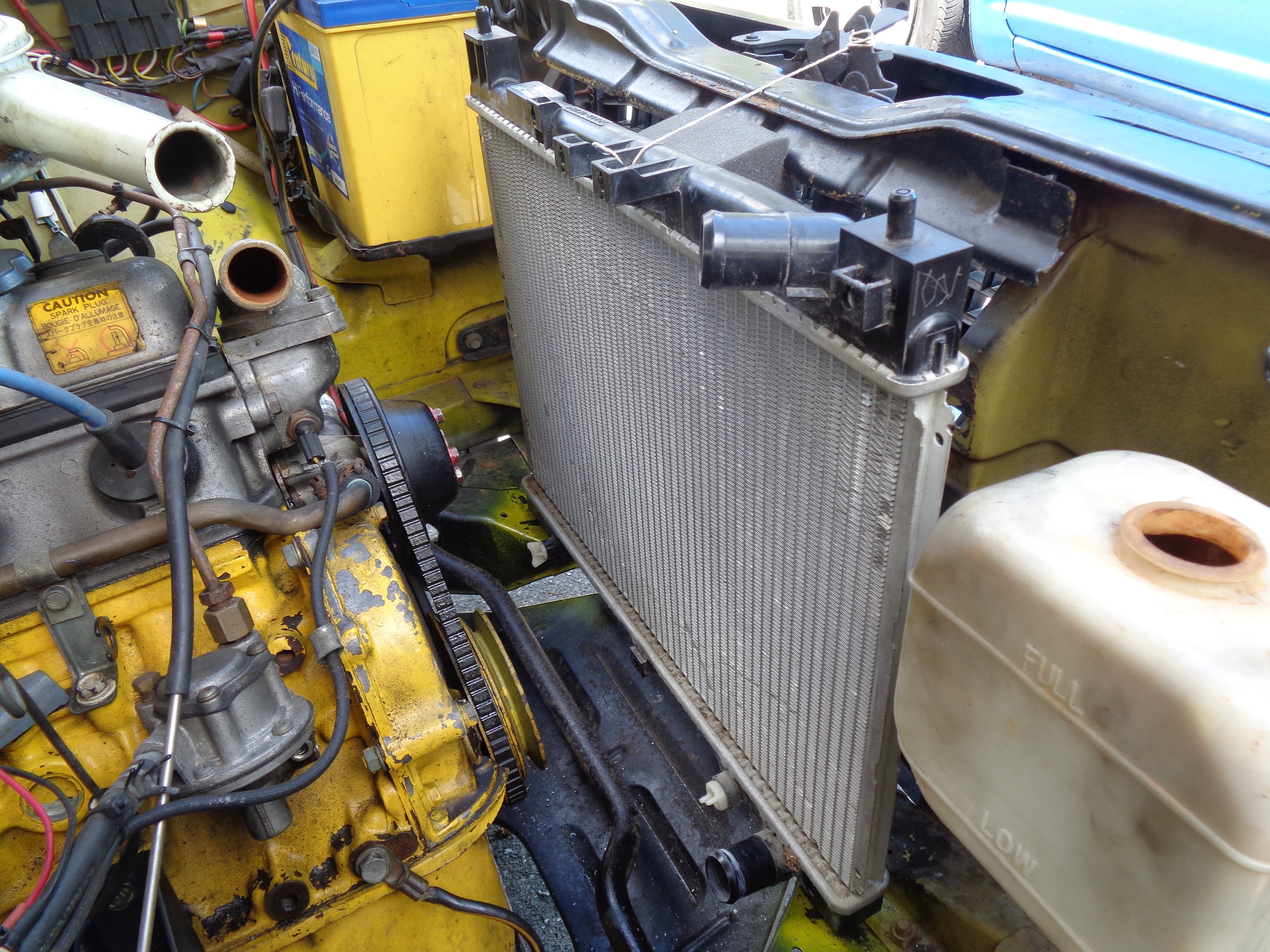

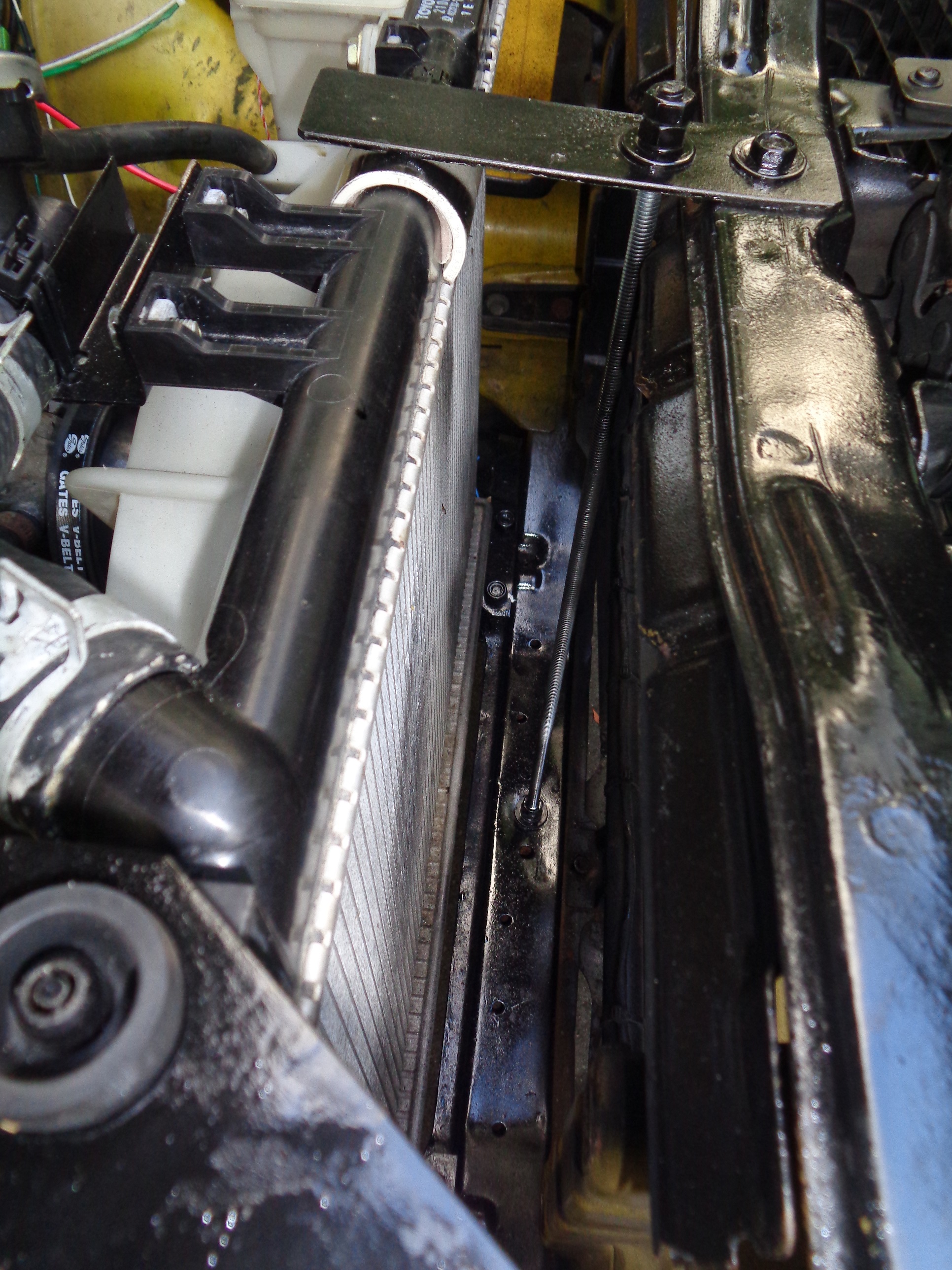

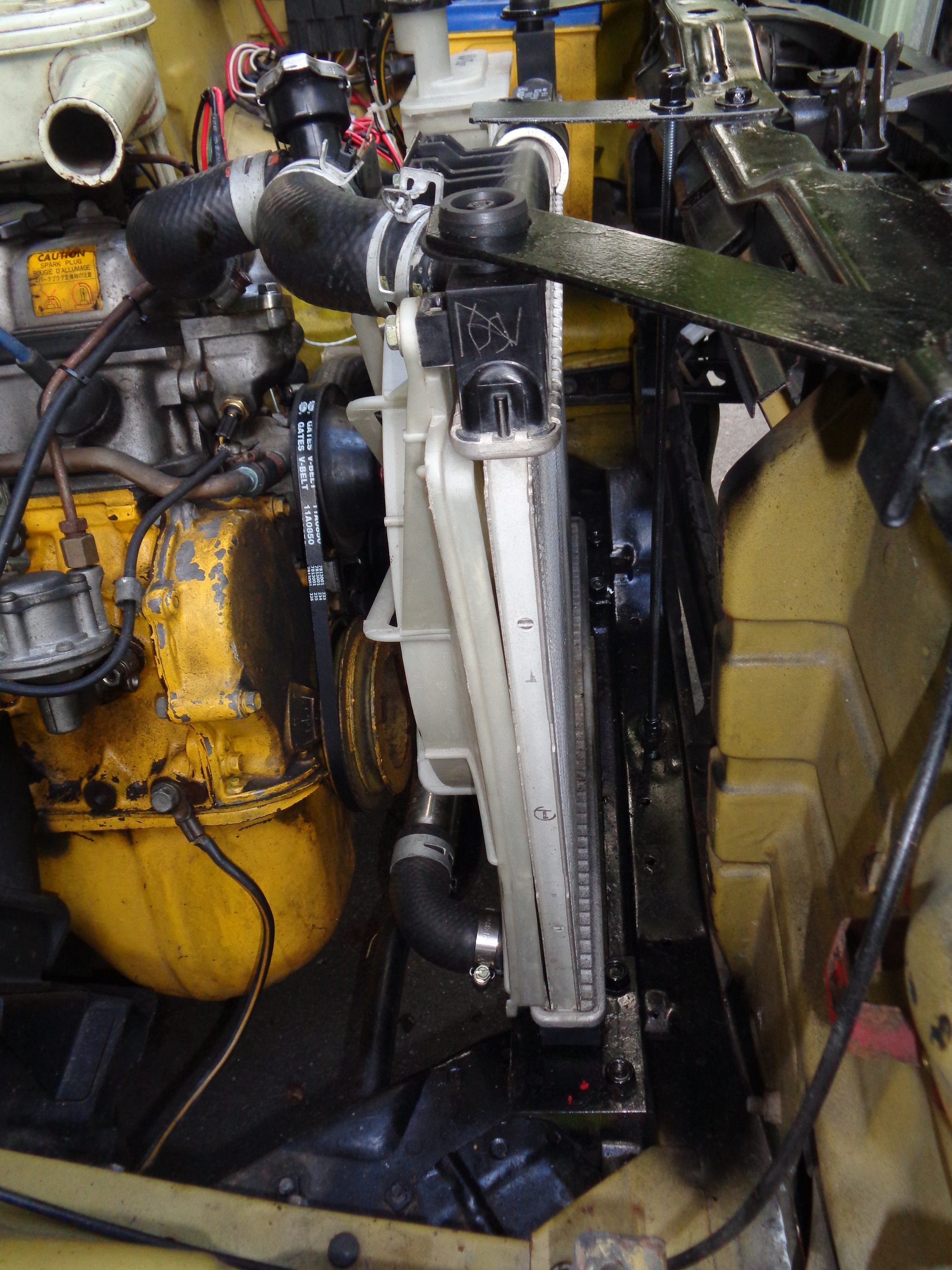

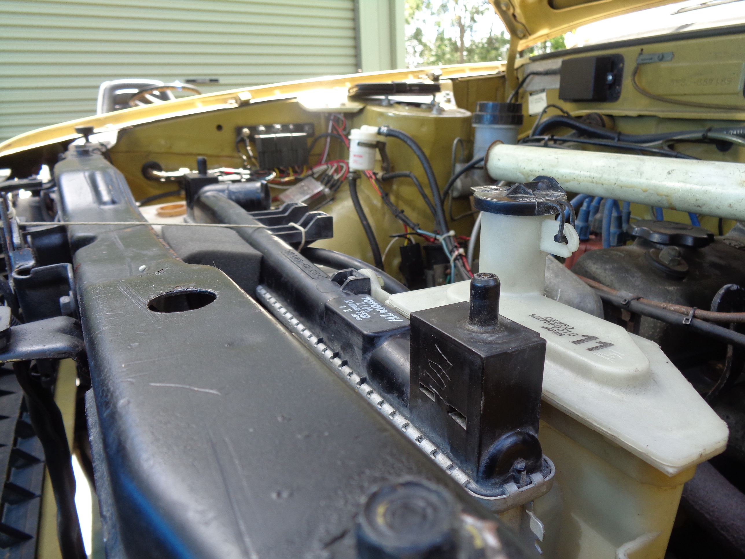

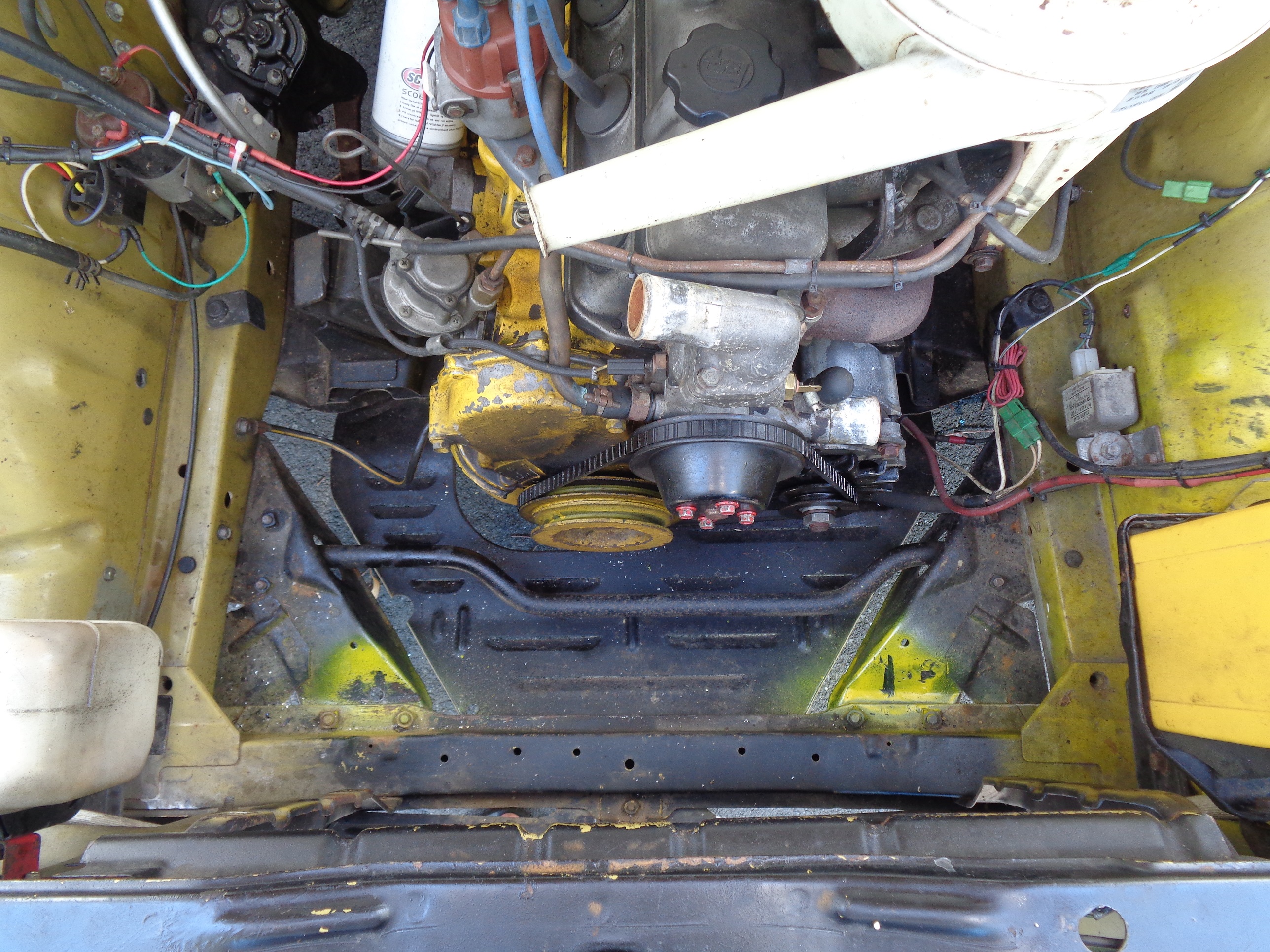

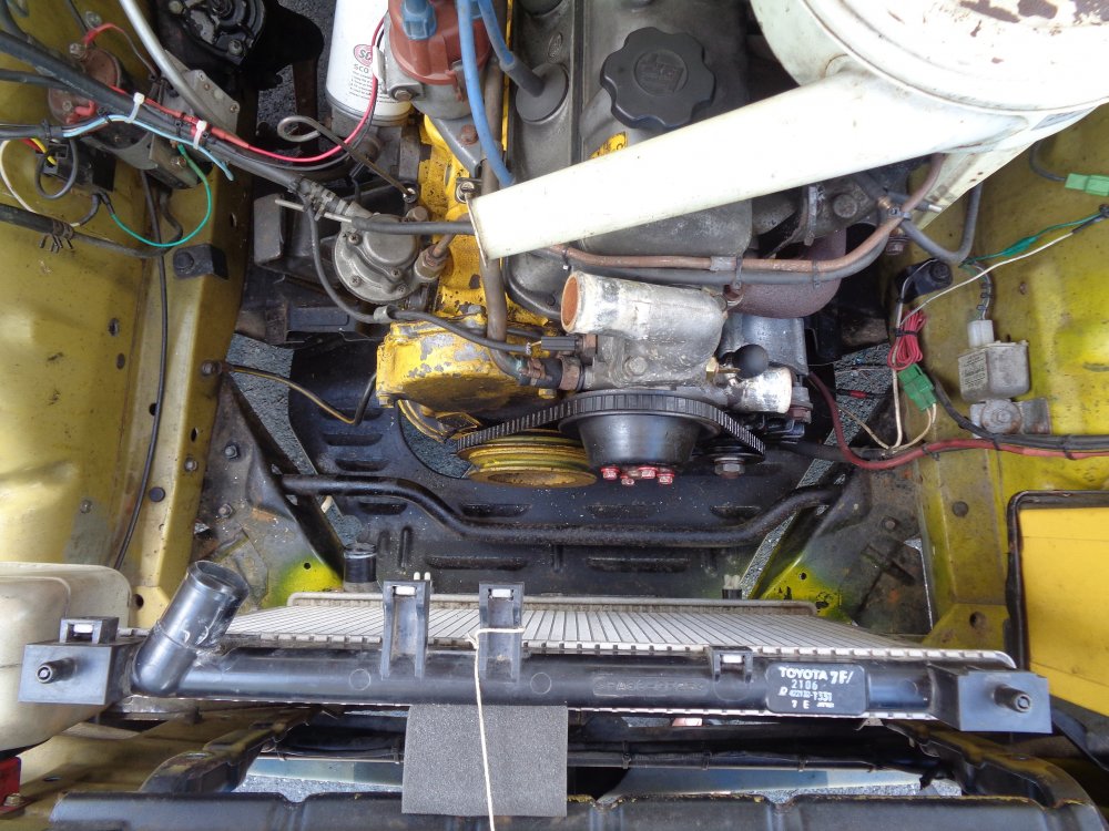

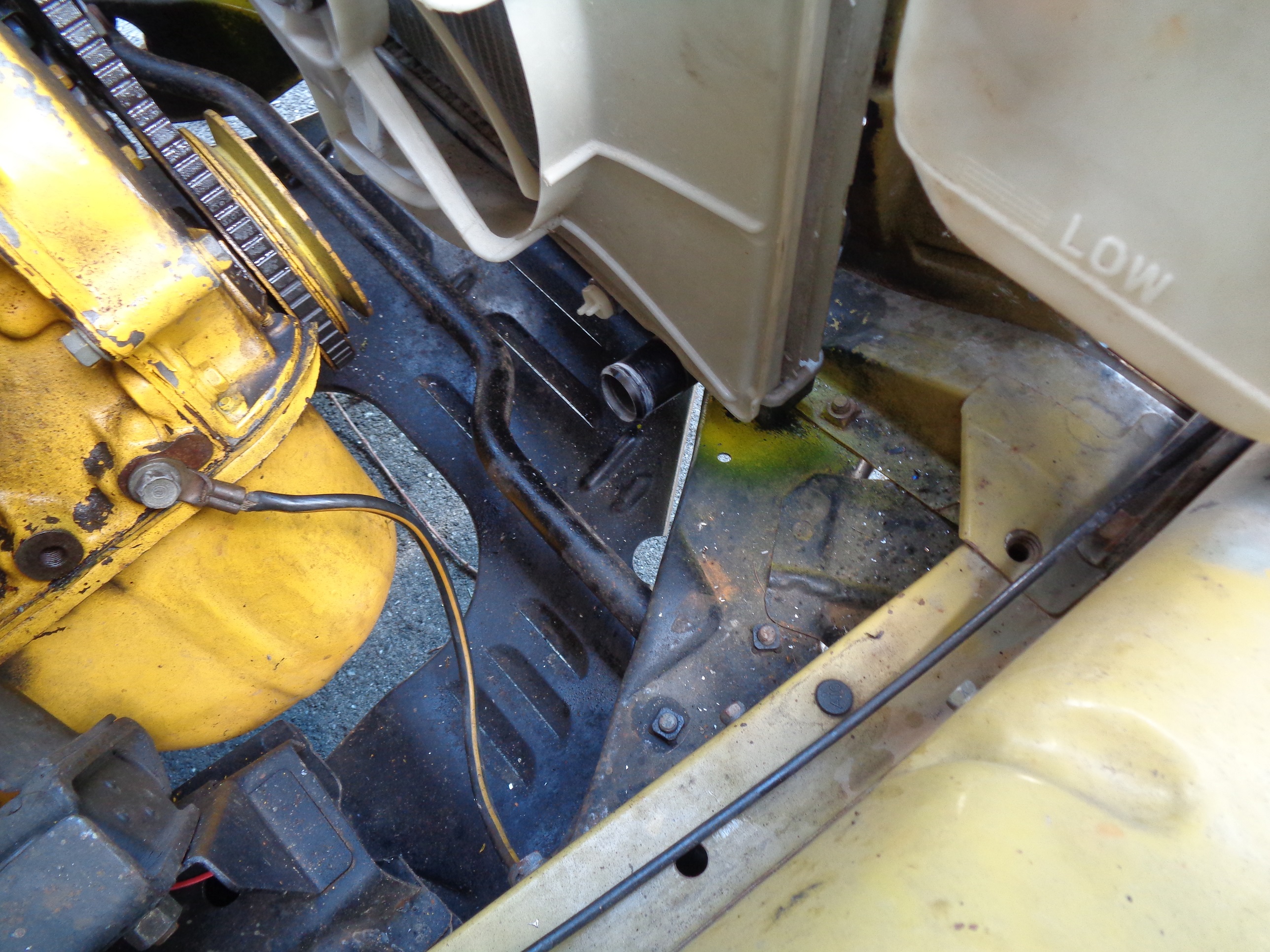

Well, I popped my radiator out at the weekend, between rain showers, & did a trial fit with the Echo radiator & thermofan. Wow, is the Echo aluminium radiator light without fan attached !

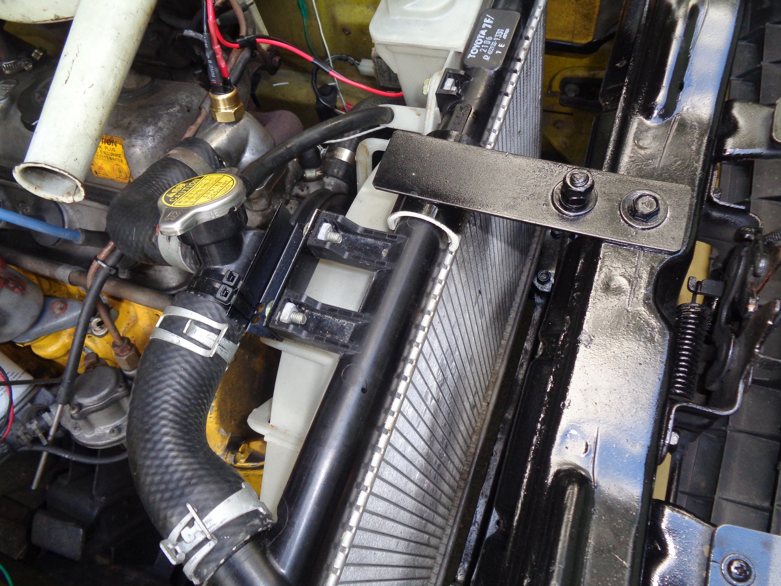

This might well be the easiest mod I've ever done to my Rolla, as can been seen from the following pics. It's almost like the Echo radiator was made for it.  Plenty of room.
The original radiator, mounts on the sides.  The Echo radiator mounts top & bottom, with simple vibration isolation mounts/bushings.
Will order some bushings today, & then make up a couple of simple brackets to hold them.  There is even 4 off existing bolts at the lower mounting points, to secure the brackets.
Height wise, you can see it is perfect, & there is ample clearance under the bonnet.
There is plenty of room, down below, to fit a transfer pipe for radiator lower outlet, to Water pump inlet, which is on the opposite side.
Cheers Banjo

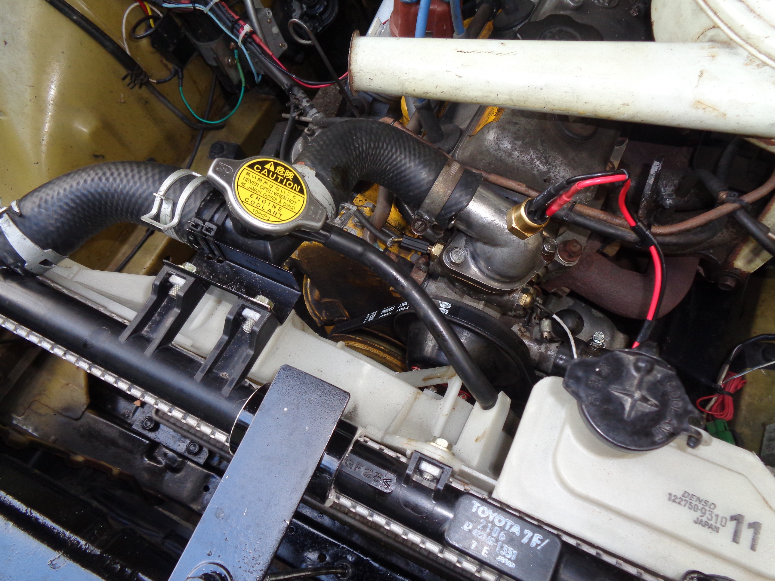

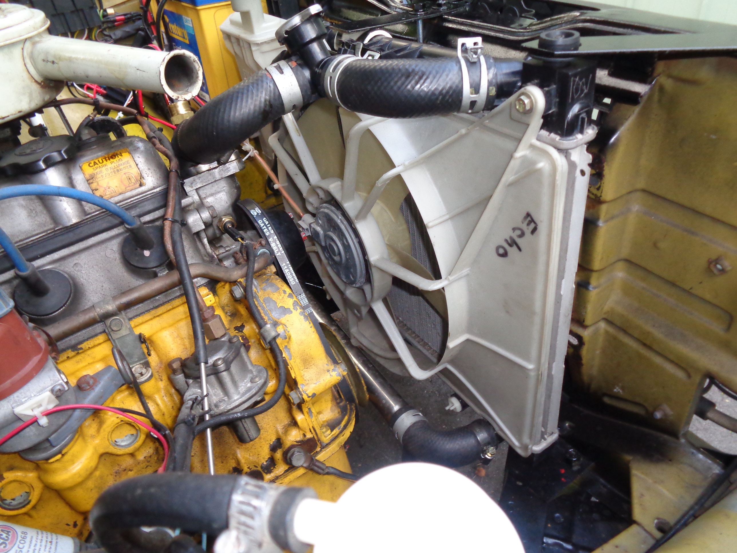

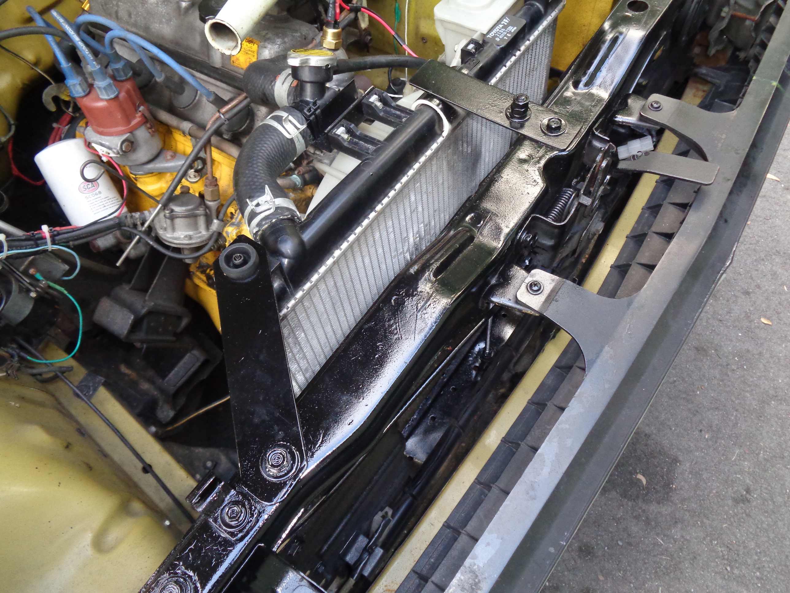

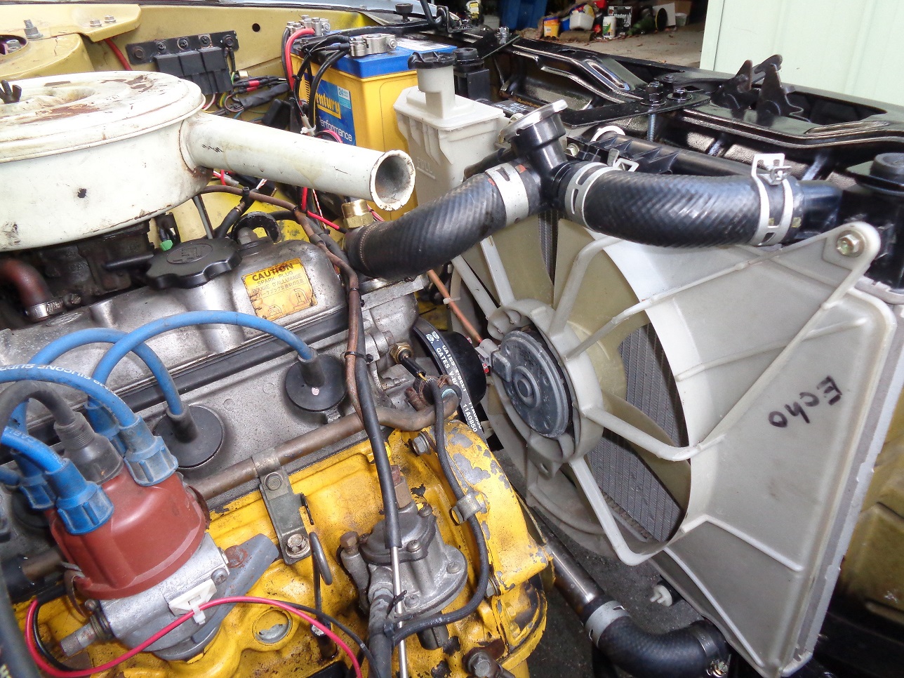

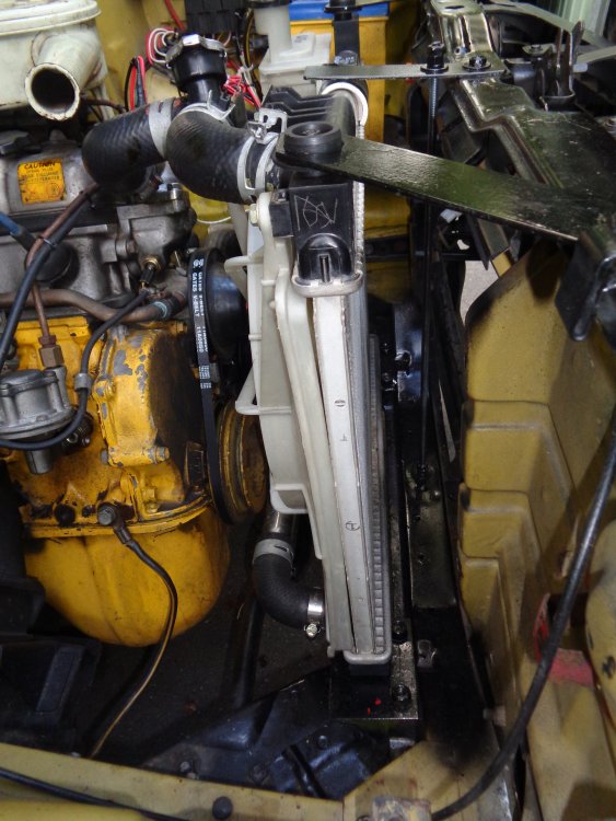

I’ve finally finished the thermo-fan conversion, where I used a Toyota Echo aluminium radiator & fan assembly.  I wired it up with a relay, & a Tridon TSF106 thermo-Switch with a 90 Off / 95 On, switching points.
The results have been amazing.  It has changed the KE30 driving experience dramatically.  As others have noted, the first thing you notice is how quiet the car is.  I had no idea, the old plastic fan there continually thrashing at the air, created so much noise.
I also fitted a Hi Flow Tridon thermostat, P/N TT2040-180, which according to the specs, allows about 30% more flow, when fully open. It controls over the range of 82 – 87 deg C.

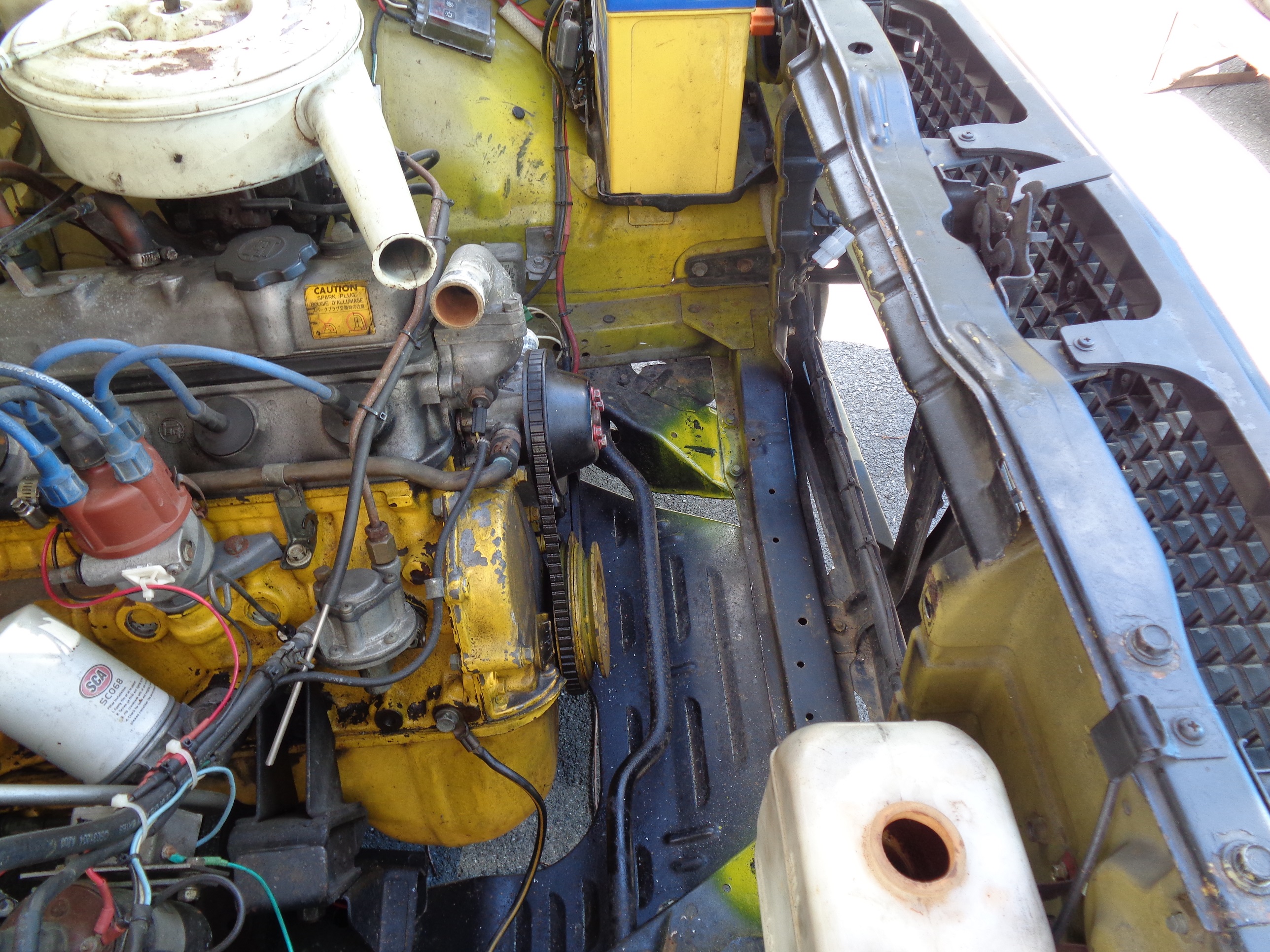

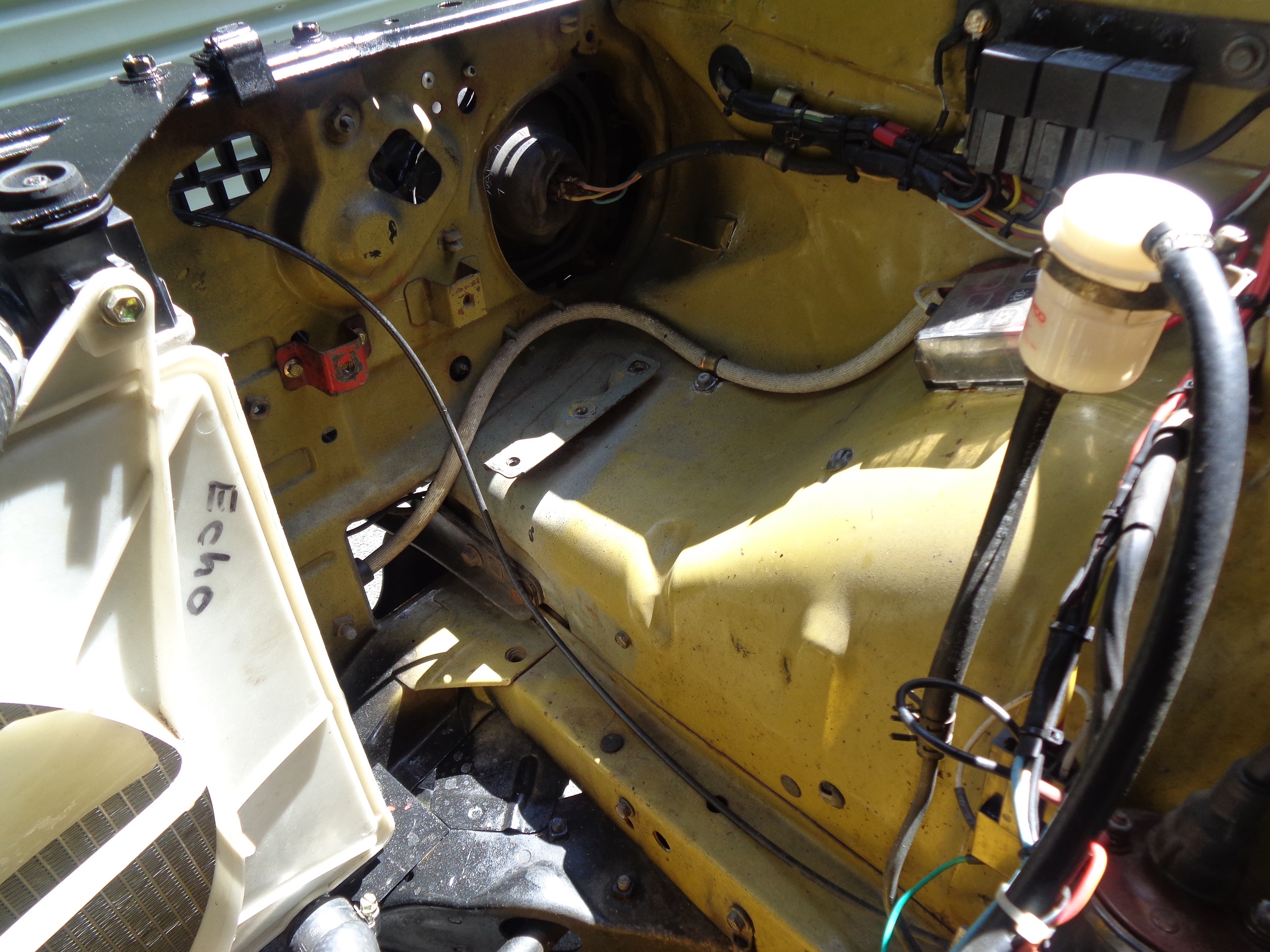

The modification was dead easy, & it was if the Echo radiator was made for the KE30.

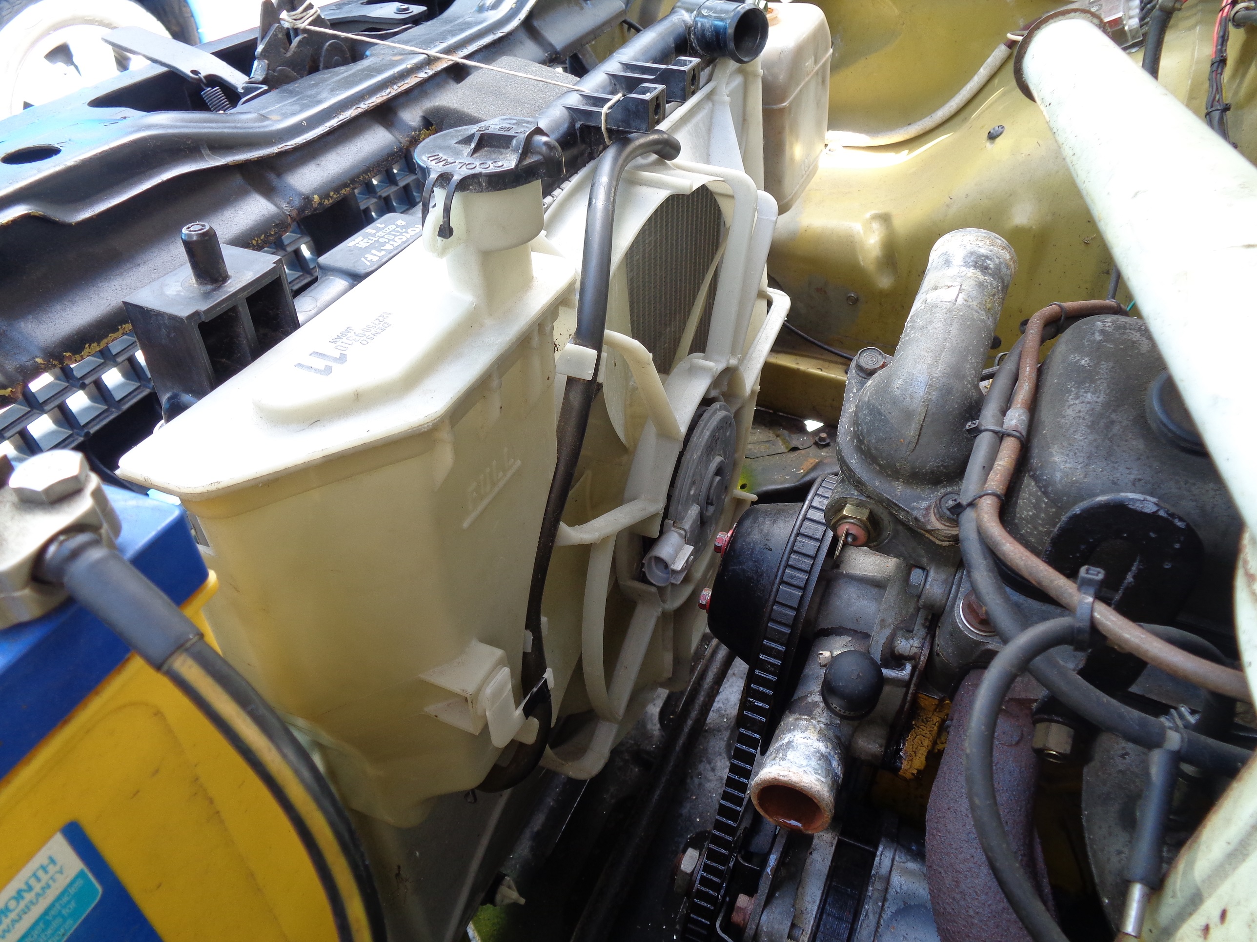

The following pics give a good indication of how easy it was.  Believe it or not, I only drilled one hole in the body for the threaded rod for the radiator hold-down clamp.
If anyone wants to do this mod to their Rolla, I’m only too happy to offer specific assistance, or more detailed pics of the mods.

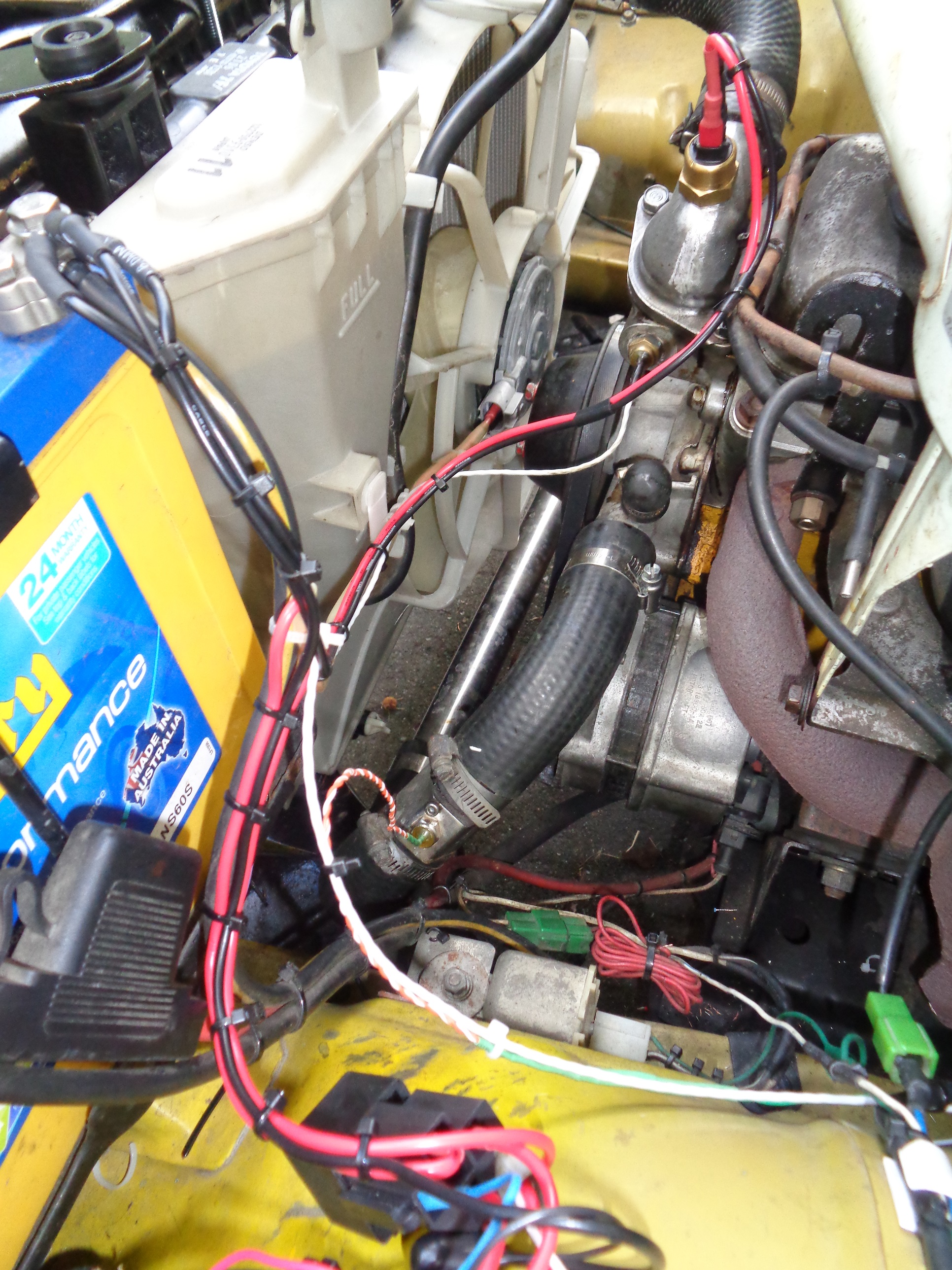

Even the “plumbing was relatively easy.  I was able to use another KE30 lower radiator hose, & the existing upper Echo radiator hose, to connect to the radiator to the KE30.  Even the tube to take the radiator water to the water pump, was easily fashioned from a discarded S.S. vacuum cleaner tube/handle.

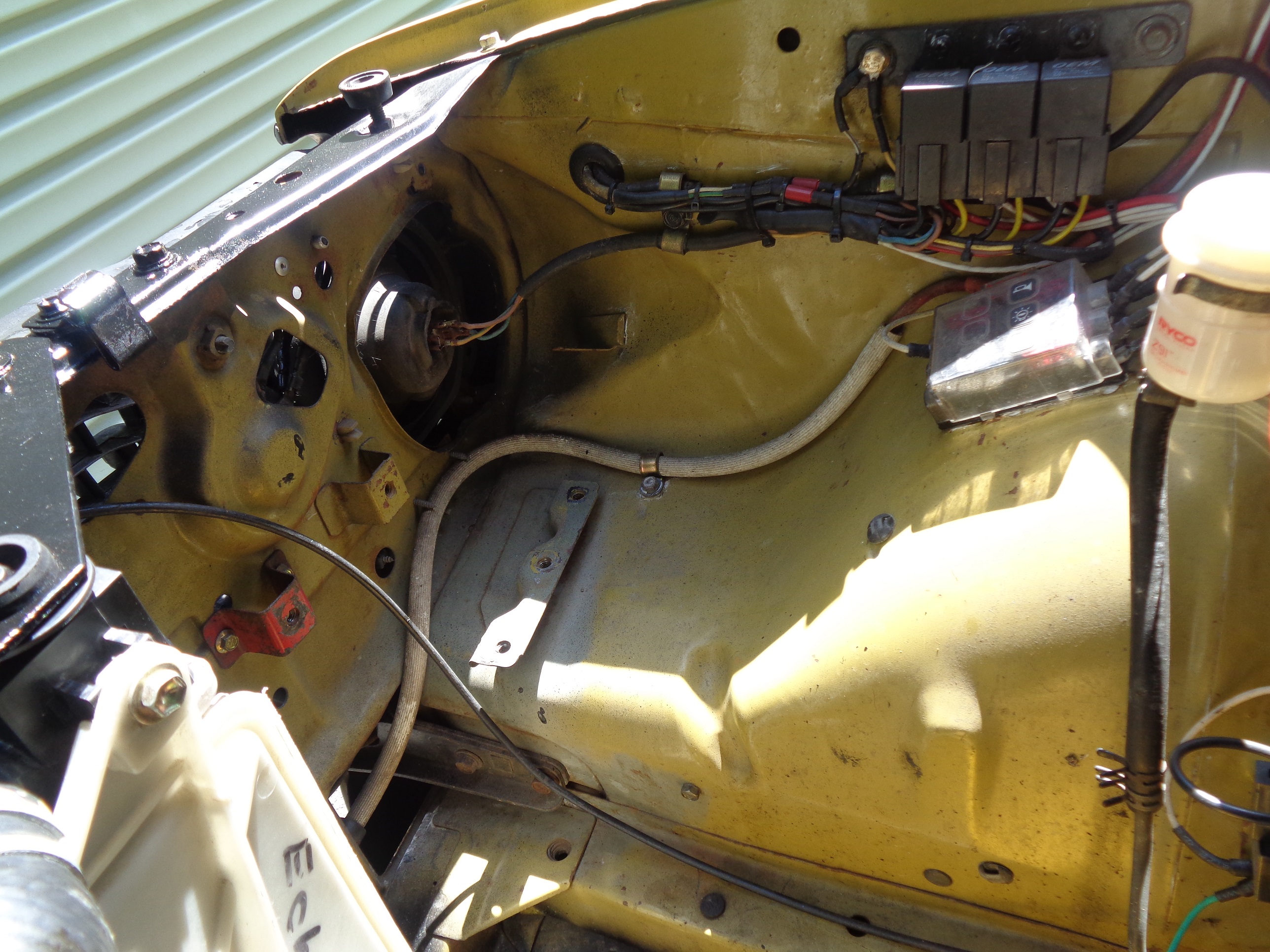

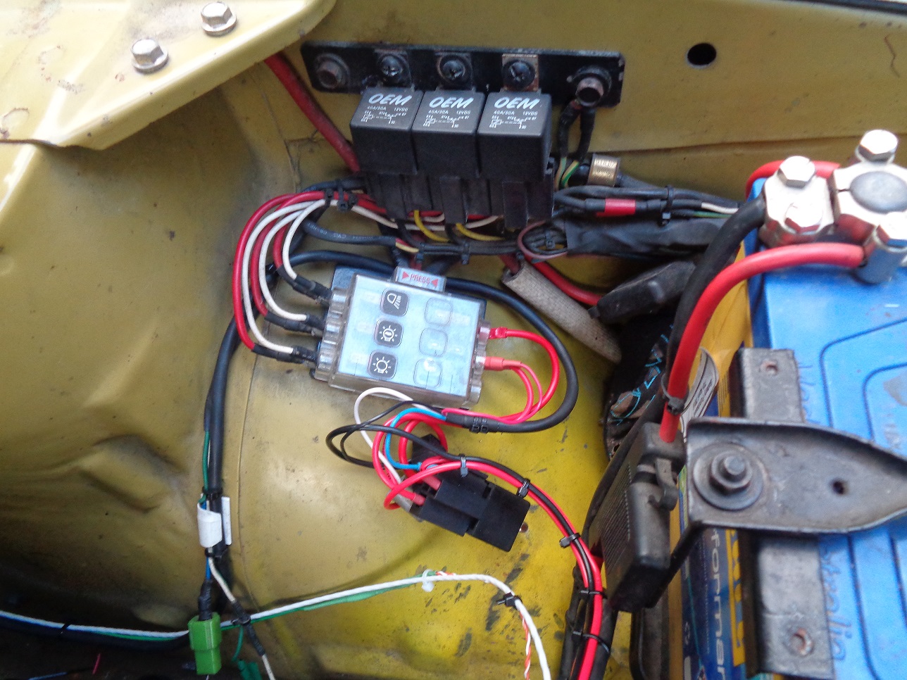

The Echo radiator fan motor draws about 7-8 amperes, & should be fused separately, directly from the battery.  The control relay should also be fused separately, & not supplied by the ignition switch, so that the fan can run on, after the engine has been switched off. I also added a 3 position (ON-OFF-ON) switch, so control of the thermostatic control of the fan could be overridden, either ON, or OFF.

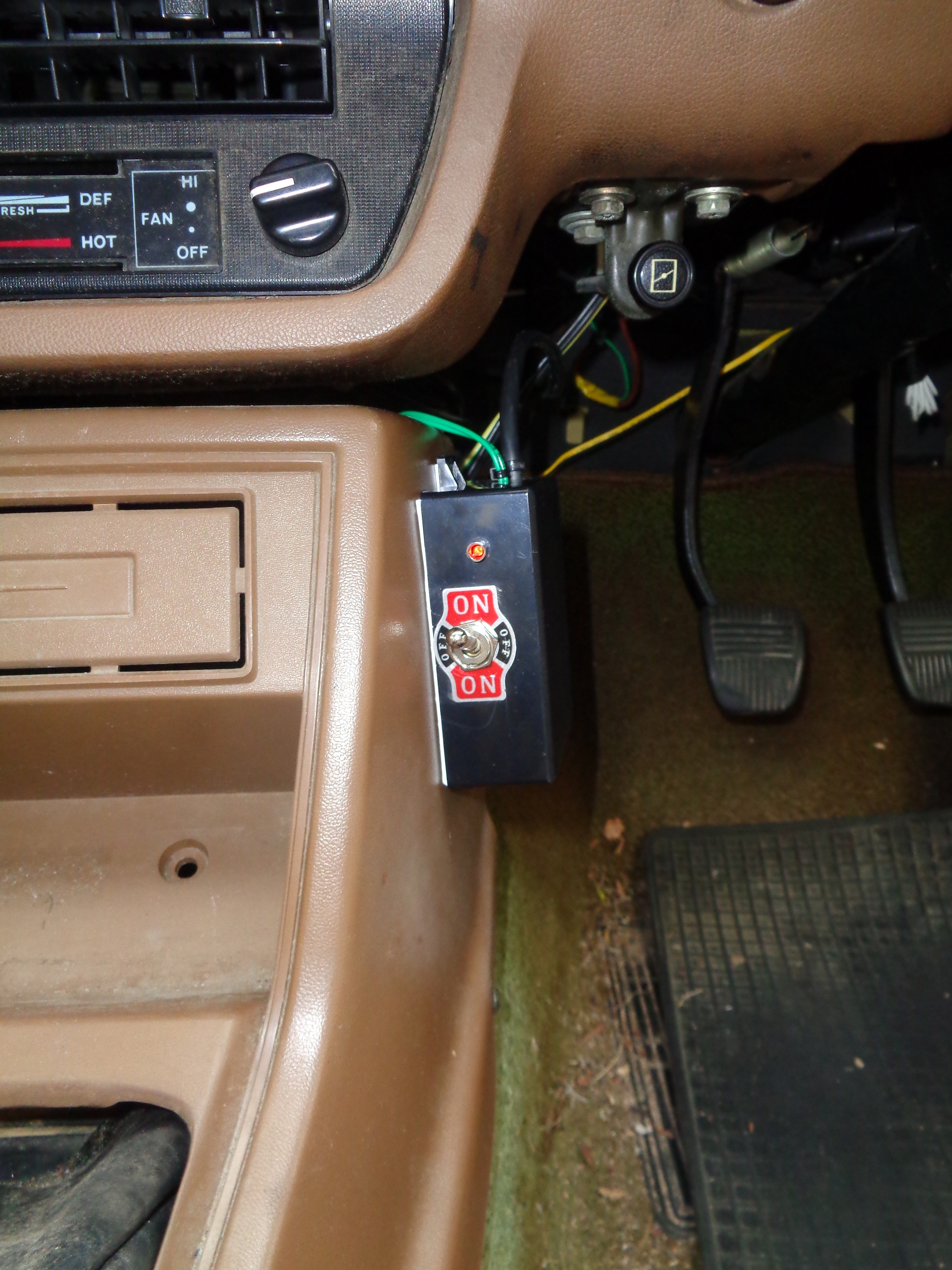

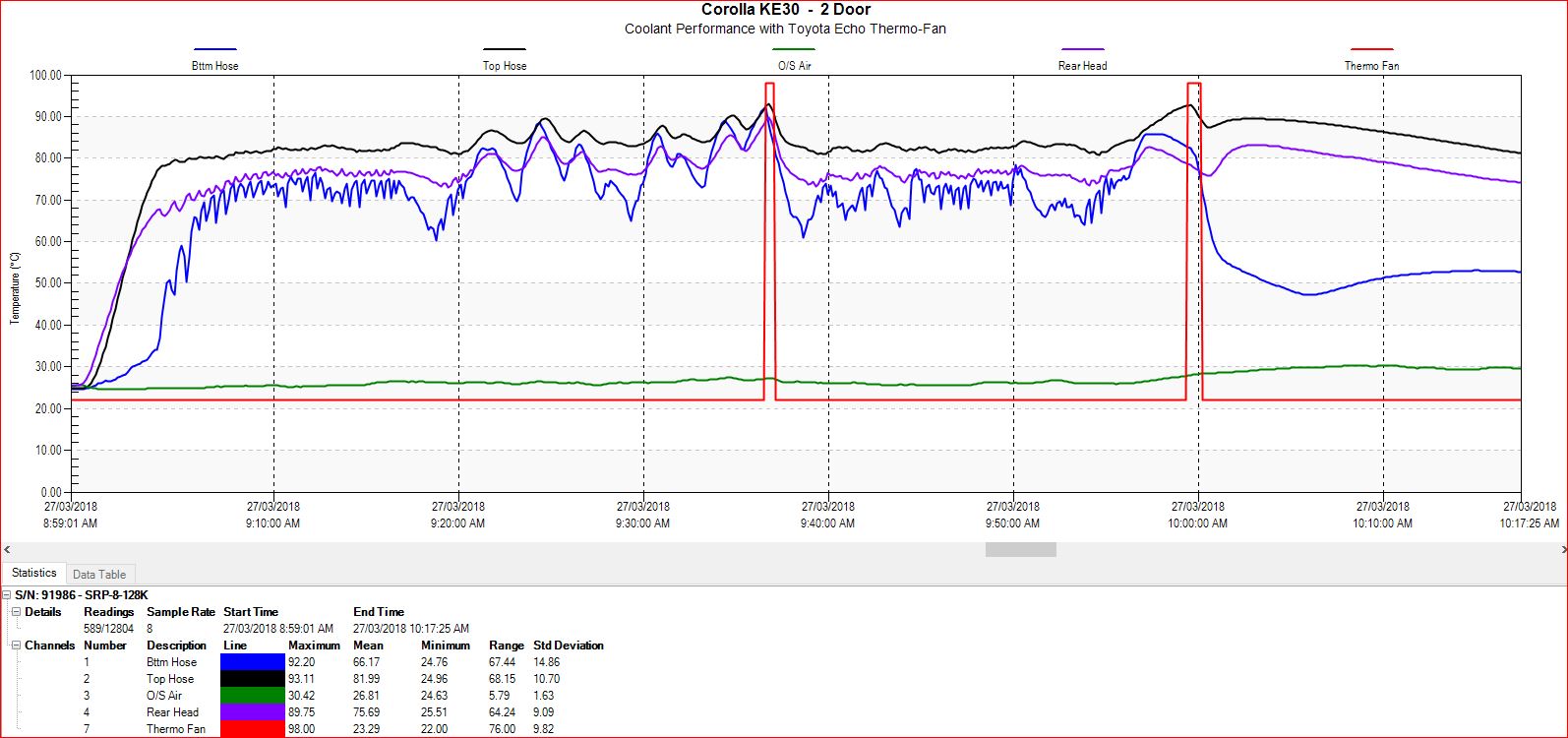

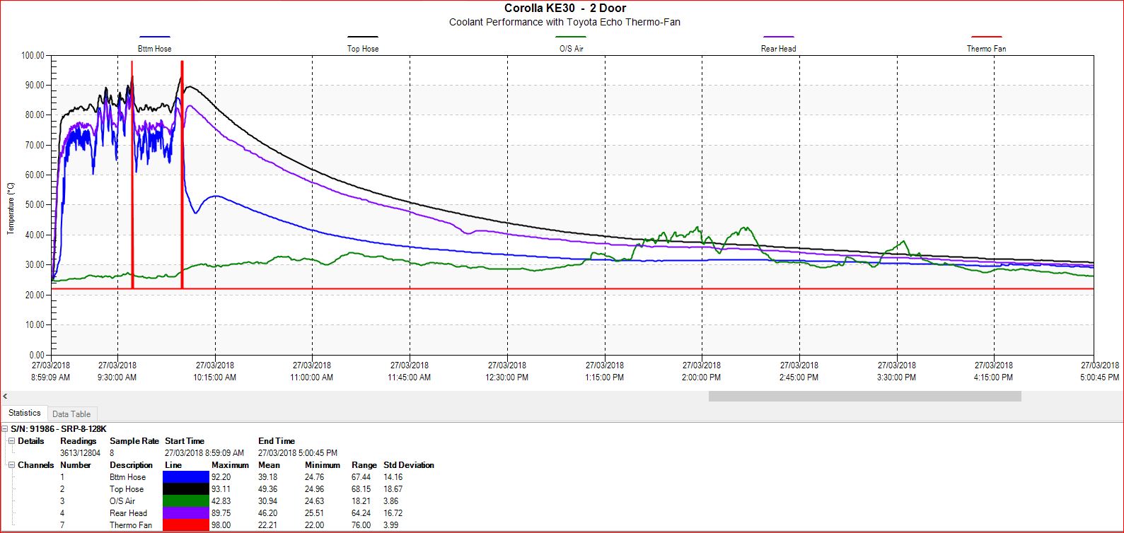

An LED indicator next to the switch, indicates when the fan is on.  I also sent this signal to the data logger, measuring & recording various temperatures, to indicate when the fan is on.
The most amazing & surprisingly advantage of the mod, was the extra power that the engine displayed.  I had no idea, how much power, the engine driven fan, continually drags from the motor.
The Echo aluminium radiator, is so much more efficient in removing heat from the coolant, than the original KE30 unit.
Altezzaclub, has continually said that his thermo-fan, does come on much at all.  Mine did not come on at all, whilst driving.  Admittedly the temperature here are around 30 deg C at the moment, so I expect, that may change at higher ambient temperatures, and more city stop/start driving.
The graphs indicate that during an hour of driving, the fan only came on twice for a total of 90 seconds.
The first fan operation, was where I stopped to let my daughter out of the car, at the bus station, for a couple of minutes, when I did not turn off the engine. It ran for 30 seconds, then switched off, as soon as the car started moving.   The second fan operation, was when I got home, & parked the car.  I got out, locked the car, & walked away, only to hear the fan start up, about 1 minute after the car stopped.  I hung around, to see how long it over ran.  In 60 seconds it shut down.
I will continue to monitor its performance & make some small tweeks.  I still have to replumb the rear head return line to the top of the radiator, under the thermostat, instead of the water pump inlet.
Although rear & front of head coolant temps are within about 3 deg C of each other, I think, this can be made even closer, by fitting a head gasket with no “block to head”, coolant holes blocked, & by decreasing the flow out through the front of the head, which will increase flow to the rear.

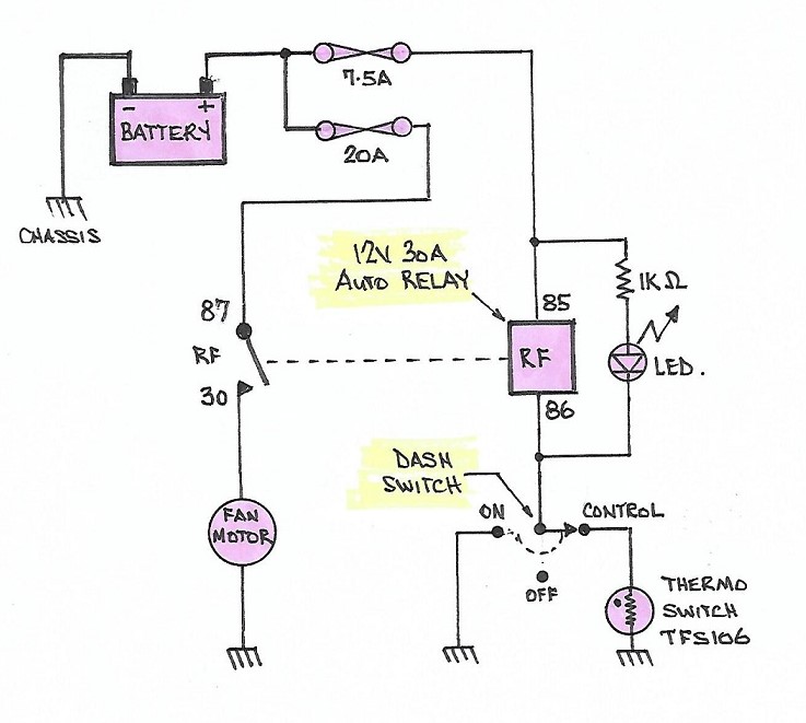

Here is the wiring diagram, if anyone wants to wire up a thermo-fan & a thermo-switch to their Rolla.
I know a thermo-switch is quite capable of switching the radiator fan motor directly, but I like to use a 30A auto relay, so that the thermo-switch contacts don't arc, with the inductive switching current of the fan motor.
The 3 position switch is not really necessary, & could be dispensed with.  I put it in there, for three reasons.
1.  So as I experiment with the coolant system whilst I drive, I can simply turn the fan on of off, allowing me to force the coolant temperature up or down.
2.  Bypassing the thermo-switch allows you to start the fan early, if you know you are going to be putting a heavy load on the Rolla engine, like doing a hard run up to the Toowoomba or Cunninghams gap hills.
3.  If you ever have to do a water crossing, it's nice to have the option to turn the fan OFF completely.  The last thing you want, is the fan acting like a boat propellor, & covering your engine bay in water.
Cheers Banjo
Edited by Banjo

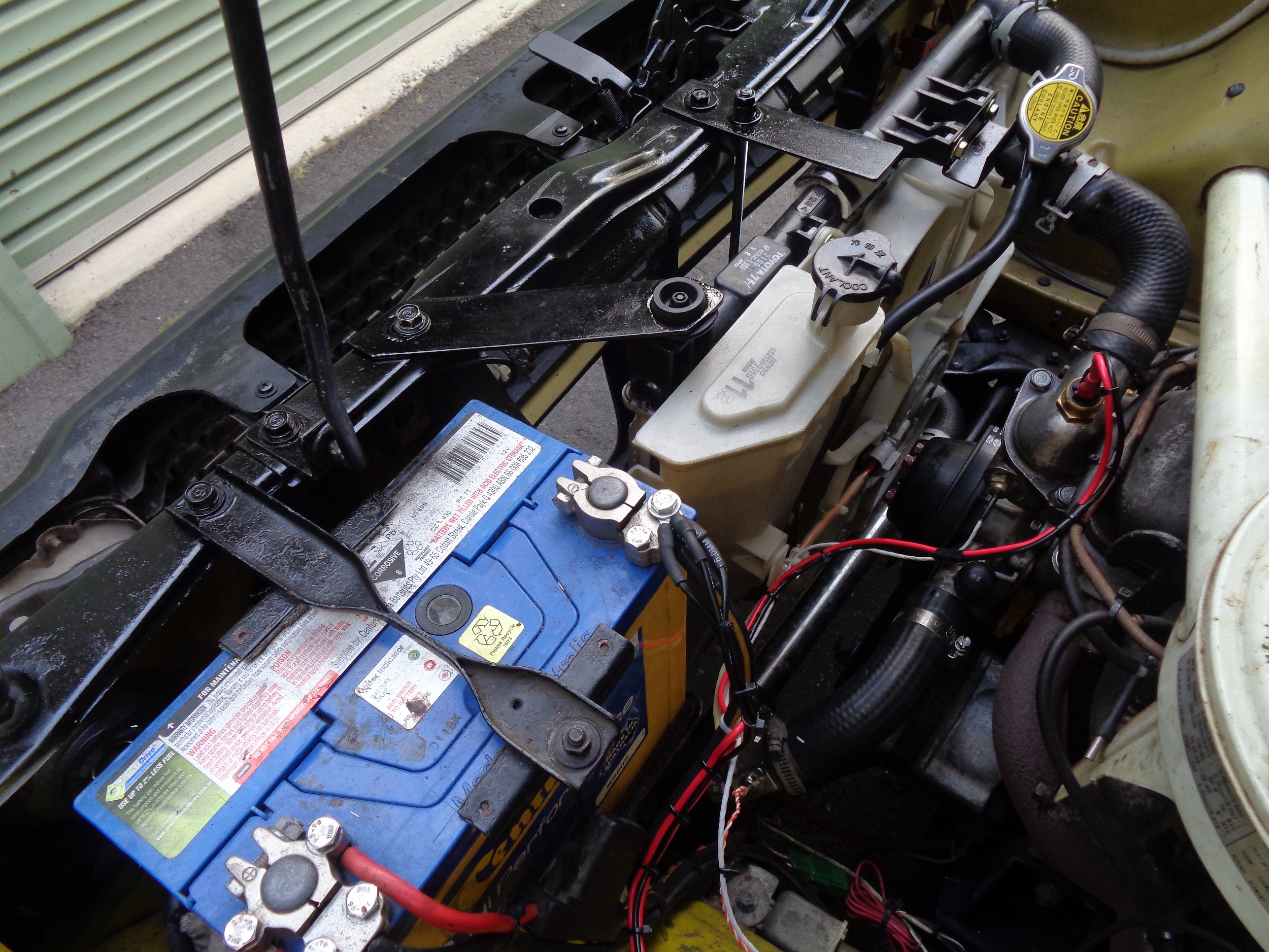

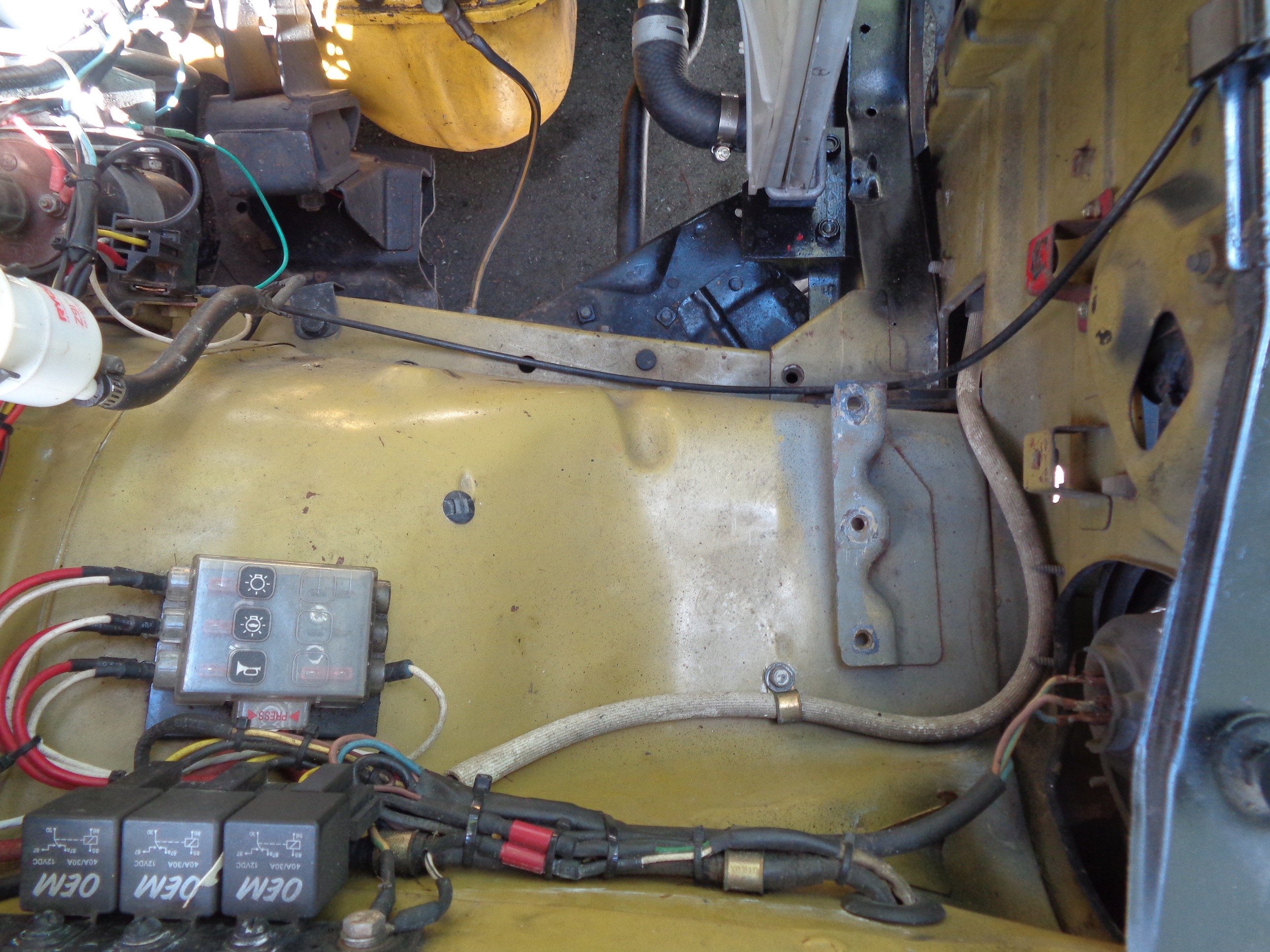

Looks like a great place to put a battery...  down low at chassis level.
