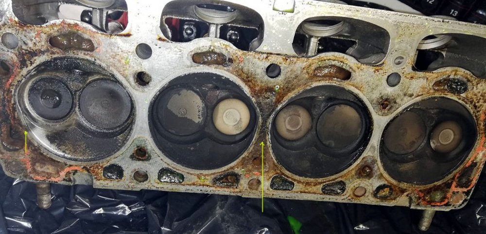

So my 3kc did a head gasket couple of weeks ago - no big deal until i pulled the head off and realized the entire head and block are rusted out. So I'm just weighing up my options of getting a 4kc for a couple of extra ponies or persevering with the original engine.
So my noob questions are:
Can i stick my 3k carb on a 4k? as i just bought a rebuild kit for the 3k carb and would like to use it
Is this block salvageable?  I think the elderly lady never used coolant and the vehicle did alot of sitting
apologies photography isn't my strong suite but some of the water-jackets have disfigured from rust
any info or advice welcome ! thanks for reading

Doesn't look any worse than most engines ive pulled apart....Give everything a very good clean (without scratching the mating surface) and see how it comes up.
put a straight edge across the diagonals of the block and see if its still flat.
And don't put that head back on unless its been to a machine shop for checking and if required a shave to make it flat.
I put a 3k carby on a 4k years ago. it worked fine, but i suspect it might have been a restriction, it was incredibly slow - but ultra reliable. .Maybe the jets should have been swapped to bigger 4k ones. i dunno, my carby knowledge is a little limited.

As well as what Dave said, tip the block on its side and scrape all the rust and gunge out of the water jackets, particularly around number 4 cylinder. The slow water flow at the back of the engine means the rubbish piles up around there and causes overheating.
Clean ALL the stud holes out with a rag on a screwdriver, then with a rag soaked in petrol on a screwdriver, then with a bolt of the same thread that has a wedge cut out of it with a grinder or hacksaw. That will clean the threads out. I usually spray it with Brake-clean aerosol after that and wipe them out again with a rag. Make sure you clean all the bolts and nuts, and oil them when assembling.
The manifolds need a straight-edge along them too, the differential expansion of the alloy & cast iron distorts them over the years and leaking exhaust gaskets result.

              From my experience, that engine looks pretty good.  As it's probably original, how many miles has it travelled, according to the speedometer ?   Little olde ladies, are not known for racking up big mileages, on their cars.
I accept your comments regarding the possibility of going to a 4K, but bear in mind, as these engines are probably 40 years olde, the 4K may be in more need of "care & kindness", than this 3K.
Can you look at the casting of the head, on the outside, between no: 3 & no: 4 spark plugs, & take a note of the number of the two digit head type.  That might assist us in identifying it a bit more.  Your pics don't show it; but on the very back of the head, there is either a plate or a circular water jacket bung.  This needs to come out to get access to all the "crud" inside.  Sometimes pressure chemical cleaning of the head water compartments will dislodge the crud, but frequently, the plate at the back, is corroded badly on the "inside face", & should be replaced.

Thanks everybody for the advice, good to hear some positivity about the 3k - The 3k has just over 190,000 kms on it, not much for a 3k. Much agreed about the 4k Banjo but i was hoping to get that tiny torque boost with a view to eventually boring out, i live in a hilly area and modern drivers aren't known for patience
i'll get some better pics of the head - either way i'll clean it up and hang onto it as it is the original engine for the vehicle

Oh, and #4 cylinder wasn't doing any work, it shouldn't be any blacker than the others.  Was the gasket blown between #2 & #3, the usual place when a head warps? or was it a problem at #4, the area where the motor gets really hot due to shit in the block?  Banjo has a lovely solution for that, he made a bypass system that moved water around the back of the head more efficiently. The water holes at the front of the motor are blocked off by the gasket to force water to circulate to the back, so Toyota became aware of this problem early on.

Yep cyl 4 was the culprit - and I think you're spot on about cyl 4, there was a loss of power occasionally particularly on hotter days -  I thought i had a sticking caliper.
