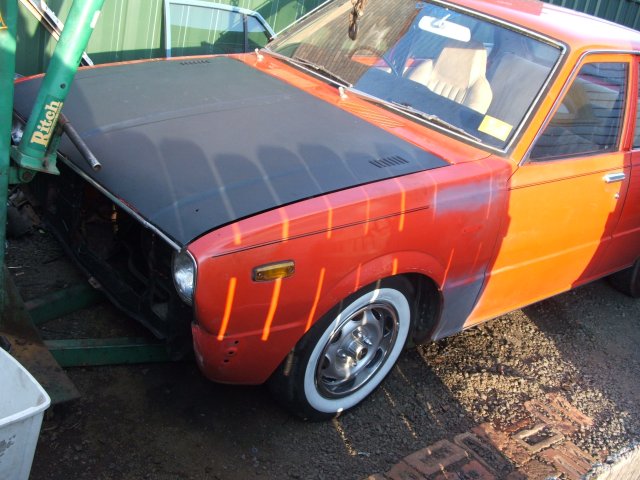

Ill have standard 13" wheels on it, i will be using standard 13" with white walls and it will be lowered heaps.

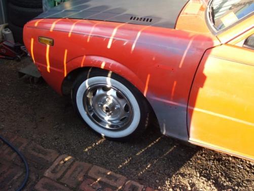

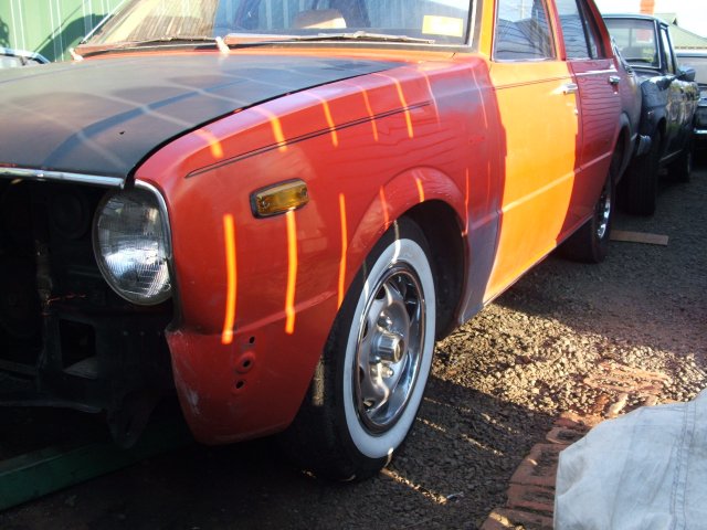

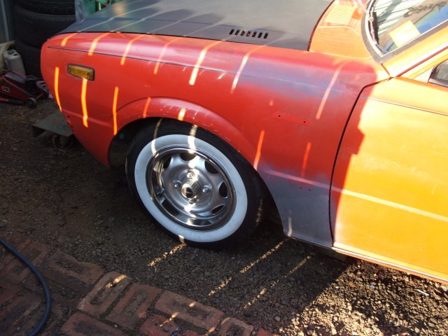

Hmmmmmm my Port-A-Walls arrived today, If you don't know what they are, its a rubber inlay fitted to the rim and is held on by the bead of the tire

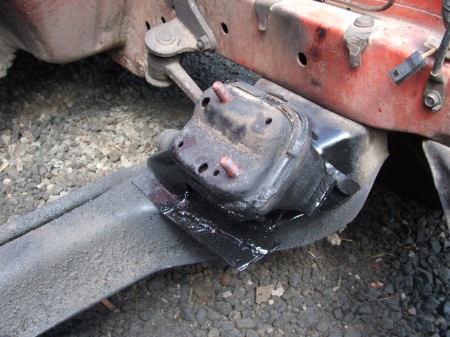

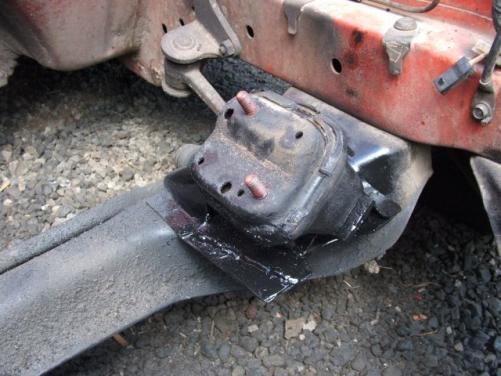

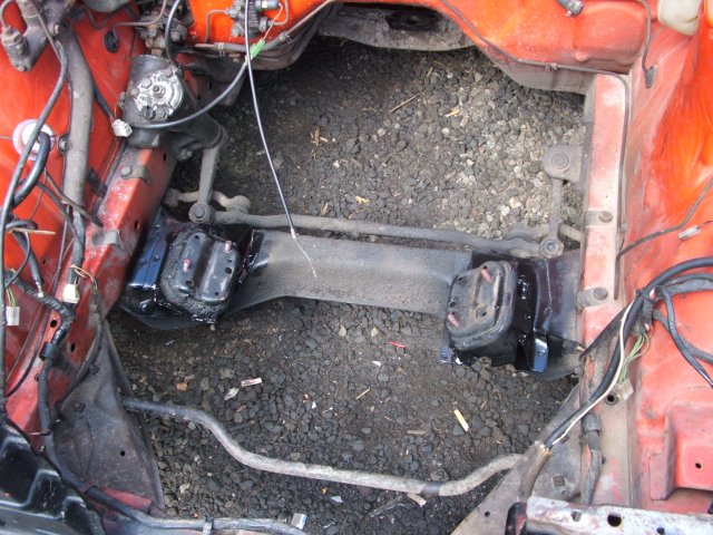

Modified the Xmember to fit the Commodore engine mounts

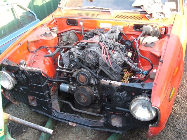

Engine now all bolted up, most things fit, but i did this without the bellhousing so i hope it all fits. This is where i wanted the engine to sit. so if the bellhousing doesnt fit ill modify the firewall and tunnel till it does :jamie:

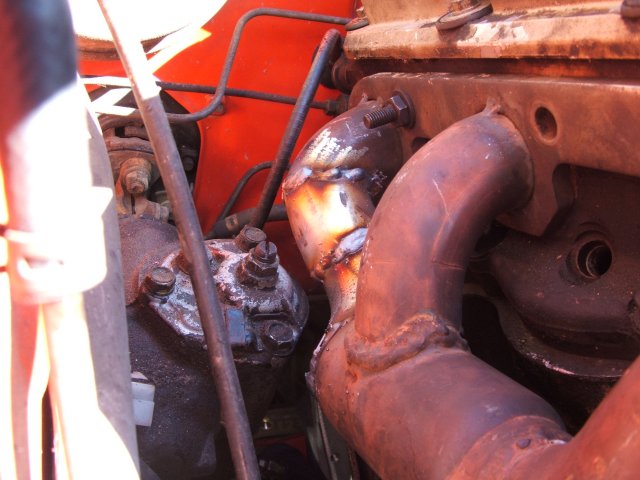

the drivers side exhaust manifold just needs to be hit with a hammer to make a dent and it will clear the steering box easy, the other exhaust needs one quick cut and shut to clear the steering on the other side.
Castlemaine Rod Shop are supplying the bellhousing. It will take the supra clutch slave,fork,thrust bearing and carrier. I use the supra clutch plate and the commodore pressure plate, can't get any easier than that.
Exhaust,rear xmember,tail shaft, wiring and water works are next weekends jobs.

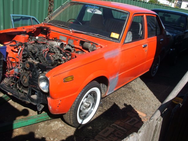

engine and gearbox are in, got the engine in the rightplace first time and even the tail shaft is standard length and using the supra rear xmember and it bolts to the original mounting holes. The bellhousing was a worry when it turned up as i thought it would never fit, but a few taps with the large hammer and there is no problem
I bought a new pressure plate for ebay for $31.40 delivered to my door.
Only things left is the clutch master cylinder and exhaust, one manifold is fitted, i still have a clearence problem with the drivers side with the steering box that ill fix at the weekend.
then bolt in everything else like the radator and i hope by the end of the weekend it willbe going.

header now clears the steering box.

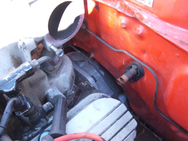

this is how the bellhousing clears the tunnel.

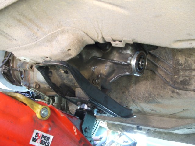

Rear xmember location, still needs a little mod.

Something i learned today commodores there are two starter motors 1 for manual and 1 for auto, The auto one is like a corolla one but the manual one had a reduction drive and is huge.
Well mine being manual the starter is huge and doesnt fit between the engine mount and the bellhousing and the engine was too low so the xmember was in the way.
ive moved the engine mount on the xmember further forward and lifted the engine.
