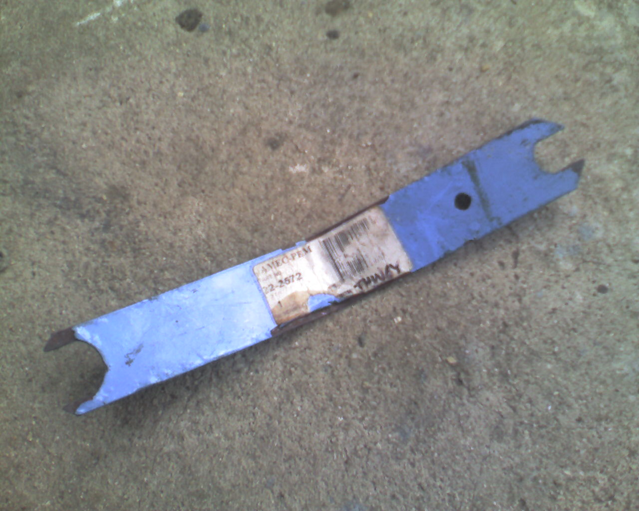

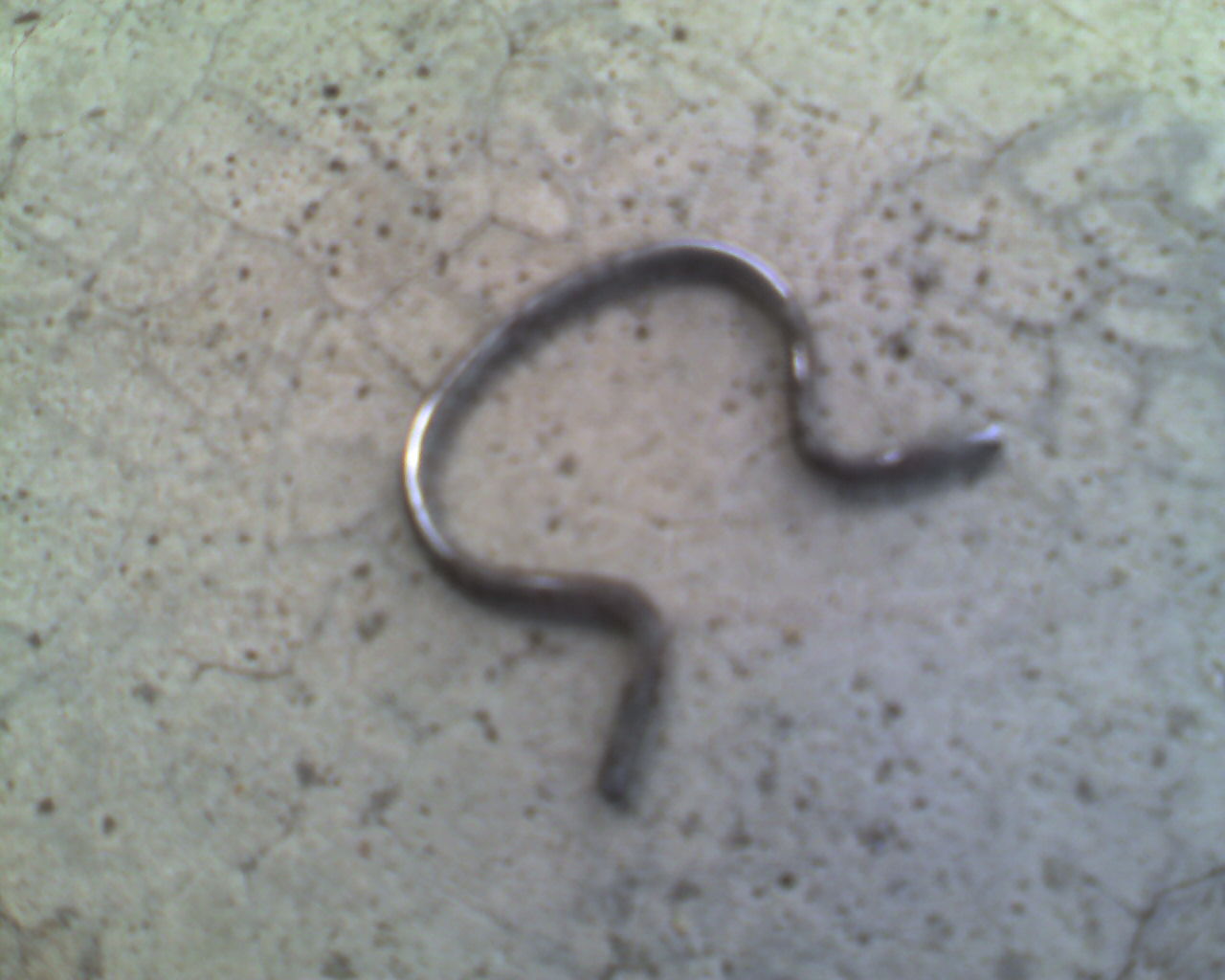

7shades Posted August 16, 2006 Report Posted August 16, 2006 This one had me completely buggered for a while when I first started playing with cars many moons ago too The winder is held on with one of these And to get it off you need one of these... I call it "the thingy" available from panelbeater's supply shops Or alternatively, get a tea-towel or something like it, hold two corners, pull it tight, and work it up underneath the handle until it pops the circlip out. And swear a lot. That helps. :y: Quote

Hiro Protagonist Posted August 16, 2006 Report Posted August 16, 2006 The driver's door window winder in our KE55 had the knob broken off it before I bought the car, came with a spare one but only the other day did I get around to putting it on. Simply a case of gently pulling the handle away from the door so you can see which way the spring clip lines up, then pushing down on one of the prongs with a thin flat-bladed screwdriver.....popped right out, pulled off the handle, and then repeated in reverse for the new one. Total time = 5 minutes, total cost = $0 Quote
