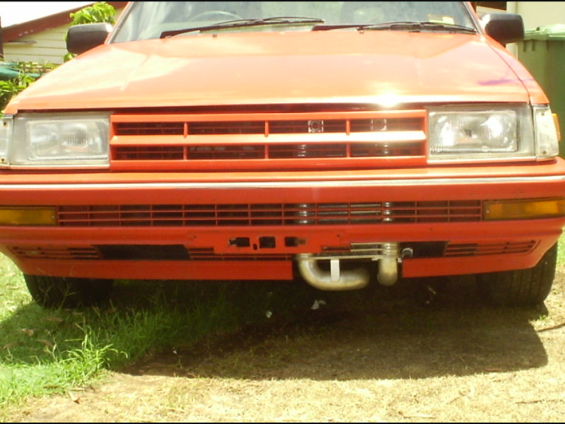

Yes i have been looking at the front end picture for a while now and still havent thought of a easy way around it and it still work. The ic is 2 inch pipe size like all of my stock gze inlets and outlets so perfect for me :lolcry:

I'm going to eventuly figure something out, its one of those things i think about when doing mind numbing monotonousy ie job lol

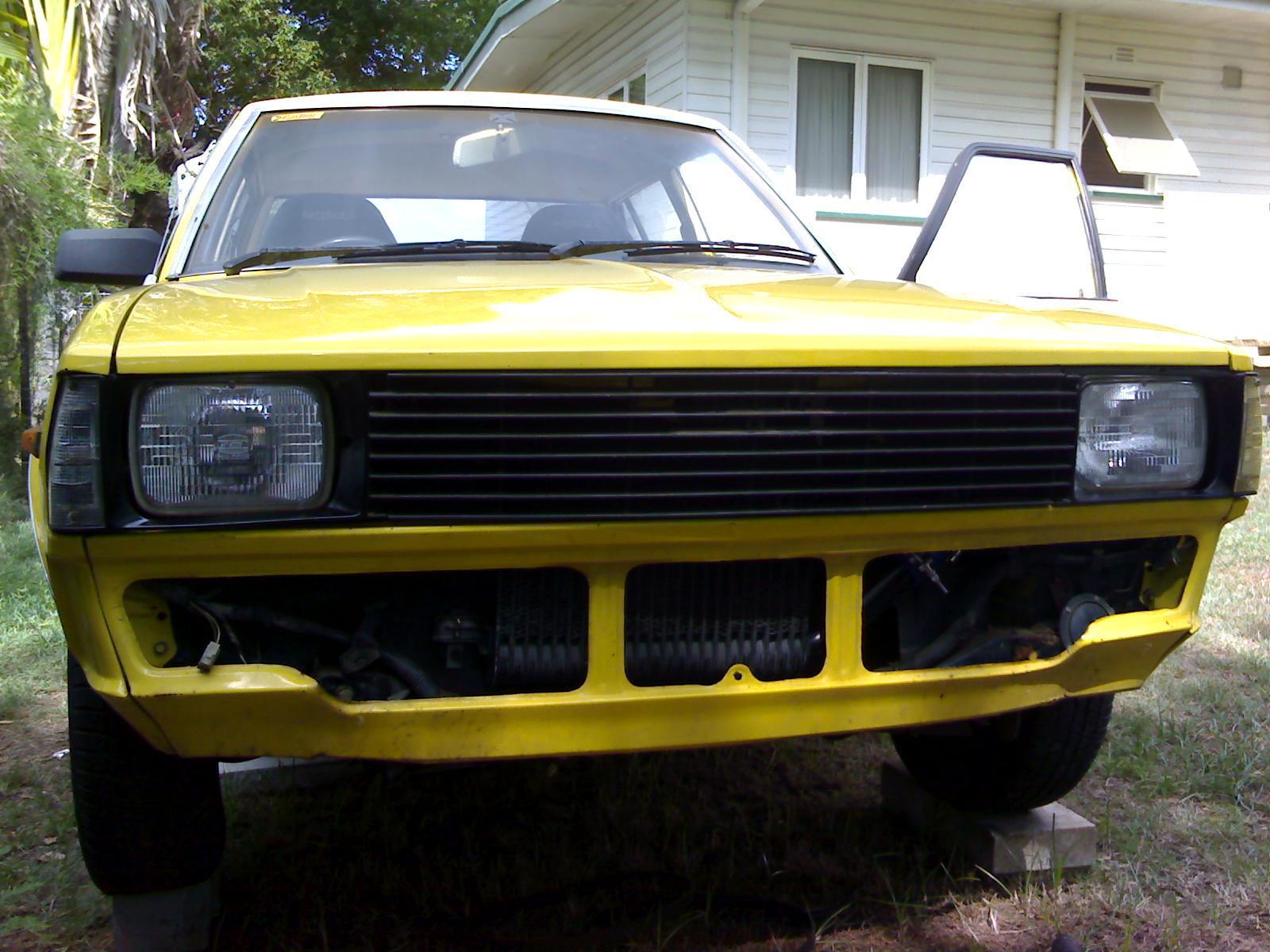

I will get pics when i put FMIC in the AE71, Jason i don't think you quite know what I'm talkin bout with the air-dam as the stone tray is what sits just below the front bumper so its not after the intercooler.

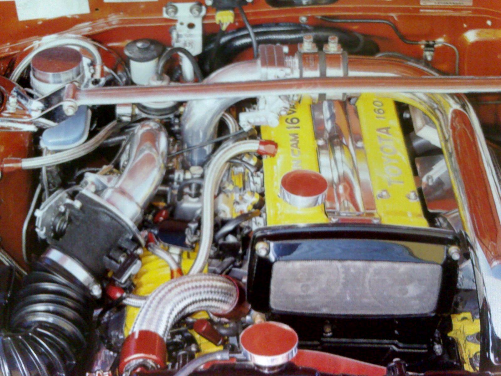

Yes i read that in ancullens ke55 thread i think, I have a zoom magazine here with ae86 with a 4agze in it and it runs 2 throttle bodies. From what i can see in the picture that it has one just after the air filter and the other after the supercharger closest to the engine induction, It also says that it was hunting for idle and the 2nd throttle body solved that. It also has 137rwkw which isnt bad with the sc12 :lolcry:

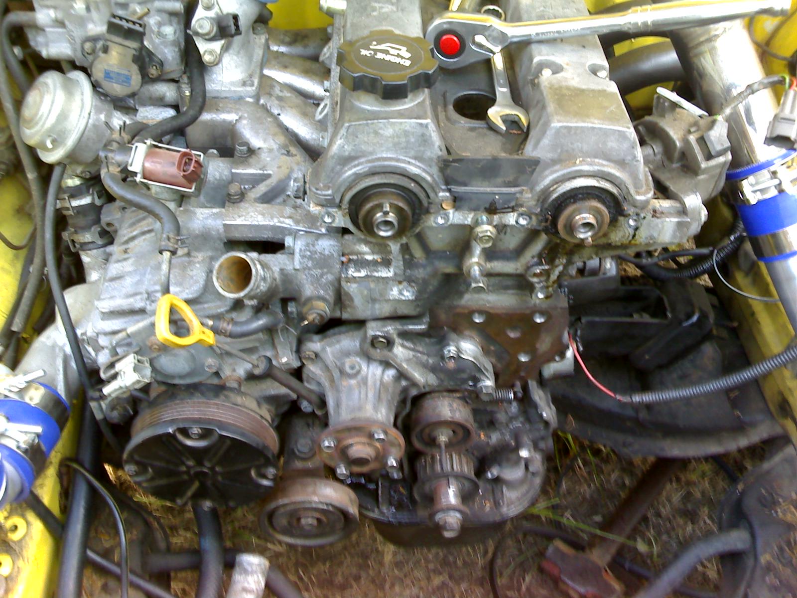

Spent a few hours today finishing the cooling system and cleaning up the water pumps etc, I'm also halfway through changing the timing belt and it still had the genuine Toyota belt in place but in great condition :P .

How would you set up throttle linkages for a twin throttle body setup like that though?
Edited by Corolla_Kid
It would be too hard to get them in the line, It sayd in the mag that they work from a common throttle cable.

setting up twin TB's is realitivly easy. You need a cable splitter, much like the ones you find on those 360o turn handle bars. Then its just a matter of getting the right lengths. Ill be doing this down the track.
