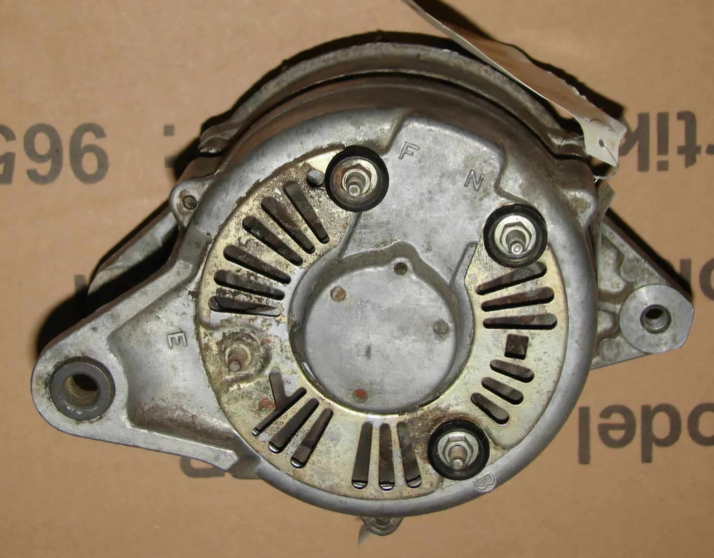

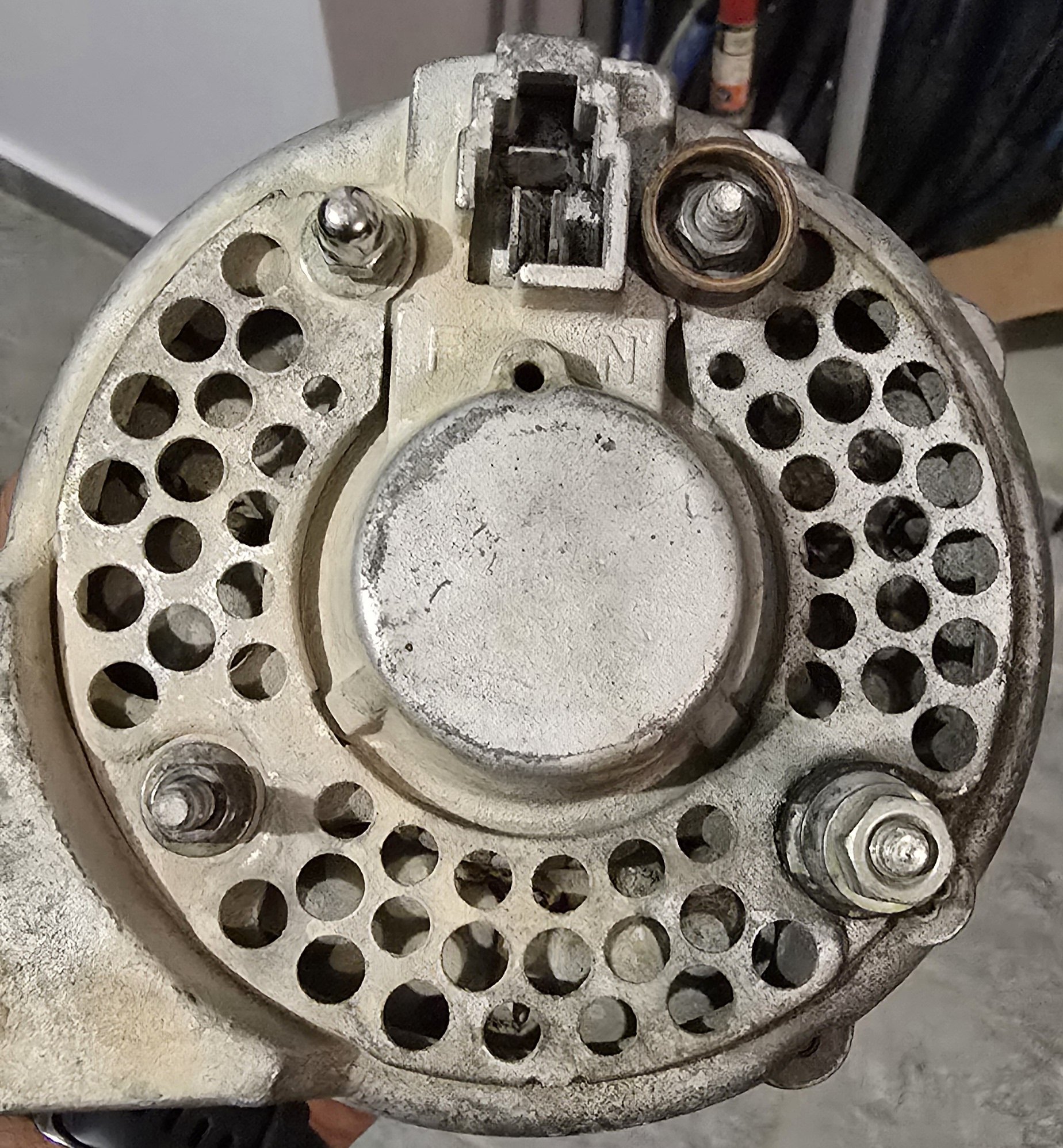

  5. Hey Banjo thanks for the reply, The main issue I have is that I don't know how to do the wiring with the new alternator. I have been having some issues with my old one which is a 30A that came originaly with the 2K engine. So, I found this used 40A, took it to a pro and had it tested and also had the brushes changed, just in case. Now, I have no idea how to do the connections.
  6. I know its simple but I couldn't find any info online. The first one is from my 2K engine and the second is an "upgade" from a 4K. Which wire goes where? The old alternator was with a 3 pine fuse and one lose wire connected on "B" screw while the new is just with the 4 screws. Help please.
