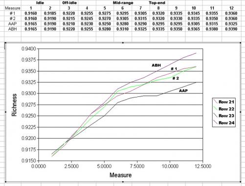

When we got the inch & 1/4 SUs the needles were too lean for the motor. They were size AAP, of the 300plus needles SU carbs can have, so I bought a pair of richer ABH needles from SU Midel in Sydney. These have been running around town at 10.3L/100km, and are nearly always showing rich on the oxy sensors (except at idle of course!) and if I leaned them out the idle was too lean. So I sat down and sanded the AAP needles thinner with some #400 wet 'n dry and a vernier caliper. I went down to Sydney & back yesterday, over the Blue Mountains (Bells Line of Road in the wet, both ways!) and through the hills, and at 100kph it did 525km at 7.1L/100km. Its only on the really steep bits on Bells that it is a pain now, where you need third gear, as the gap from 4th down to 3rd is too great, about 1000rpm. It hauls up most hills at 100 in 5th or 4th. The needle data ends up like this- I subtracted the diameters from 1.000 just so the graph looks the right way up, but these are all in thousands of an inch, and 10thou either way doesn't matter. All the needles atart off about the same size at idle, and get richer at varying rates. The difference between AAP and ABH got out to 50thou, and I just wanted the modified needles in between. So, who else has got SUs and wonders about power or fuel consumption?

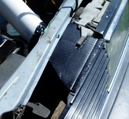

With the grille on it vanishes. Now to see if it stands up to the rain and snow we get! A test run next week out to West Wyalong if its not raining.

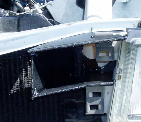

A spray with some black anti-rust epoxy coloured it, and I know my cardboard won't rust now! :laff: A couple of screws & a spot of hotglue held it in. It looks funny from this angle, but that's the way to fit it in.

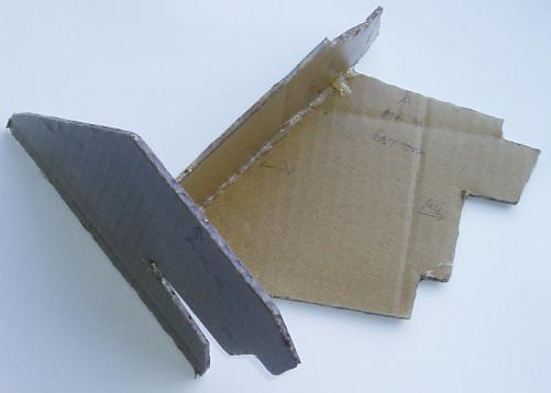

I hit it with a hotglue gun to join two panels and used it to seal all the ends of the corrugations, then I sprayed it with a couple of coats of CRC urethane sea;er. It came up nice and hard.

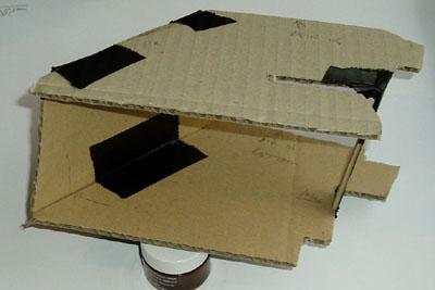

Next up was The Cardboard Air Intake! I put up a post asking about working in cardboard, as it was the easiest thing to make a model with. Usually I'd go cut it out of steel or alloy and rivet it up, but this time I figured I'd go for the modern composite style! This is what I needed to fit behind the grille-

Dave, its an air scoop to sit behind the grille, tucked up against the passenger's headlight, and takes air to the cold air tube beside the radiator. Its just going to pull air from the more the middle of the grille as the cold air tube is occluded by the headlight, especially when the wind blows from the passenger's side. Car design is so full of tiny subtletiess!! :laff: I think I'll get an aerosol can of clear urethane and spray a few coats on, and see how strong it turns up. Also sanding down the 'lean' SU needles as the 'rich' pair are running at 10L/100km around town. I need a needle profile between the two.

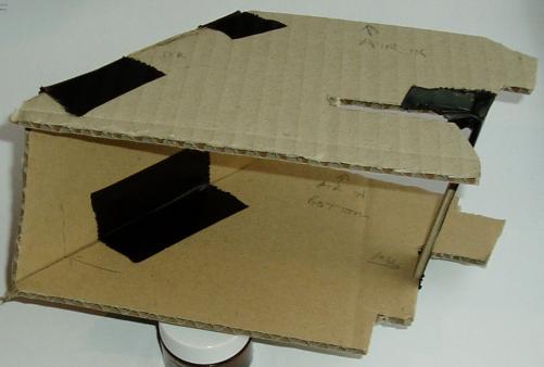

OK, I'm working on making a scoop for the cold air intake on the KE70, as I noticed it runs rich or lean on a long trip depending on the wind direction! This is becasue the headlight shields the cold air intake tube beside the radiator. So I have a model made up out of cardboard, and thought.. why go to all the trouble of making it up in sheet steel when I can cover the cardboard with something and harden it enough to keep its shape and be weatherpoof! Any ideas? Anyone done something like this? Fibreglass epoxy resin? Clear urethane floor 'varnish'?? 5 coats of enamel?? :hmm:
