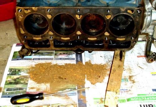

Yeah- when you back-flushed the rad how quickly did water flow out?? It should pour out faster than it comes out the hose! :laff: Any pieces of crap in the water system sit on top of the radiator core channels and block them, and once they harden up with a bit of oil and rust they are very hard to remove. What does it look like when you look in the top with no water?? Any blocked?? On my old Armstrong Siddeley I had them remove the lower tank and I poked welding wire up every core to solve the same symptoms you have, the motor got hot but the rad stayed cold because the channels were blocked over. It must be either pump has no impellor or the rad can't flow water. -

You're better to hose the block out when you take the water pump off I think. The bigger the hole and the more flow you can get the better, but it still won't move the rust. I used a srewdriver and wire on the block when I had it out. It certainly sounds like the thermostat has jammed shut. -
