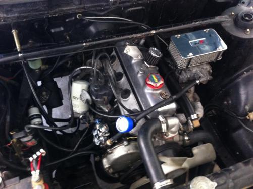

  18. Repacked the rear springs yesterday using the second set I picked up. Added two extra leaves. So it's now a six pack. The back end came up about 20mm but she's nice and firm. Turns out the drivers side axle is bent so I'll need to get another bearing and swapped that out. I redid the fuel lines under the hood. Holley reg, Aeroflow gauge fitting and Speco pressure gauge. I went to the Beaudesert swap this morning and picked up a ke20 drivers door mirror for 25$. Completely random box of mirrors and what do you know!
